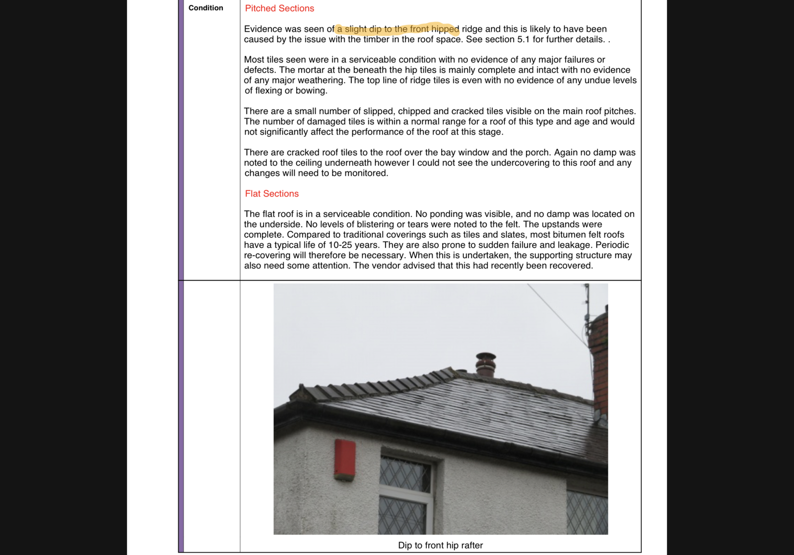

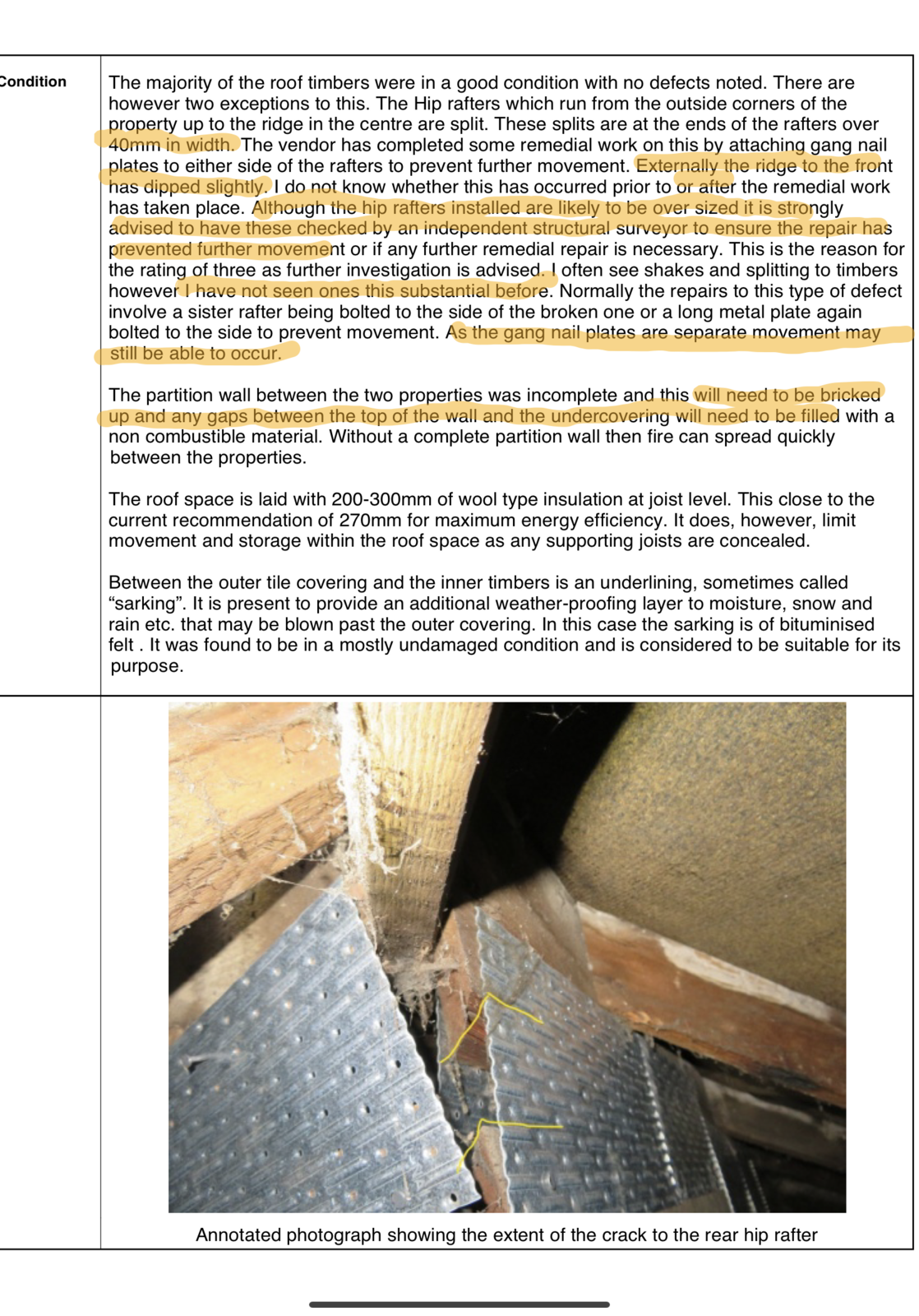

Our surveyor found both hip ridge rafters split with 40mm splits and he said he hasn’t seen a split that bad or two at once and hasn’t seen this kind of repair to such significant damage.
Other comments on here suggest sistering the rafters too which is what he said should have been done. Would this be a dealbreaker or can it just be re-repaired properly?
what could cause both to split, there has been an extension built and removed, no other sign of subsidence noted on report but should I worry structurally?

photos attached.
