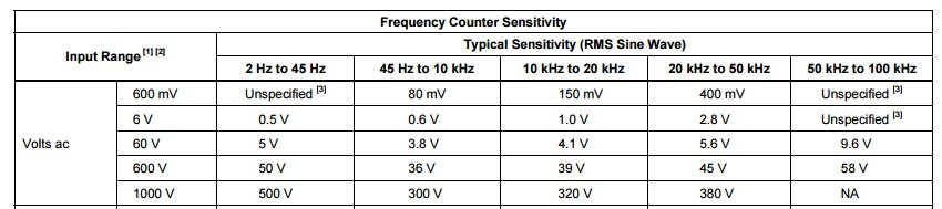

I have several 'scopes, and that would certainly be an option. Even simpler would be a capacitor and resistor of suitable values, plus a multimeter. I don't get there that often since it's a significant and tedious journey (in hours, not miles, since most of London is in the way!), but will certainly go appropriately equipped next time.

For what it's worth, my multimeter on its AC range showed about 12.4V. Your logic might say that that indicated that it was 50Hz, but I really don't believe that. There spec of cheapo multimeters often says little/nothing about frequency, but the more up-market ones do. Fluke multimeters only specify the voltage measurement accuracy remaining unchanged (at about 1%) up to 1kHz, and say nothing about accuracy beyond that frequency. However, this bit about frequency measurement on various AC voltage ranges seems to indicate that they can make at least a stab at measuring voltage (with whatever accuracy) up to 50-100 kHz ...
