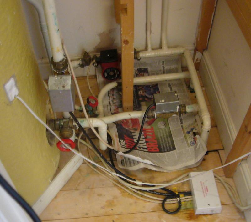

Only had new pump fitted a couple of years ago. I've turned setting up to max 3 which should be plenty. It's a grunphos 15/60. I've rechecked all radiators for trapped air too.
Does one of the valves / taps near the tank affect this or is the pump wearing already ? It does sound a bit louder than it used to.
id guess a restricted/blocked cold feed. could also check its not air-locked and there is water in the f & e tank
Thanks Gaz man. There is water in the header tank ( F&E tank presumably). Not sure how to check for blocked cold feed.
I'm going to turn off all the radiators both sides, and then run the CH and turn them on one by one from the furthest away, to see if that clears any air locks. Can't hurt anyway.

Is it me, or does the floor look wet by the wiring connection? Why the newspaper? Is there a leak from a joint on the cylinder running down the electrical wiring? :roll: :roll: :roll:
should that twin box with the blank on really be mounted on the floor like that in a water area?? i'd have it mounted up on the wall, and all cables from 'wet' items going up to it
it's more like an oil mark. My wife had loads of spare shampoo bottles, cleaning liquids etc and something probably did leak a bit but not sufficient to cause a problem. I had a look at the box before, but the wiring comes straight up underneath through the floorboard.
Where the potterton ptt2 is situated isn't clever either as the wire to the sensor hangs across.
I've ordered a new one as I'm sure that has faulty/ worn connections.

First post on here, after being brought here by a google search for something totally different, and clicking a link....
To me, it looks like your pump is on backwards.
If you look at the arrow on the top, at the rear, it will be pointing from left to right.
Should it not be pointing Right to Left?
The flow then, will be pushed to the 2 port valves and around your system the correct way. If it is wrong, you are likely sucking more air in than letting out, when you bleed your radiators, and your boiler will be overjoyed if it is turned around the correct way.
It will also explain why the decorator painted around the previous pump, because the vent screw on that one, would have been at the top.
That, along with a flush, should cure your problem.
Or..... maybe im looking at your picture wrong.
Can anybody else see that...?
