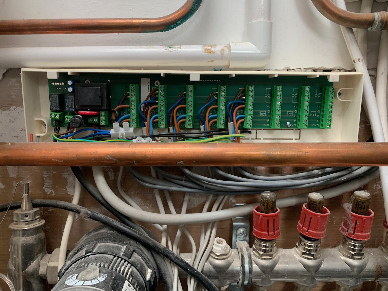

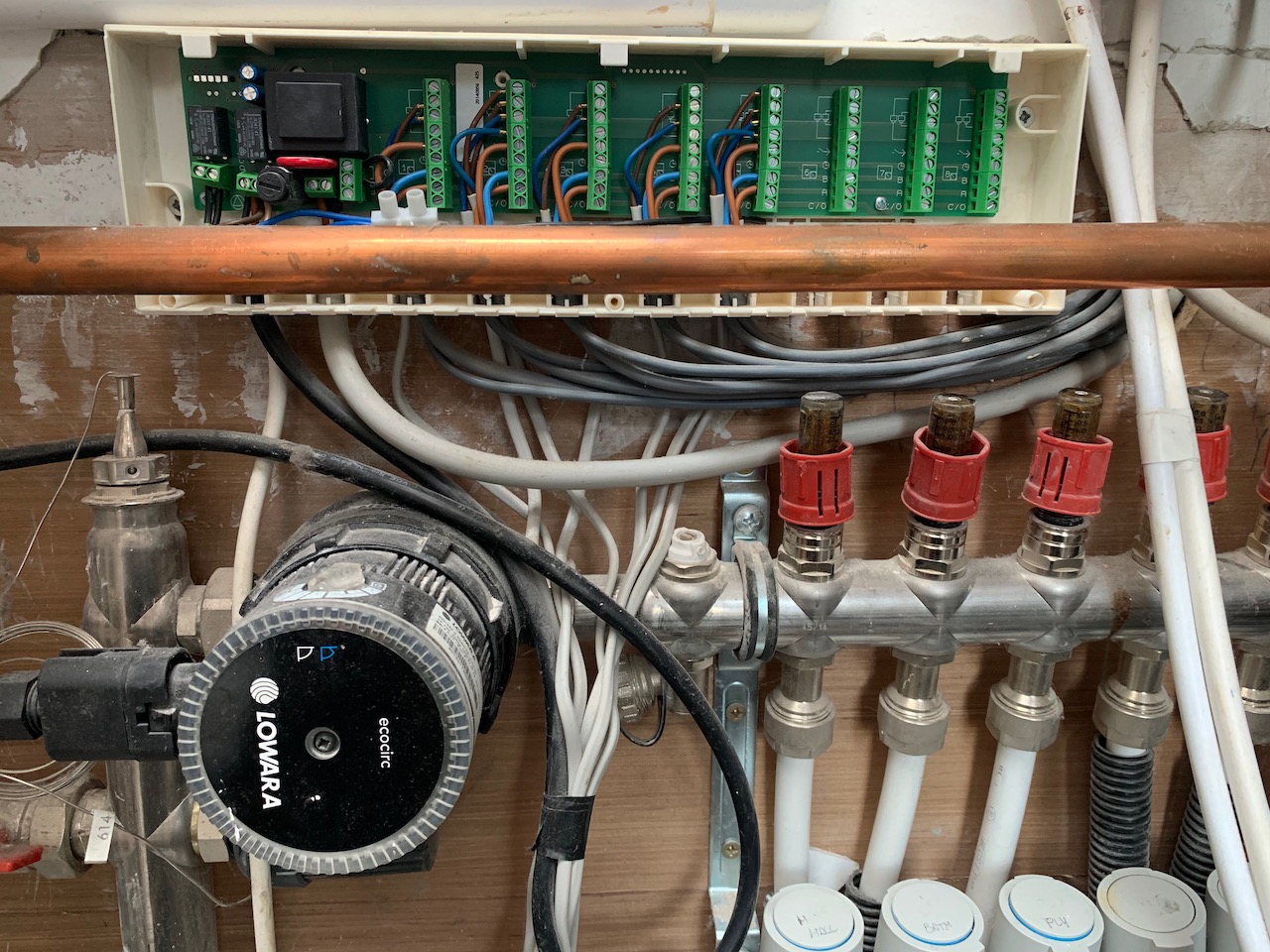

We have a gas boiler feeding an 5 zone UFH system downstairs, some radiators upstairs and the hot water cylinder. This is all controlled by an EPH timer which controls the water and a single heating zone (i.e. all the heating). The timer seems to be wired back to two different wiring centres - one (EPH model) seems to handle the upstairs heating and the hot water, and a second one (mystery manufacturer) which seems to cover the downstairs UFH. Into this wiring centre seems to be the cable to the timer, all the downstairs thermostat connections, connections to the actuators on the UFH manifold, and the UFH pump and valve.

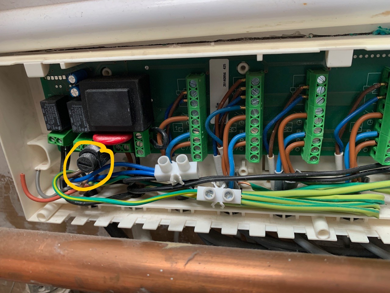

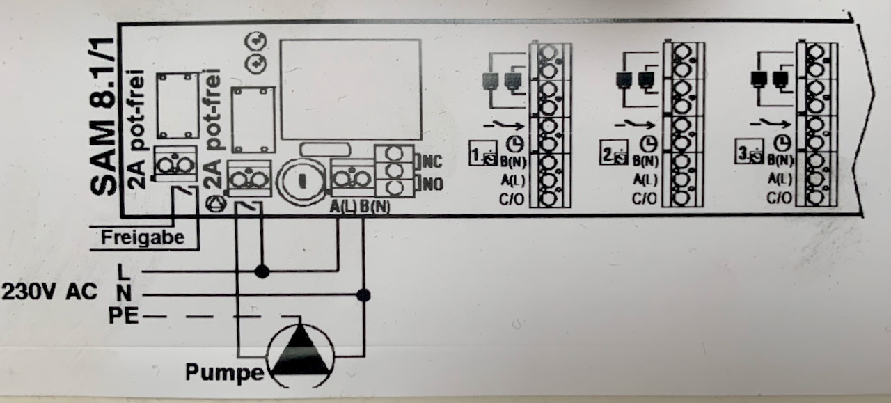

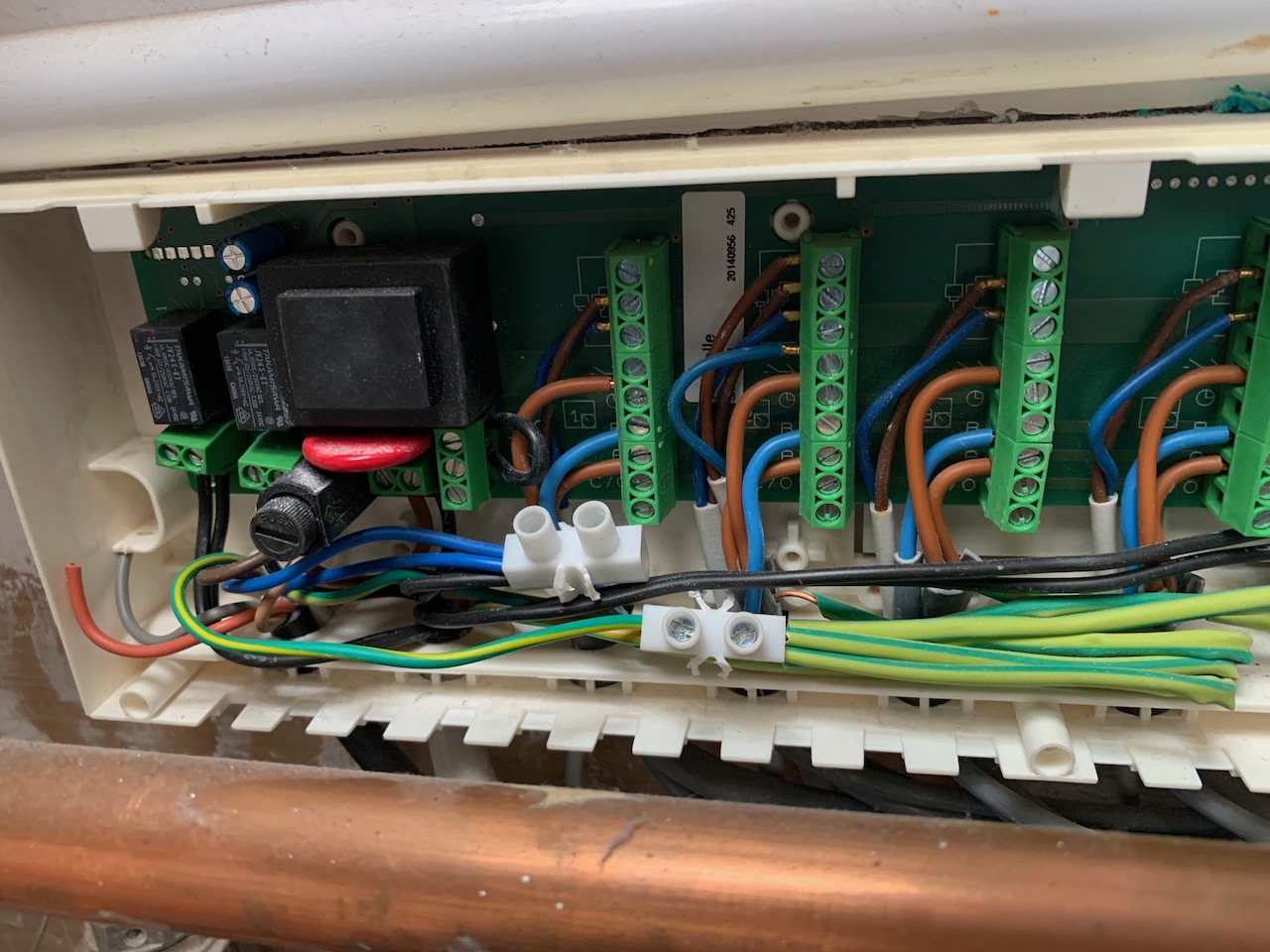

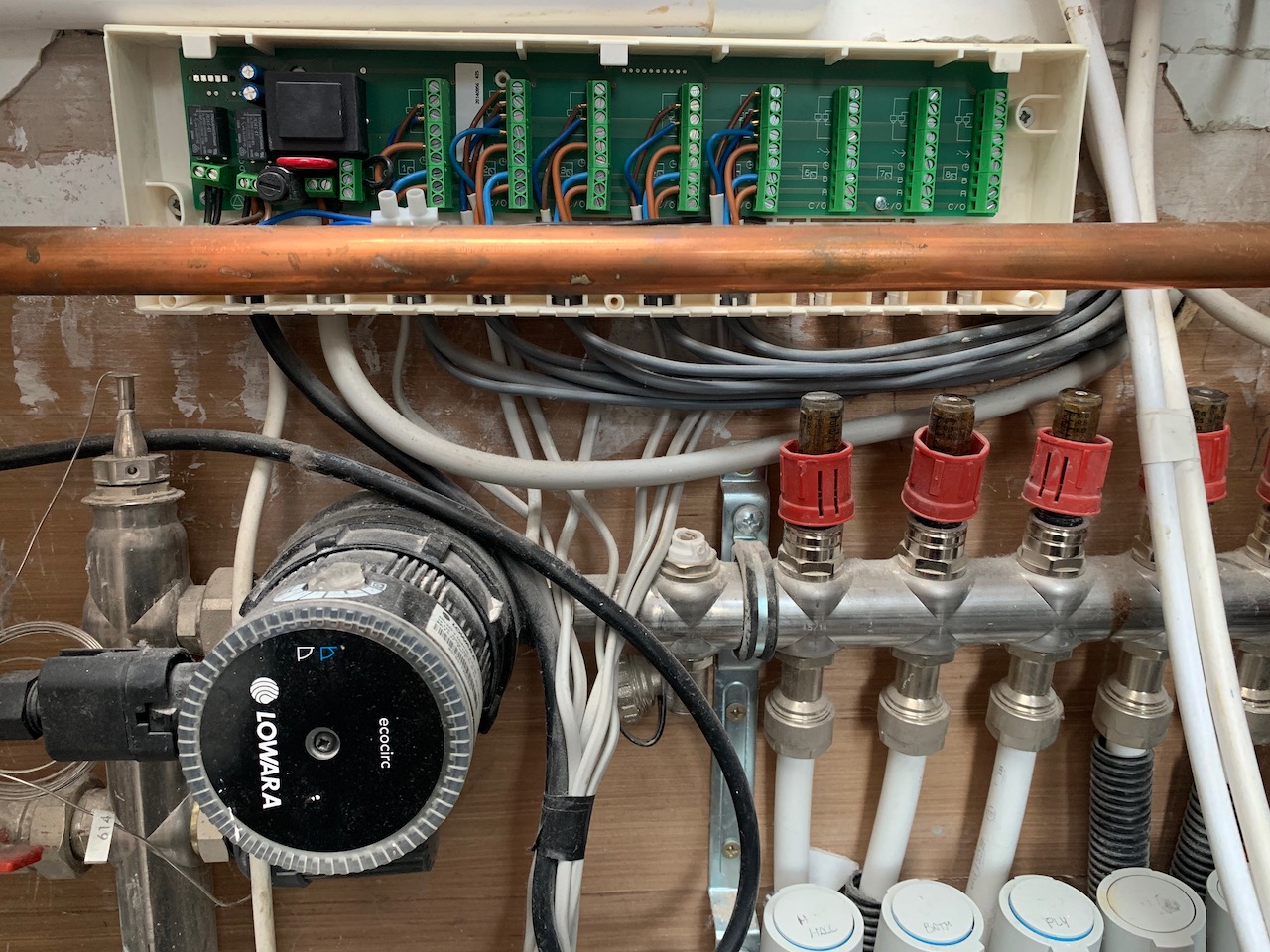

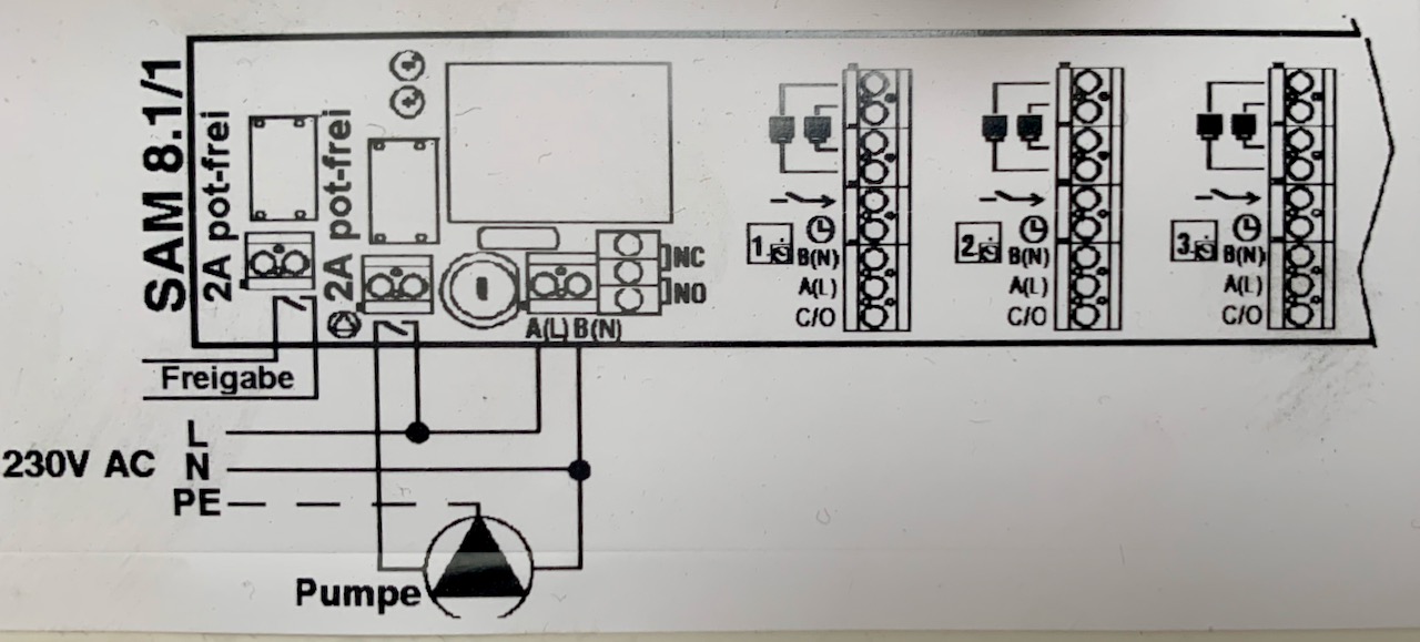

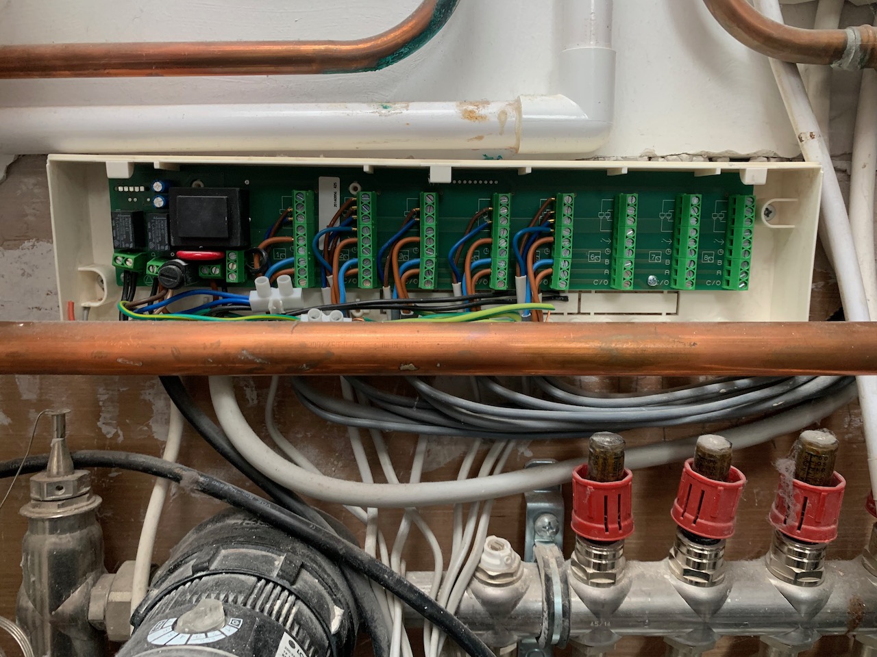

I can't help but think that something has somehow blown in the second wiring centre. It's a mystery model - the only thing that looks like a model number is 'SAM 8.1/1' and some of the text looks to be German. It's more than a basic set of connector blocks, with 2 relays, some capacitors, a small traffo, a push-in-twisty knob (potentiometer?) in addition to all the connectors; but it has nothing that looks like a fuse.
If I knew who made it I could get try to some data on it and try to understand more about what it's doing. I'll try to post some pictures of this mystery wiring centre
So I'd be very grateful if anyone could advise, or even any tips on how to get more info on the wiring centre. Finally, is it a safe assumption that the EPH timer is not the problem given that the upstairs heating is ok, running from the timer's single heating zone?
And finally - if I do end up needing to call in a pro (likely) - is this a plumber or electrician?
