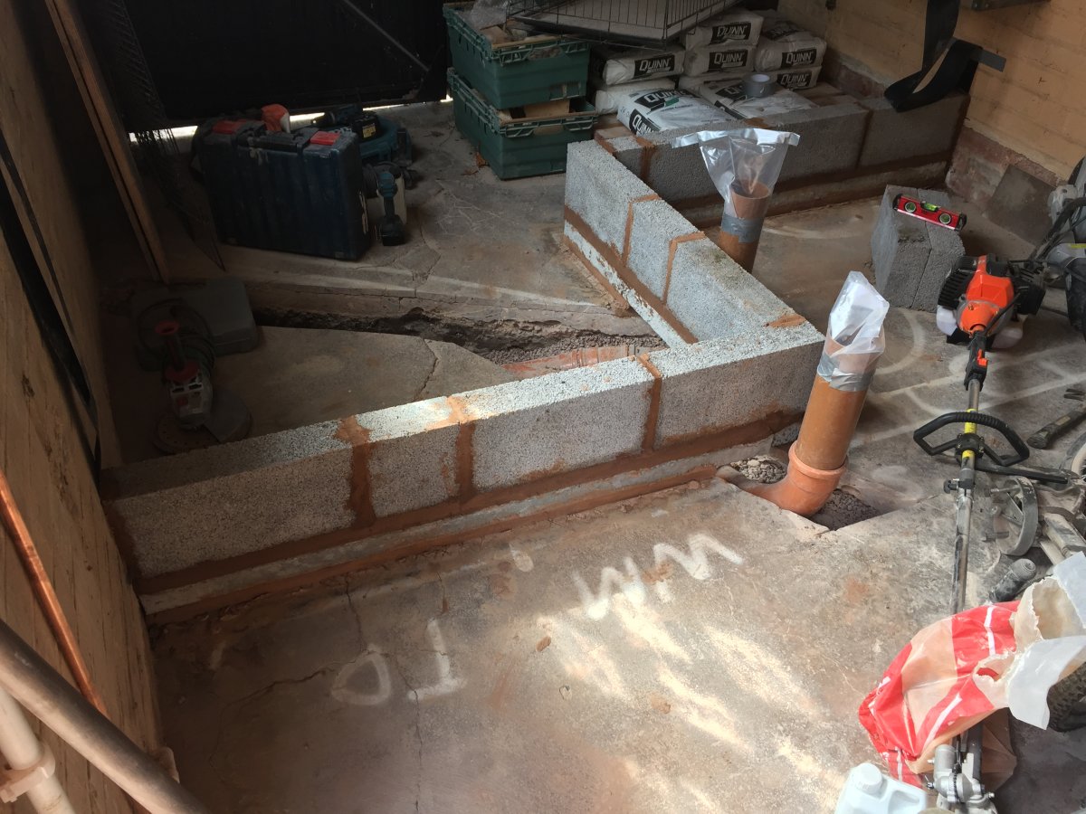

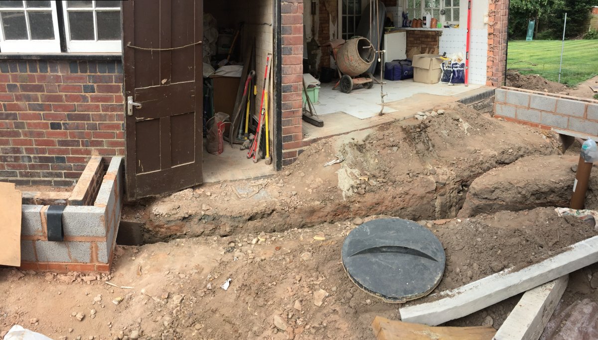

I shall explain - It's a side kitchen extension that also goes into the garage via a doorway as a utility room (I have removed door and lining). The floor level of the house is 380mm above ground. The garage floor is 350mm below the house floor. I intend to pour a continuous slab for the extension and utility floor, thus passing through the side garage doorway.... that I have removed

I assume you'll have a dpm in the garage floor, and it's the side garage door that you are trying to put the DPM in. If it is, then run the dmp down around and under the door lining.

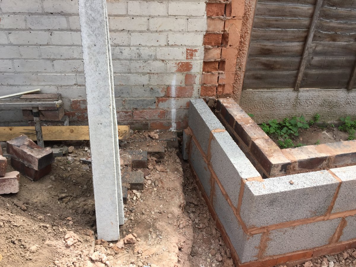

IMG_5688.JPG IMG_5687.JPG IMG_5689.JPG Here is the pics requested. Bit of distortion as I did a pano to get it all in.
I'm built to DPC. Current kitchen floor is FFL. Current DPC of house is 1 brick below. I'll be connecting it into my new higher DPC. Garage DPC is several bricks lower due to the lower floor level. In the garage I've built a small single block wall to new DPC level which I'll stud wall off. The whole new area will get MOT, blinding, DPM, insulation, concrete slab then a thin final finish of SLC at the end to get levels spot on and match floor level of house.
Think I've got a handle on the corners. I know to lap DPM onto my DPC..... what about where it meets the old kitchen floor? Just cut it off level with the floor? Same for the original opposite wall already in place?

I assume by FFL, you mean finished floor level, then no, it's set below that to allow the joists etc if you had them to be protected. In your case, you're having a concrete floor that'll have a DPM in it, so where is the wall DPM going to be in relationship to the slab DPM. Sometimes, you get round it by taking the slab DPM up the walls, but you've got different levels there, so that's why you need someone better than me to help you.
The slab DPM is lapped up the wall and onto the wall DPC. All well and good for the new wall. Not sure how this relates to the old walls.

Just take it into the garage with a healthy over lap on the extension dpm, lap it up the walls in there up to dpc level.
The join between your kitchen and new floor could be tricky I think I'd remove the course of bricks and then tie into the dpc with the extension dpm.

The old existing kitchen is nearing 100 years old - so I can safely assume there is no DPM or insulation. Beneath the 1980's floor tiles are quarry tiles - they are not damp and the 80's tiles are stuck hard. Am I a bad person if I say digging up the existing kitchen floor fills me with dread if there seems to be no problem?
I like your idea of removing the current top course of bricks to tie in the extension DPM with the house DPC in the kitchen area. Would you brick back up or just let the concrete slab run over it?
