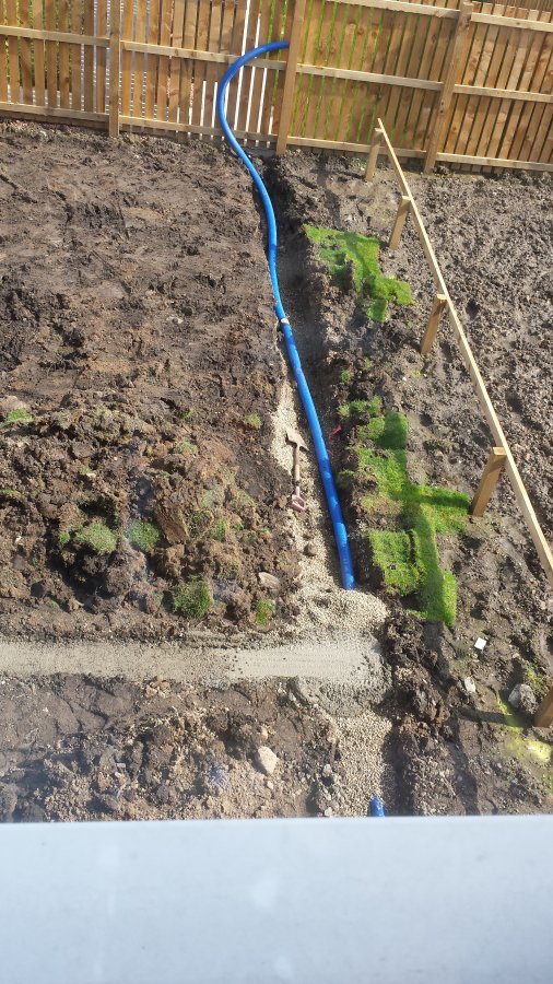

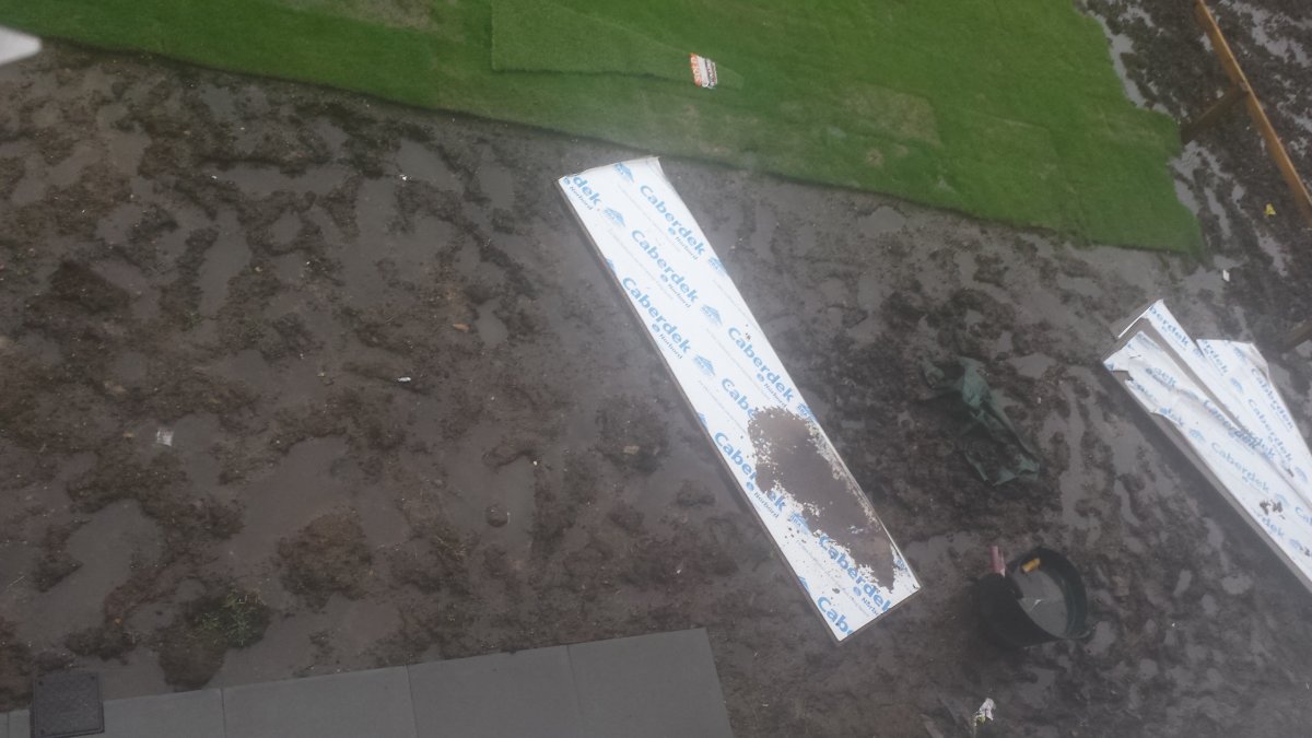

We moved in to a new build built by persimmon. The soil is full of clay and most of the gardens newly laid turf died because of drainage problems. Our back was really bad and and are in the middle of a slope and the water gathers from all the gardens into ours. It was a bloody nightmare.

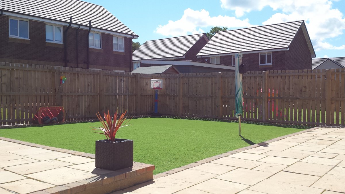

We got artificial grass and raised the level and put in a drain along the length of the garden where the water would sit. It's connected to the main drain and it seems to have worked as I've not seen any water pooling up.
They put type 1 down and flattened it and then a black sandy looking mixture over it and smoothed it out. It's worked a treat and it's it's still nice and even.
Thanks. We've been avoiding the garden in the wet for years but just finished an extension which has left the place like a mud bath. And now we have a dog too who likes to bring in as much mud as possible!
