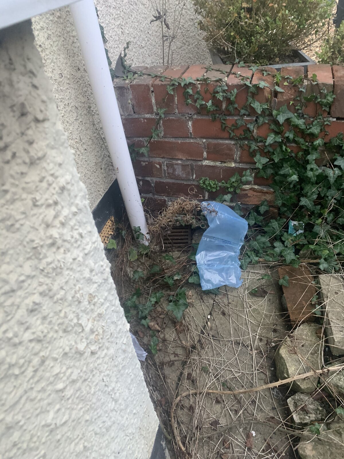

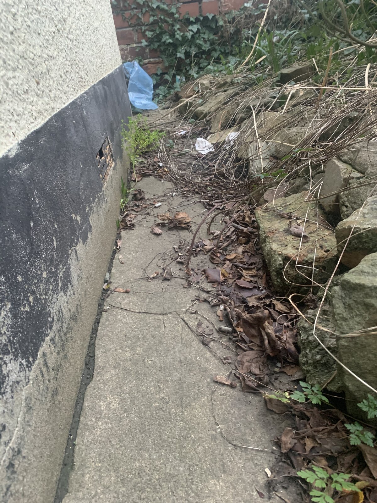

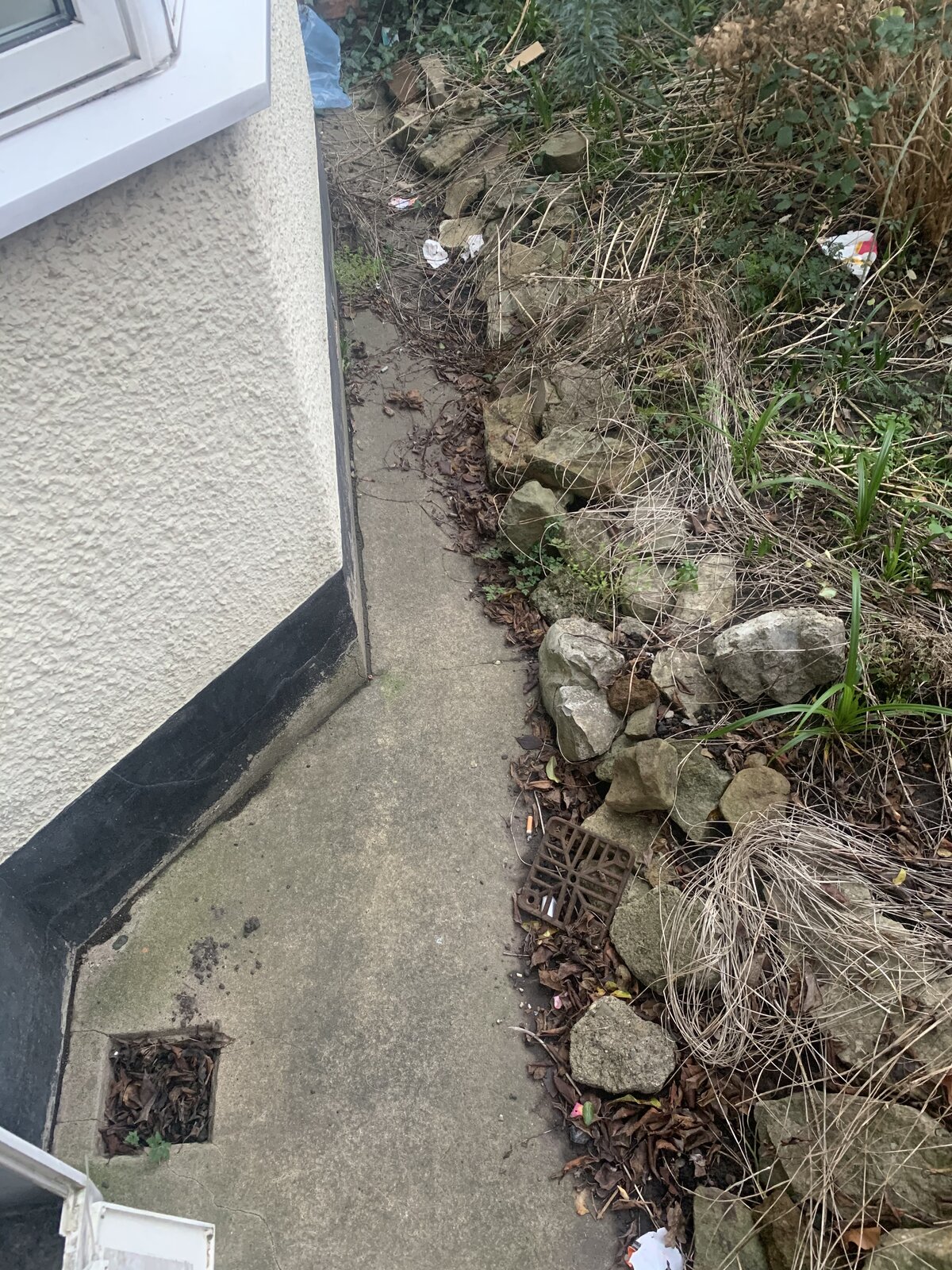

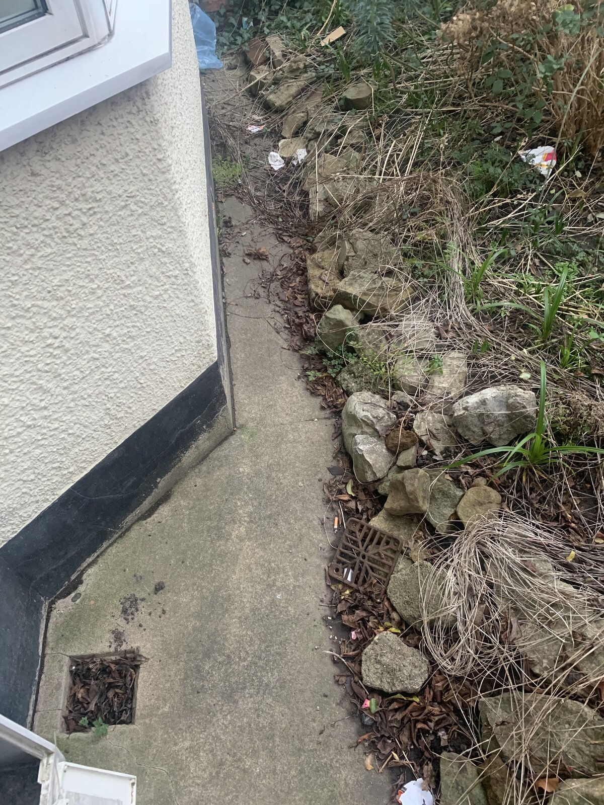

It hasn’t cracked but I think I’ve figured it out. I’ve uploaded some pics so it hopefully makes more sense.
I pic pics of both drains. The one in the corner works for all I know as the guttering goes down to it and never seen that drain are flooded.
however, you should clearly see the blocked one. Water has never really got to it because it’s higher than that concrete under the bay window.
it looks to me that the concrete has started to slope AWAY from the house and it goes downhill (hopefully you can see this)
I think this is because they put a rockery and there’s mud from the garden pushing down on it, so it’s making it tilt backwards and away from the house and drain....do you think that’s plausible?
basically a large puddle forms there as it never gets to the drains which are a good 4-6 inches higher than that concrete run between the drains under the window.
there is a crack where the concrete meets the wall, but apart from needing a bit of TLC the wall seems straight as a die.
So ideally I want to get rid of that soil, resurface pour that path and ensure both drains work and all the water can get directed there.
we have personal lines to the sewer and mine is out the back. I have a combined surface and sewage one under the manhole.
I always assumed surface water from the front would run and join the gulley out the back at some point . Are you saying it might just drain into the soil under the house. I always assumed that would just encourage subsidence!

I'd suspect the blocked gulley is just full of debris that's washed in over the years, and no-one has ever bothered to clean it out. Concrete, could have been badly laid in the first place, if there's not a suitable base underneath, it wont last long. Break it all out, use the rubble as a base and redo it. May even be a soakaway under there somewhere for the rainwater, it's clearly working if there is! Very unlikely it goes under the house to drain, I'm 99.9% sure it would drain away from the building somewhere.
Otherwise you may have a storm drain running under there somewhere, they could be a bit miserly with manholes on storm runs back in the day, so dont rule that out either. Very unlikely they'll have run a storm drain under the building to be honest, at that time the preference was for everything to be external. Only exception would have been the short run from a ground floor WC to outside the building footprint.
Quite possible the rear goes into a combined system, then a separate storm drain takes the water from the front and possibly the road gullies as well.
