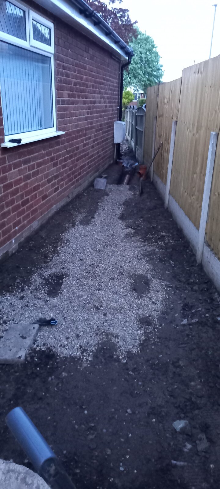

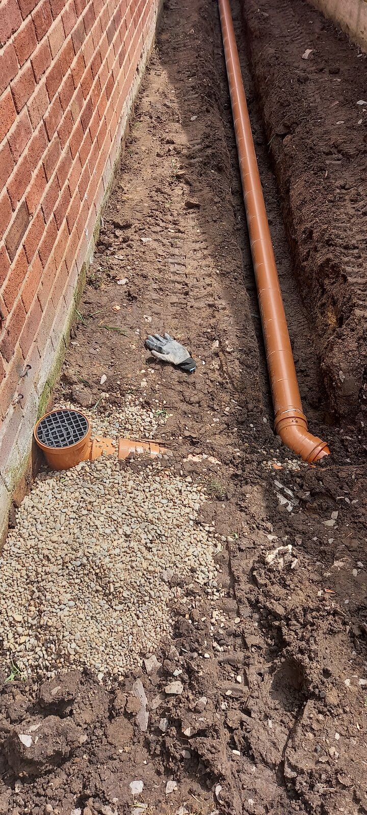

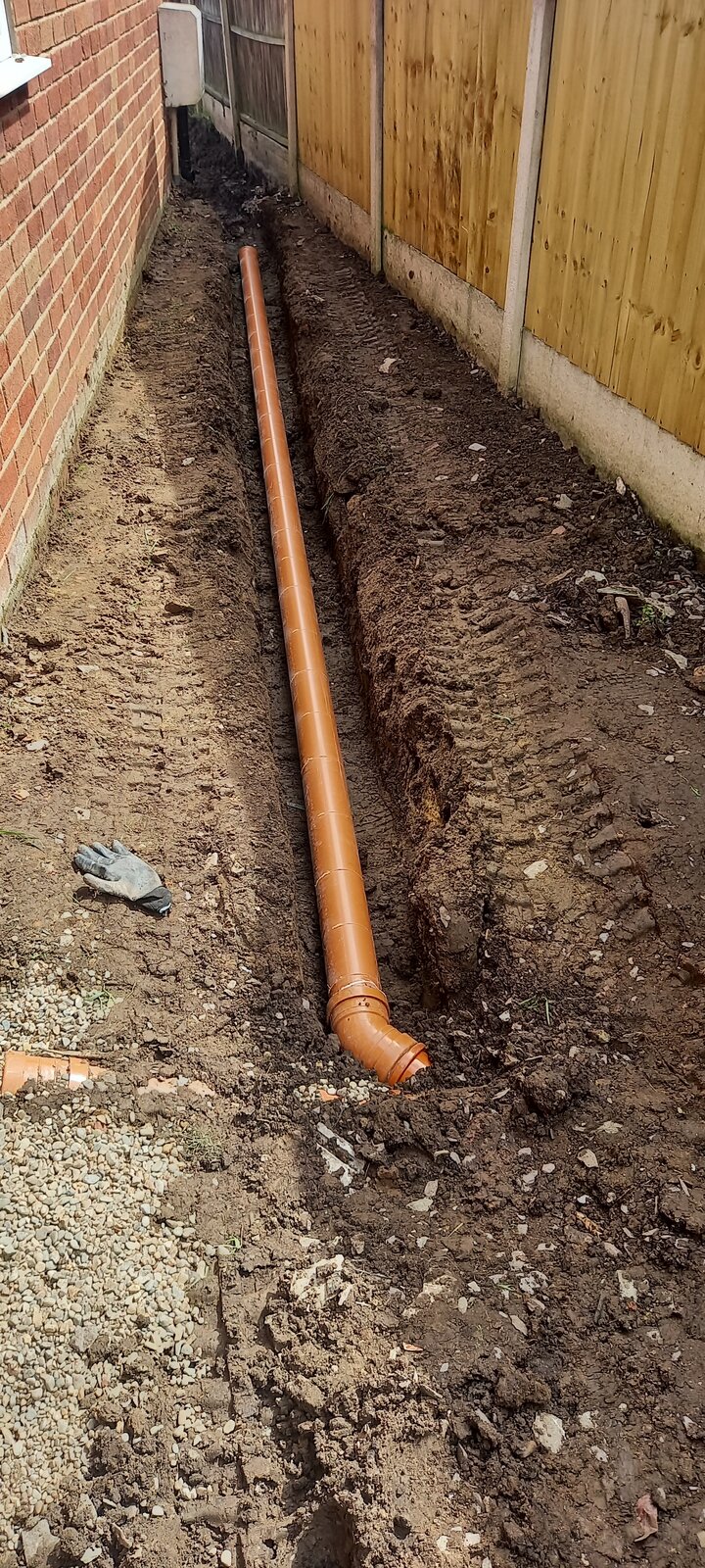

Hello,
I've had this drainage pipe installed down the side of my house to remove excess surface water from front garden to rear garden area where it drains much better. The pipe has some perforations in the top half to also collect water from down the side which would get some pooling in rainy conditions. The bottom of the trench is probably 6 bricks below dpc at the point nearest on the photo, going up to about 4 bricks below further away. The trench was filled with pea gravel, membrane over the top, and finished in a few inches of gravel, the top of which finishes 2-3 bricks below dpc from one end to the other. The trench will get water in it when it rains although the pipe will carry some of that away if it fills up...
Is any of this likely to be a problem for the house, foundations etc, given position and depth? House is 1961 bungalow.

I gather the assumption is that the footings are likely to be another few courses further down below the bottom of the trench? I think at its lowest point the trench is about 6 bricks below dpc.
What about the trench having surface water sat in it from time to time as a result of rain, and being more concentrated than if it had just fallen across a flat soil surface? Would this make any odds? Also, I don't know if this technically makes the trench a soakaway in that case and those should be further from dwellings... but that is presumably for other reasons?
Make no difference what so ever. All the masonry below ground, including the foundation concrete is permanently wet. No dramas. The most vulnerable masonry is at (or just above) ground level, regards any structure, but for different reasons.
