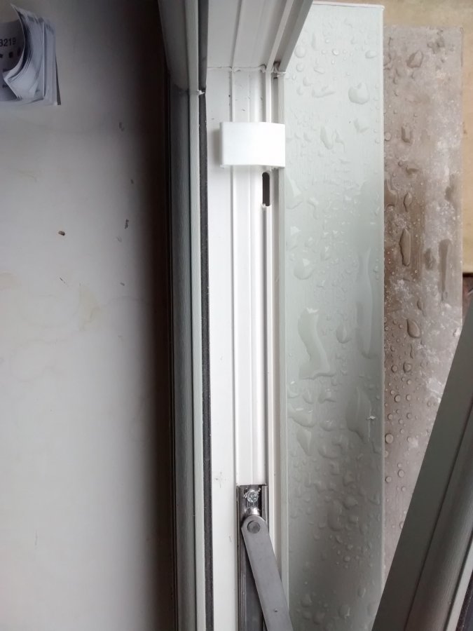

First one shows the inside of the casement: one black headed screw (the one visible in the gap in my original photo was bright finish).

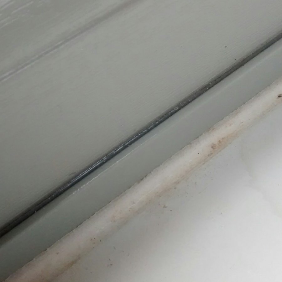

Second photo is the casement on the other side of the doors (no screws). I've checked the casements in the other room of the extension, which have a couple of screws inside each casement.

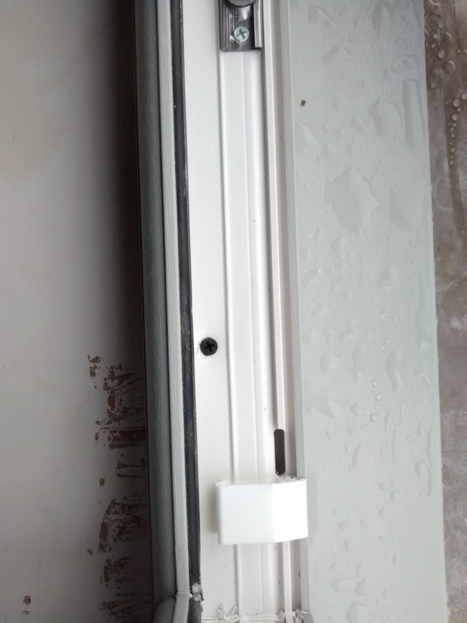

Third photo shows the sealing at the lower edge against the internal sill.
Draughts seem to be much improved (I can just feel very, very gentle air movement in a couple of places) However, the internal sills feel cold to me, compared to wooden sills around 20+ year old double glazing in the rest of the house, so I guess I still have a concern about whether the installation has been isolated correctly from the outside. Builder is referring me to the manufacturer, so I may go down that route to get another opinion.
