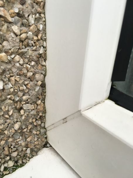

The cement (whatever it is) dashing finish on the outside was a little cracked as it met the window. This is the case on both sides (& has wet patches both sides).
The guys who did the work ran some silicone down to see if this would fix. Told us to keep our eye on it to see if it comes back.
Well under a bit of rain today - it did.
This is the outside (but NOTE: this is an old photo & the phone cable running inside has since been removed, before all this work was carried out).
and like i said - the same applies to the opposite end, which also has small cracks.
What would be the fix here?
I would say that surely the entire face of the house does not need taking back to brick & then re-dashing.
But what would (should) they do? How much should they chip off & re-cement?

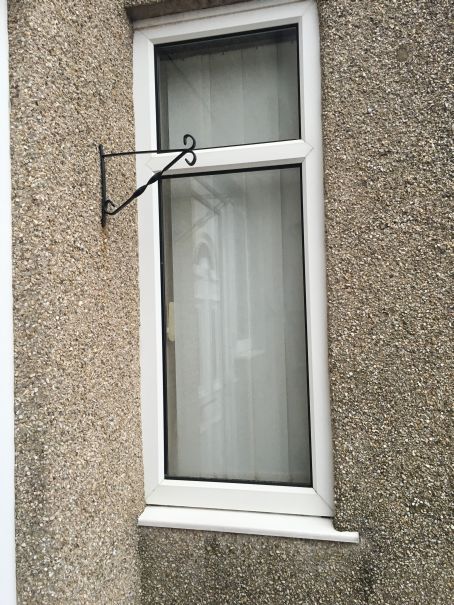

So since i got some daylight... (i will upload pics as thumbnails (so you'll have to click them) since there's going to be quite a few)
^^ That is the main living room window. The worst corner is the far corner as you look at it (near the down pipe) although the near corner also has damp coming through.

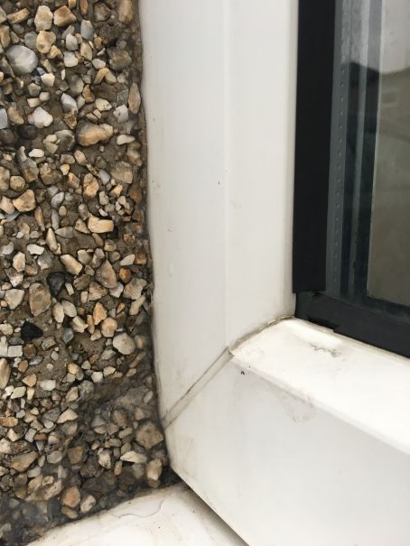

^^ That is a close up of the 'better' (near) corner. You may be able to make out a little bit of the silicone as the dashing meets the PVC.

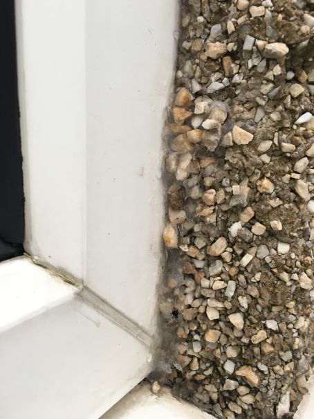

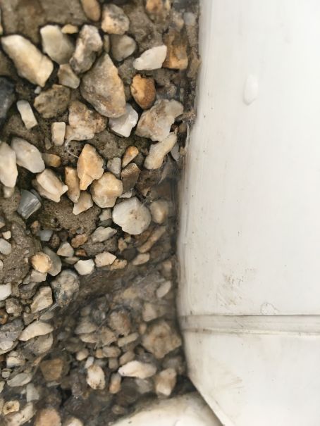

^^ That is the worst (far) corner (the very first pic in the thread).

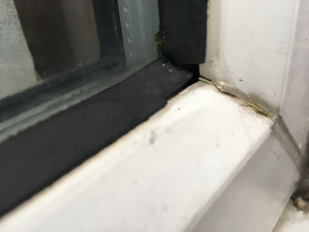

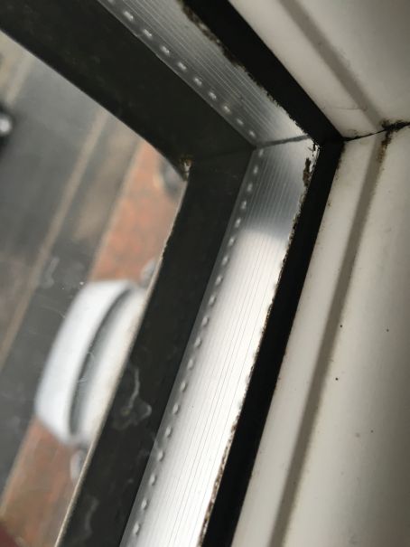

I then noticed the black rubber (seal?) where the glass meets the frame - there were gaps in the corners. Some bigger than others. I don't know if this is normal or not. Strangely the bigger gap was on the side where the damp isn't as bad.
^^ near side that isn't so bad
^^ far side that is worst. The pic doesn't show the gap too good. There is one, just not as much as the near side.
The side window to the living room also has damp issue although not as bad as the main window.
** The side window however does not have an opening **
I think it's fairly even on both sides of this one.

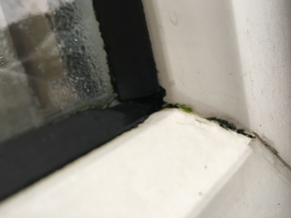

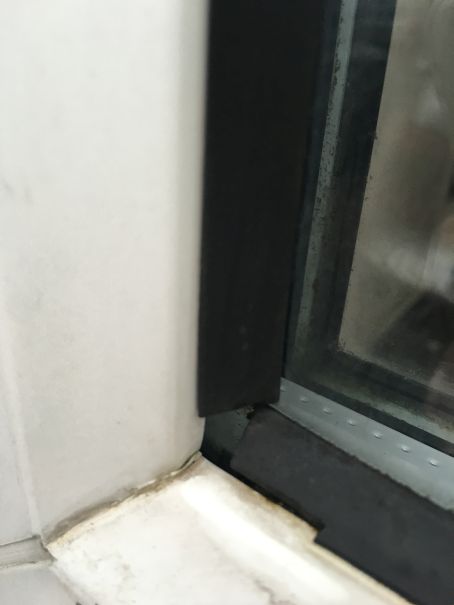

On those rubber (seals?) where the glass meets PVC though. I had a look in our bedroom & on one side there's quite a huge gap....
^^^ NOTE:::::::: Above pic & next pic is of the bedroom window. Not living room.
Interestingly the paper on that recess bit has peeled. We assumed condensation or something. Whereas the paper on the next side i'll show, hasn't....
And the (seal?) is touching there.

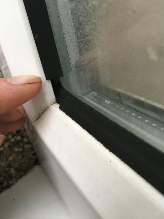

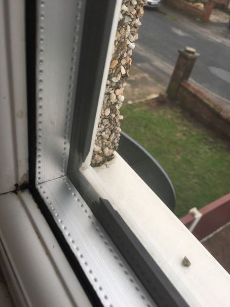

The (seal?) on the side window, i forgot to show that....
Though where my finger is, it isn't necessarily wetter on the inside i think. I think both sides are fairly equal.
So i don't know if it's this at all, or where the (render?) meets the PVC or what.
Your last pic looks like there is no sealant at all on that side, Get a tube of "low modulus, Neutral cure" clear silicone and seal it up.
Check all the bottom corners where the window meets the cill and the wall, Again in the last pic there looks to be a fairly large hole in that corner.
The gaskets are unlikely to be causing any problems but it will reduce the life span of the glass units if left like that.
Try to pull one out a bit, If it is shaped like this http://www.ebay.co.uk/itm/Sample-Pa...809405?hash=item4d08b8c83d:g:KrAAAOxyYANTa4dM
Then its called a wedge gasket, You should just be able to pull them out and stretch them a bit before putting them back.

I would say you need to seal any visible cracks at corners and even apply some sealant where gaskets aren't stretching properly all the way to corner, there are gaps and cracks from one can guess water is getting in, I hope your gutters are Ok and they are not spilling rain water over the windows, water is very strange, it can make its way in thorough small crevices that you might not think it can. A small crack sucks water in through capillary action.
Sorry yes I meant the last pic of the second group of pics that you posted (I was writing it while you posted the 3rd lot).
You don't need to worry too much about the shrunk gaskets for now, Any water that gets in there comes out of the drainage holes and over the cill. It is a separate issue and can be sorted by stretching the gaskets as I said above.
Damp corners by windows are normally one of 3 things:
1. Gaps in the external sealant. When its dry clean the frames and seal the missing bits. With a bit of luck thats all it is.
2. Who ever fitted the windows hasn't sealed the ends of the cills before placing the window on top allowing water to blow under the window and track to the ends of the cill and into the wall.
As your windows have been in for quite a while and the damp is a new issue this one is unlikely to be your cause.
3. Your house may have brick closed cavity's with vertical DPC's. The original windows were probably 90-100mm deep and spanned over the DPC then new 70mm PVC windows were fitted to the outside edge and no longer span the DPC. The 20-30mm gap in the plaster is often covered with a PVC trim and no problems but if you take the trims off and plaster to the frame the plaster will bridge the internal and external walls bypassing the DPC and tracking moisture through.
Hopefully number 1 is your problem and easily fixed, 2 or 3 would mean having to cut back the plaster to work out what is going on.

Anyway i'll have a do with the sealant myself & lay it on a bit thicker as it's currently very thin. It may not look too nice, but we're not about to sell it & nobody is going to come up admiring our windows or anything, so we shall see.
