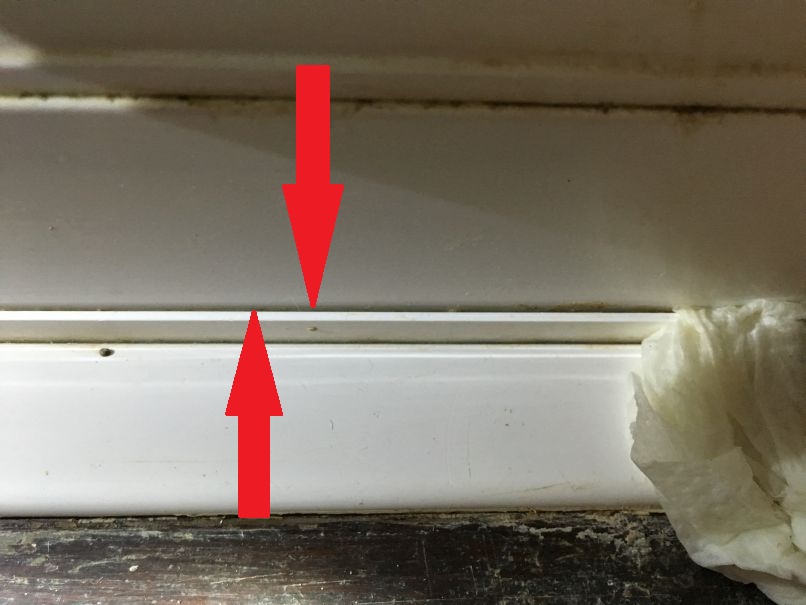

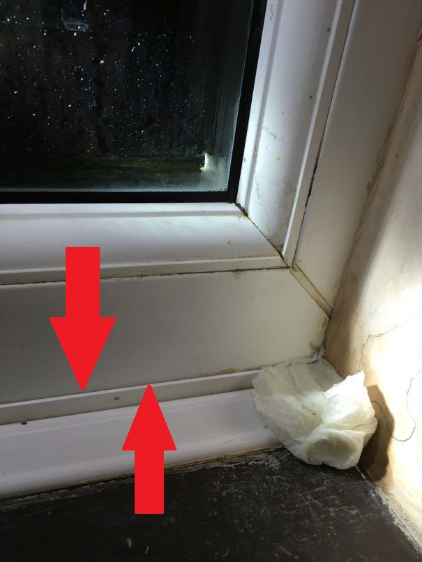

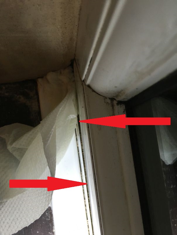

You'll have to excuse the dirty windows. I've not cleaned them up since the workmen was doing all the work.
That last picture is the worst corner & where you see the arrows pointing - that is the bigger gap than on the right hand side.
Spraying water in to the corners made water collect in this little channel thing (whatever it's called) & it'd then run along in to the corners - making them wet.
Initially i thought this was the problem (& i hope it is, so at least we have an answer), but now i'm thinking it's not.
Because spraying water right in to the corners of the sill like that is unnatural. I'm also thinking there's a drain point somewhere in there, so if i have actually sprayed UP a couple of drain points, then of course the water is going to come out somewhere.
So whether i have found the cause or not, i'm not actually sure, but it was development of some description.
That sure is your problem 100%, so have it filled in with silicone, on doors you have such tray like to catch any condensate drips, and when there is quite a bit of water it is designed to run out through drilled holes, I have never seen these drip catching channels or trays or whatever you want to call them used under windows.
I have seen them used on aluminium double glazed doors, but never on windows,
so i would just fill the gap with white silicone and it should for once dry up and you don't need drip catching trays under your windows, if you see condensation running down your window, just wipe it every now and again with a dry towel.
Now you can see why only your corners are getting wet, because that water in tray has no where to escape other than through sides facing the walls, so walls are soaking it all up.
