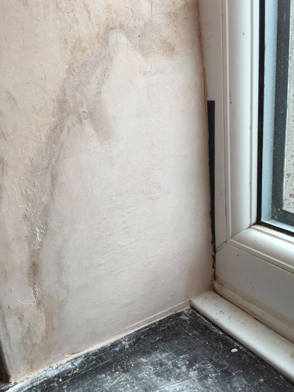

As suspected - the repair failed, but surprisingly the side that was the really bad side (see page 1) ... it's absolutely fine. I'm not saying it's totally fixed because i don't want to jinx it, but we had some pretty good rainfall & it's not even semi-damp.
There is a visible difference too. The DPC is actually sticking out beyond the plaster on the side that seems ok, but not on the side that has gone again. He has put some in there, but it's not like the side that's held up.
The side that WAS the bad side, but has held up ok...

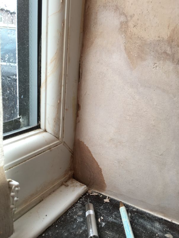

The side that wasn't as bad which has failed....

Would you bother getting them out again to look at this failed side? The only reason i think this is because the side that was bad which has held up ... has held up.
No I wouldn't, because they have done what they could, the problem is what they thought, so it is a tricky one, only your careful observation will reveal the problematic path for the water seepage. But worth a try, you have nothing to loose. If they remove the whole window, and refit it, you would be able to see possible pathways for water within the frame sections.
From the picture, it is obvious that water is getting into the window frame and making its way out of the corners, into the wall, not the other way around, any water getting inside would run along the hollow section of this frame to one side or the other and more towards the lowest side, if it is not perfectly level, or run towards both sides if it is perfectly level. It then emerges from the sides directly into your plaster.
The water isn't coming from the outer wall into inner wall, so it was waste of time placing that felt and replastering, the water is finding its way into the window from either external seals (the black rubber seals aLL AROUND THE GLASS PANELLING, and gaps around mitered corners OF THE RUBBER SEAL) drop by drop rain water builds up over a prolonged raining and BUILDS UP OVER A LONG TIME. That is exactly what you are experiencing. Now you need to do more home work and investigate more thoroughly, get a magnifying glass to see any small imperfection around the glass seal, frame seals and so on, open opening sections to see if you can see any signs of water in opened sections of the frame when it has been raining all day.
