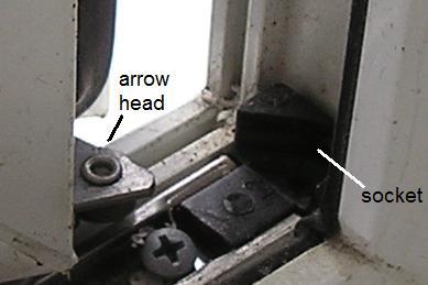

Our house has single glazed UPVC windows. And most of them have gaps (some rather big) between the opening panels and the outer frame. (Not between plastic and glass). Said gaps are supposed to be sealed by black rubber strips, but aren't - whether the rubber is damaged, or the frames warped, I don't know.
What would be suitable for sealing said gaps? I wondered about some sort of sealant gun. But of course I don't want to glue the window shut by accident!

If the gaps are on the hinge side of the openers they could be caused caused by the "arrow head" on the moving part of the hinge binding and not engaging properly in it's socket (See pic):
Sometimes all it takes is a smear of silicone grease to get it to sit in the socket as it should.
Assuming the rubber seals are actually present - other possibilities:
Openers "dropped" and binding on hinges (though I wouldn't have thought single glazing heavy enough to do this);
Depending on what type of handles you've got - Nylon striker pads fallen off so nib on handle doesn't pull opener onto seal when you close it;
Mis-assembled in the first place (though I assume they once closed properly) look out for screws securing hinges sticking out too far ;
Hinges worn out causing play;
Frames distorted because they're supporting a structural load (most common in bays);

Hi again. If the hinges are stiff this in itself could be stopping them from closing. Go easy on the WD40. It degrades some plastics over the long term so I'd wipe off any excess. Here's a picture of a standard hinge:
The arrow head must fit snugly into the socket to pull the hinge side shut.
Another common fault I forgot to mention is a cracked slider block (as shown on pic). The 2 halves of the block go their separate ways so the opener won't pull tight on the hinge side. A new pair of hinges is the only remedy. They were only £4 a pair when I last bought some, but Screwfix seem to have stopped doing them.
Don't worry too much about openers dropping. More likely with large double galzed units. The weight of the glass makes the plastic frame of the opener go off-square.
I wouldn't resort to foam strip unless all-else fails. It's the equivalent of papering over the cracks.
Yeah, that's the same mechanism. And it seems the arrowhead ISN'T properly engaging the socket. (The socket is at a much more obtuse angle than the arrowhead, I wouldn't be surprised if that's wrong)

The arrow head and socket aren't always symmetrical It just means you have to be careful to get the r/h and l/h hinges on the right side. All the replacements I've bought have been, though.
Try a little glob of grease in the socket to see if you can get it to fit better. (Vaseline is OK for a trial, but you need silicone grease if you're doing a load - from a plumbers' merchant).
