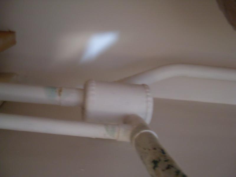

Lastly, I've noticed that in the airing cupboard, the pipe coming up from the boiler has some sort of valve fitted, I wonder if it's an air bleed valve. It's just before the mid-position valve and it looks kinda similar to the ones on the pump.

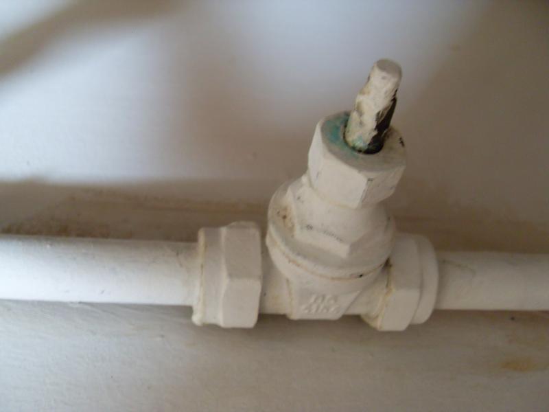

Thanks for your reply! Would the leaks from the radiators be on the valve connection? OK, it's just I've heard from somewhere that the inhibitor is no good for very old boilers - mine is Glow-worm Fuelsaver 55F. I've attached a picture of the valve in question, I think there's a BS 5154 marking on it. Would also appreciate if you could identify the thing in the 2nd picture, it's also part of the CH system and is above the hot water cylinder on a pipe coming from downstairs and going up to the F&E tank I think, maybe a vent pipe?

The valve in the first picture looks like an old gate valve, the second picture is an air separater. the pipework should be fine.

OK thanks. It seems I've got an open vented fully pumped system as the flow pipe from the boiler connects to the pump and then the mid-position valve. This pipe seems to carry on to that gate valve before joining with the return pipe from the hot water cylinder and presumably going back to the boiler. Does that mean it is a bypass valve as it's linking flow and return? So if I close off the pump valves and this bypass valve, I will be able to isolate supply for the motorised valve? Or does it still leave the pipes leading to the cylinder and radiators free? I'm trying to avoid draining down if I can as I'm weary the system is very old.
It could be a bypass, it should link the flow to the return after the pump but before the valve, i would be surprised if it is as you are running on a y plan but that doesnt mean to say it isn't. You can avoid draining down by plugging your cold feed and vent pipe on your f/e tank, however draining down is the safest way if you are unsure what you are doing. As for turning off all the valves it is difficult to say without seeing the whole job.
