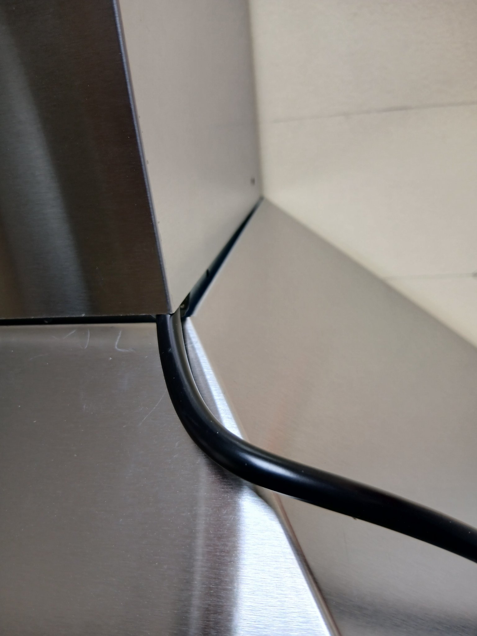

When I installed my hood, I included a double pole switch up high and an inline IEC power to allow the hood to be easily removed if needed.
Because my hood vents into boxed in ducting, the cable goes through a U shaped hole/slot made by me and lined with a gasket/ edge protector.
