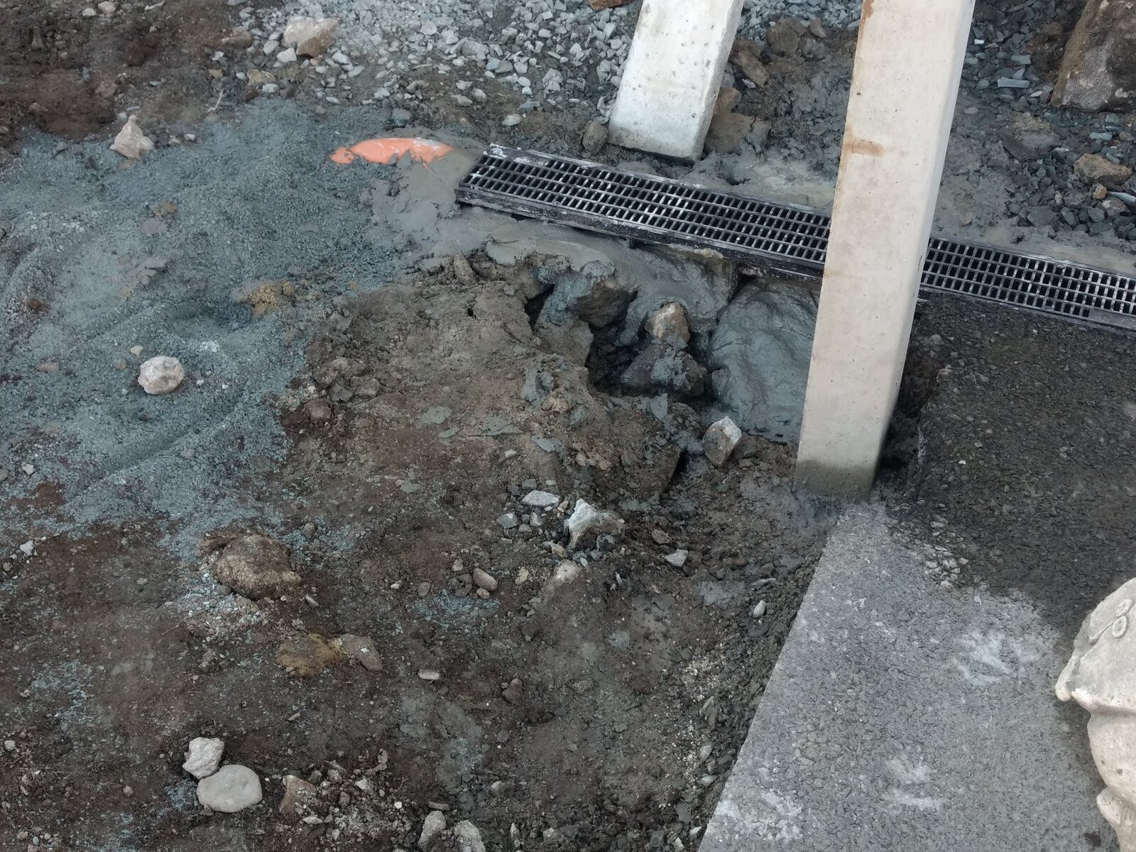

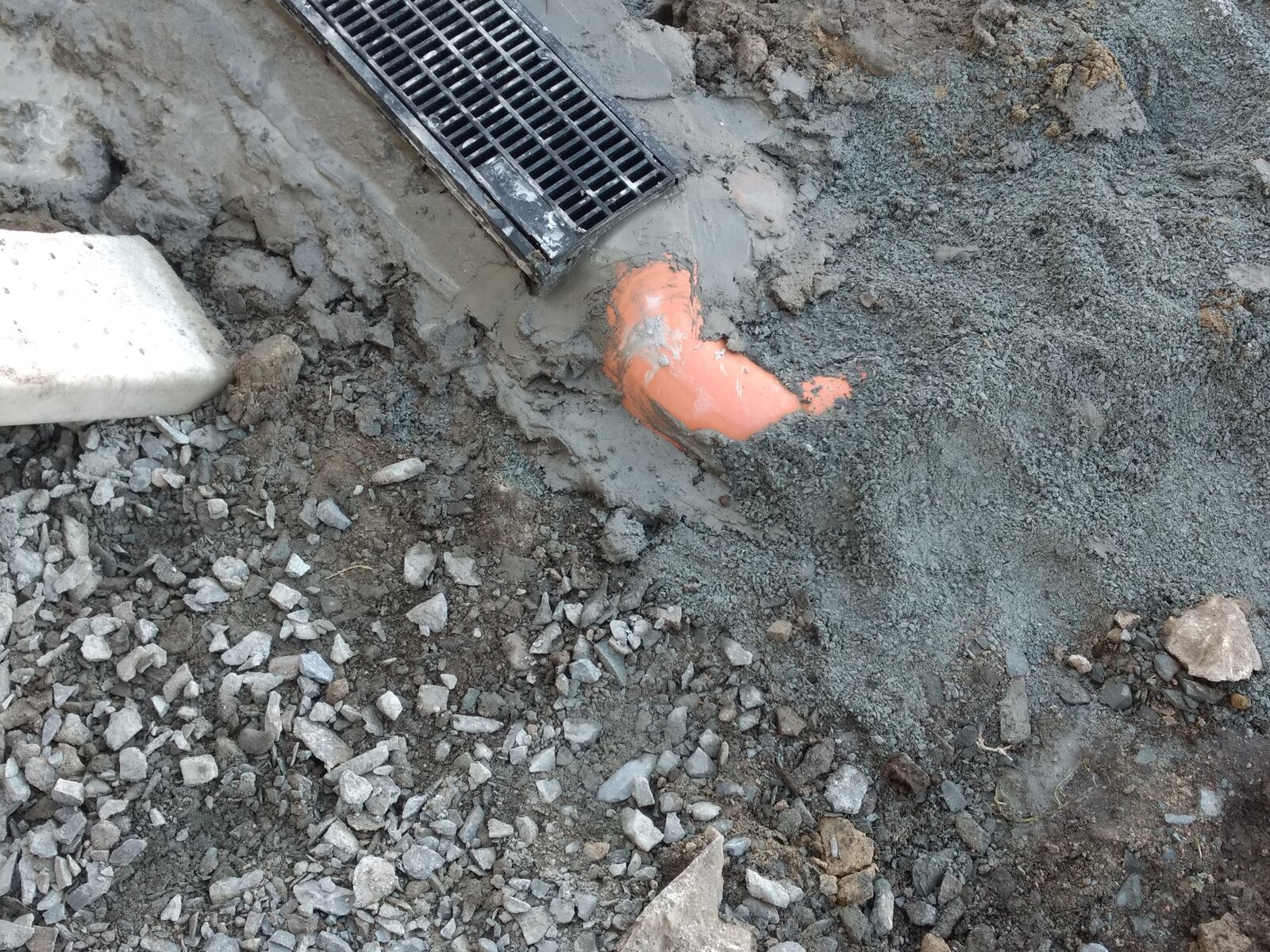

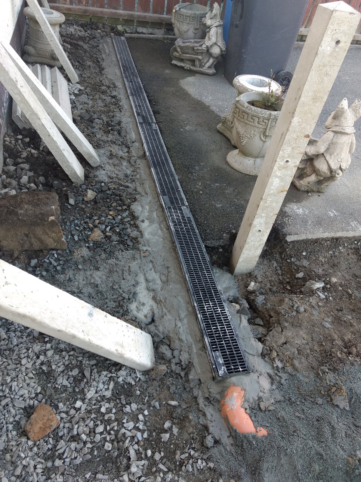

Having some drainage installed before, I pour concrete for a garden path, surely this is not the right way to do it? There is no room left to pour concrete on top.

It's difficult to see what the depth of concrete will be, from your photos.
What depth were you expecting for the concrete?
Concrete being laid is 4 inches, the pipe is sitting at the same level as the prepared ground, pipe runs to a soak away however the pipe is only barely covered as it crosses the lawn.
I understood it would be laid with a bottom outlet to get some depth for the pipework, however it has been laid with the pipe coming from the side outlet.
Yeah, he new I was putting in a concrete path and that the drainage channels would sit within the path. I had said I wanted a bottom outlet so it would allow for the pipe to be buried and left him a rest bend and single socket bend to attach to the bottom outlet of the drainage channels (wasn't sure which one was best)
It will need lifted and laid again, not sure if I should mention it, or just do it myself when he finishes up.
