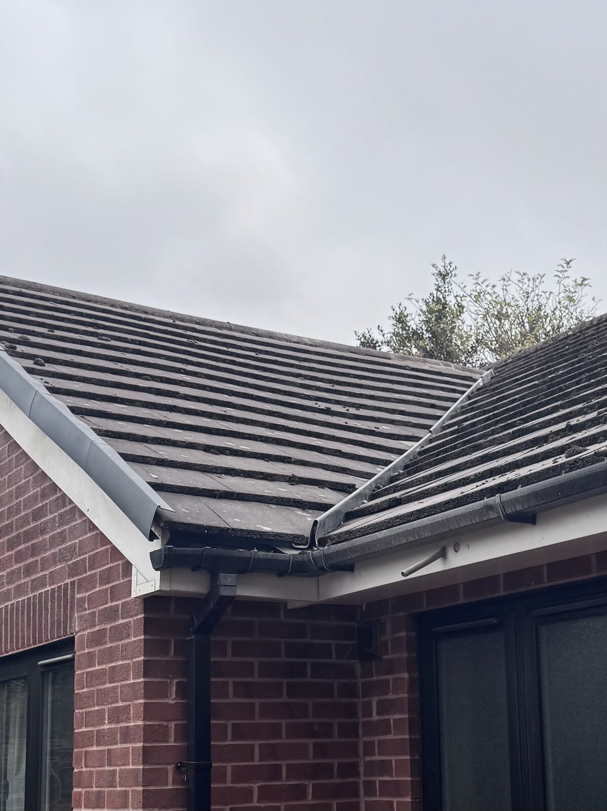

Recently had dry valleys fitted & they seem to look high compared to others I’ve seen & not entirely straight. Does this installation look okay?
Recently had dry valleys fitted & they seem to look high compared to others I’ve seen & not entirely straight. Does this installation look okay?View attachment 395715View attachment 395715
It looks awful as well as that dry verge. DV's should sit on valley trays beneath the battens and be straight and true...
Yours look like some cheap high profile ones the 'roofers' had in the back of their yard. As does the dry verge. Utter tat.
Thank you, I kind of suspected it wasn’t a great job.

Managed to get roofer back out to look & according to him they look like that cause we’ve got a dip in the roof!!
