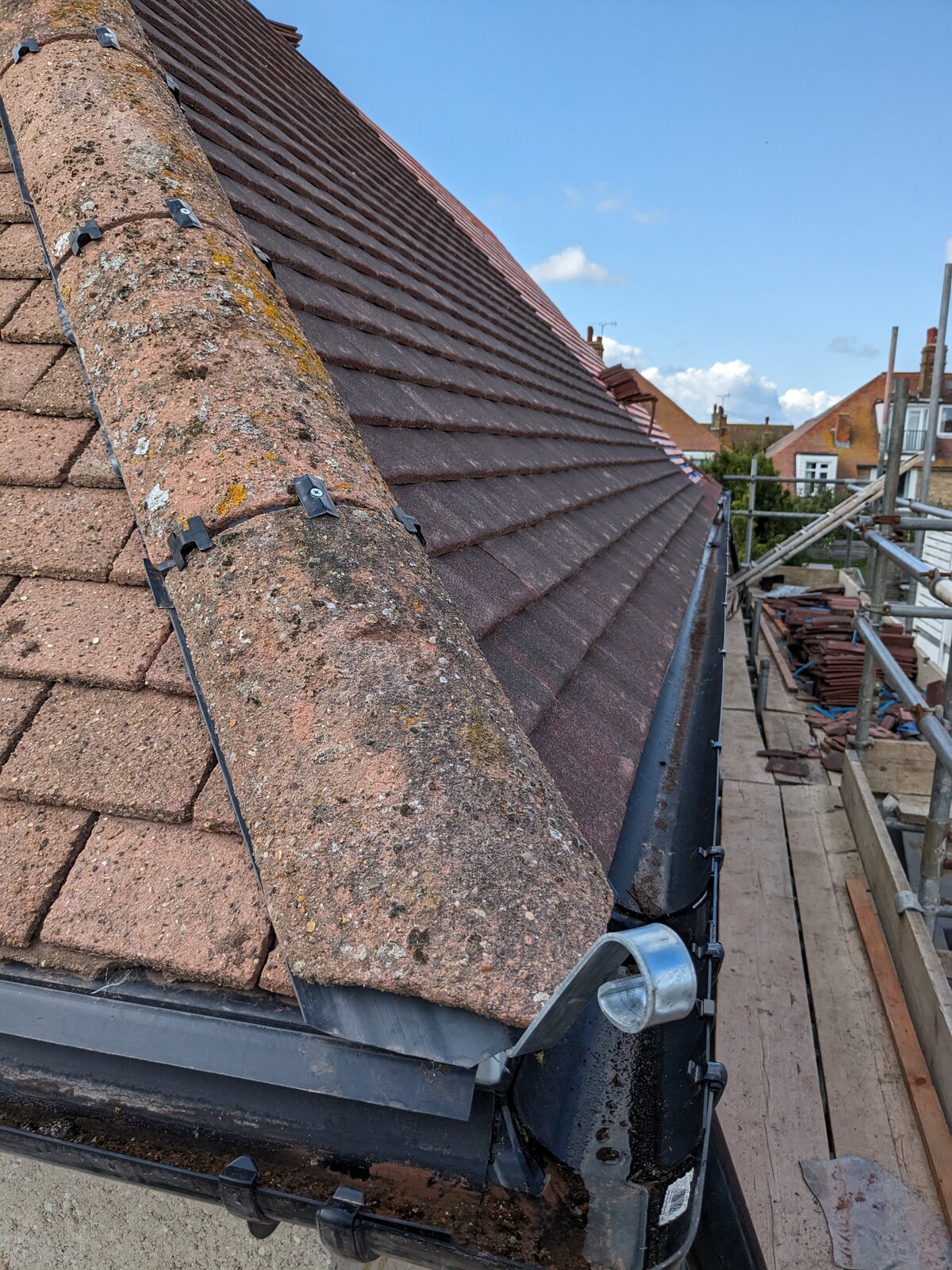

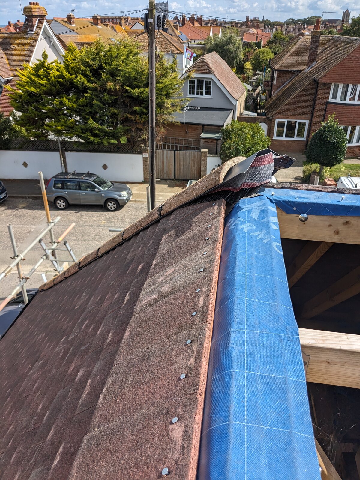

First time installing a dry hip system. Do I need to mortar the first tile in? I've drilled and attached a screw to the centre of the tile and the iron is holding it pretty good.
How would I finish and seal the top tile? Going for a fiberglass flat roof.
Many thanks

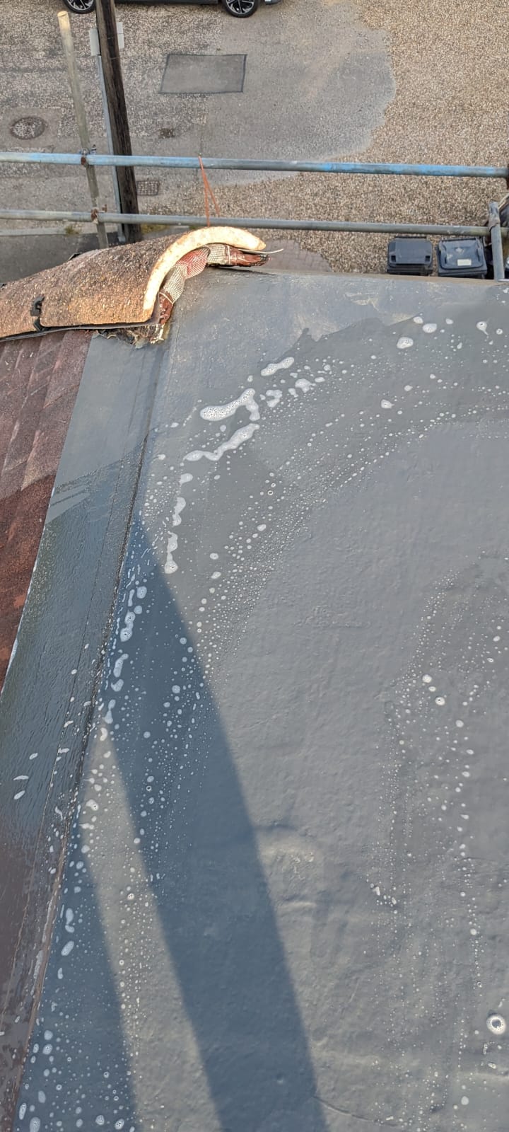

Hey Ash, how did you end up joining the dry hip to the flat roof? Cant seem to find any details or drawings on this one.
I laid the flat roof then fiber glassed the top of the hip tile to the roof. Not got a photo of that though. Not ideal for maintenance I guess.
