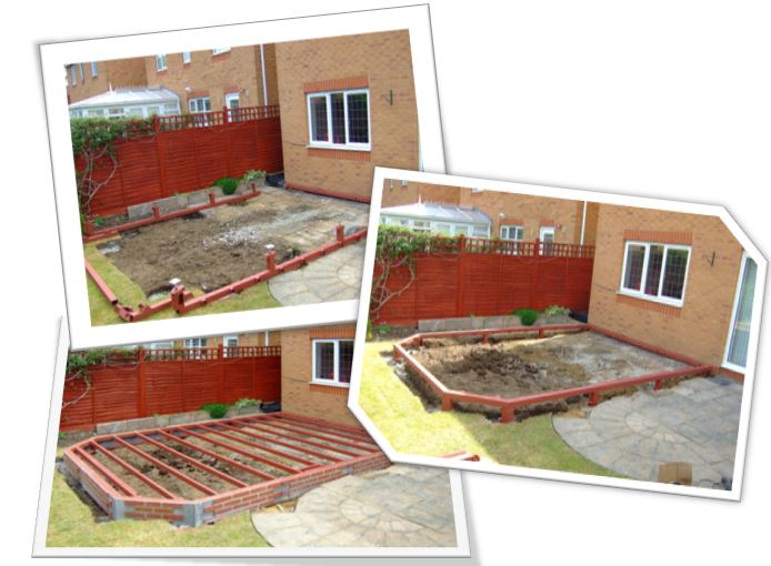

Hi folks,
Has anyone used one of these things before?
http://www.durabase.co.uk/styles.html
We're surrounded by loads of massive trees, clay soil, and a private sewer inspection chamber in the way of where I'd want a conservatory to go, I'm thinking that one of these things might be something to consider in the future.
Anyone any experience with them?
Have only done one so far but it was excellent!
Was only for a small porch but Im looking forward to doing a bigger one.
Im in quite an expensive area, A builder and laborer is about £250 per day or £300 for 2 builders.
So these bases work out about the same as I would get a standard base done.
But in theory they should work out cheaper for jobs that are on sloping ground or where you need deep footings. Also very handy if there are lots of drains and power cables to avoid.
No downsides I can see, Less mess, Faster etc. Like I say Im looking forward to doing a bigger one.
Great stuff Gaz, sorry for all the questions, where did you order yours from? Direct, or via the porch supplier?
Cheers Gaz. I rang them up and the price was better than I was expecting it to be, so it could be a goer in the future.
Is the frame resting on gravels?
Air-vent underneath if higher?
Do you put down dpm?
I bet it sounds dead cluncky when you walk on it. Better off with timber joists.
It is absolutely solid even before the floor boards were screwed into the frame with the self tapping screws.
Cant speak for larger ones yet.
