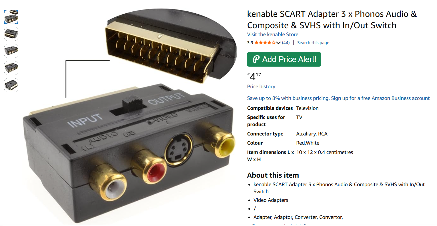

A scart to RCA output should definitely work, that's exactly how I used to get sound to the amp years ago. Think I might even have it still in a box somewhere. :unsure:
I've considered taking the sound from the TV but it doesn't have RCA output, only Scart and SPDIF. I've tried the Scart via an audio converter but get no sound from that. If I use the SPDIF I'm in the same situation as with the splitter - I will need to convert it to RCA and I want to be sure that anything I buy will work.
SCART was designed to be a two-way connection, even if it wasn't always fully used. That caused no end of problems with SCART to RCA leads because it was too easy to buy a one-way wired lead, or try to get audio out from RCAs designed to send sound to the TV. The switched SCART adapters helped here. If there was no signal when you knew it should be there, flicking the switch to the other setting fixed it most times.
The other wrinkle with TV SCART is that audio out only worked for the TV tuner. Now, admittedly, that was a long time ago, well before Freeview and HDMI sockets on TVs. However, it's still worth checking if you're determined to go down the SCART route.

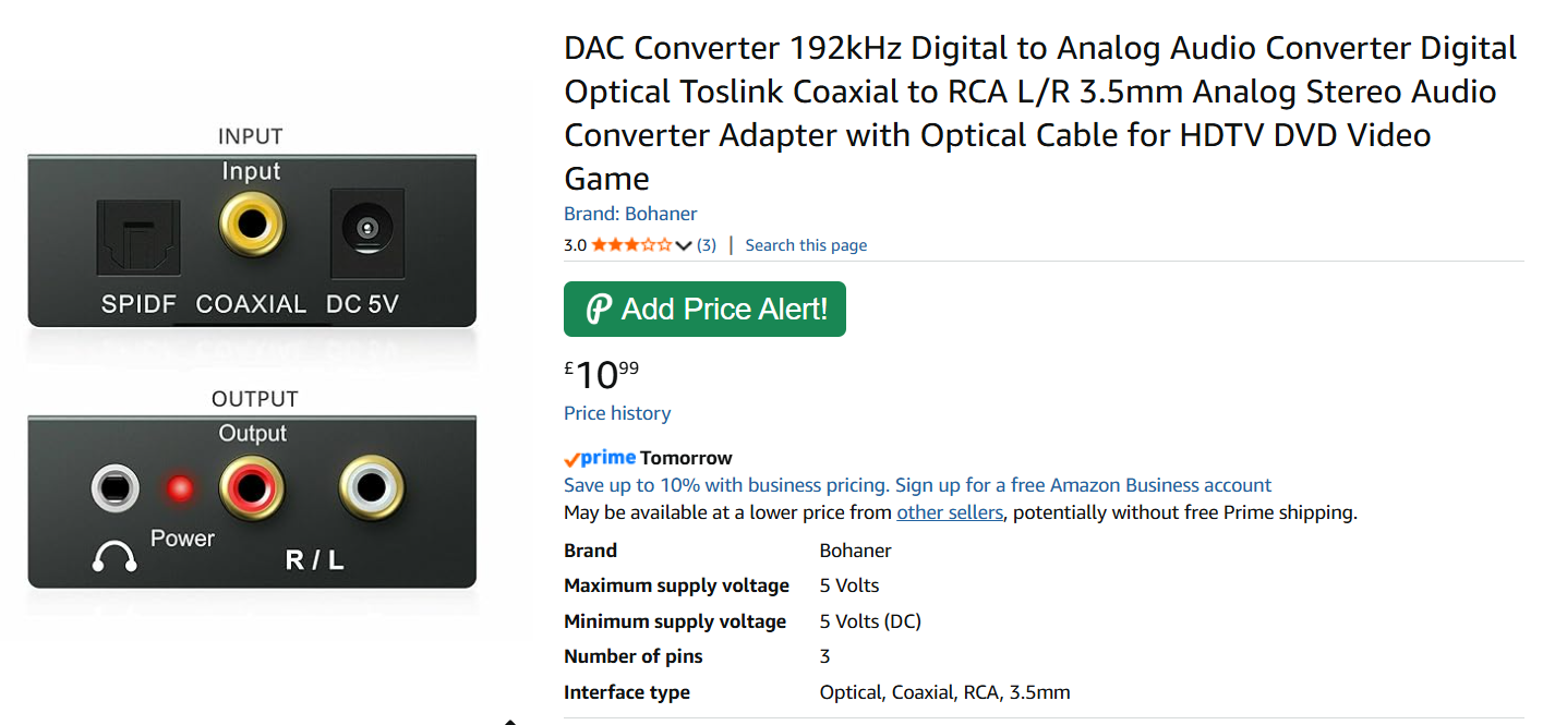

I think optical is a safer bet. Get an optical to RCA analogue convertor. These often require powered from a TV USB socket. If your TV doesn't have that, make sure to buy a 5 volt wall wart USB power supply.
You'll need to check some TV audio settings. Digital audio out needs to be set to PCM rather than Dolby or Auto. This stuff will be in the TV manual.
I'm using one of these: https://www.amazon.co.uk/Monster-MV1SC-AV1-EU-Single-Adapter/dp/B000EDVOAS . I've used it before to get audio out of an STB so I know it works.
I've tried all the switches in all possible positions but still no audio. The TV is a Samsung probably less than 10 years old. It receives the audio from the DVD OK via HDMI.
I think I'll have to try the optical route as you suggest. The converter you linked to is not expensive.
Alan
I've now got an optical converter and at last I'm getting sound out of the Panasonic box. So many thanks for your help.
