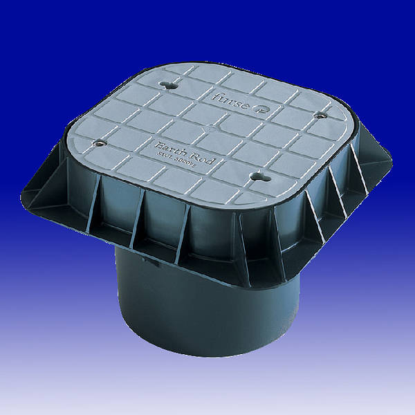

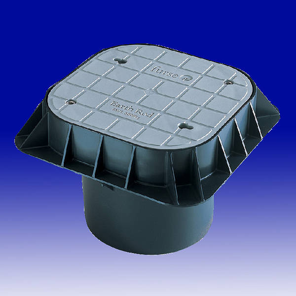

The whole idea of this 1680993012975.png is to keep you a safe distance from the earth rod, once repairs are made one needs to test, this explains how the rub is it needs special testing gear, so not really a DIY job.

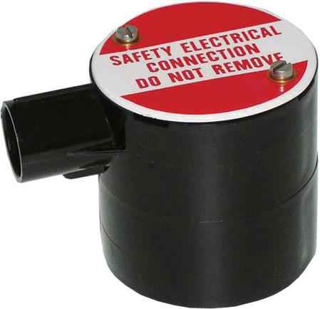

Yes one strand was what I ment the cover was just one of these
