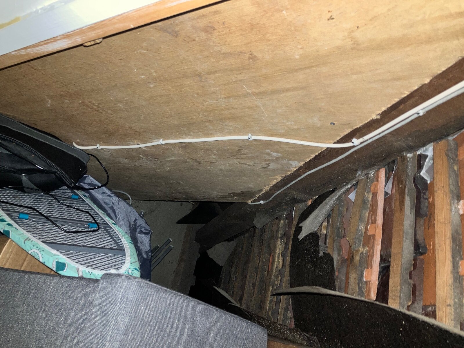

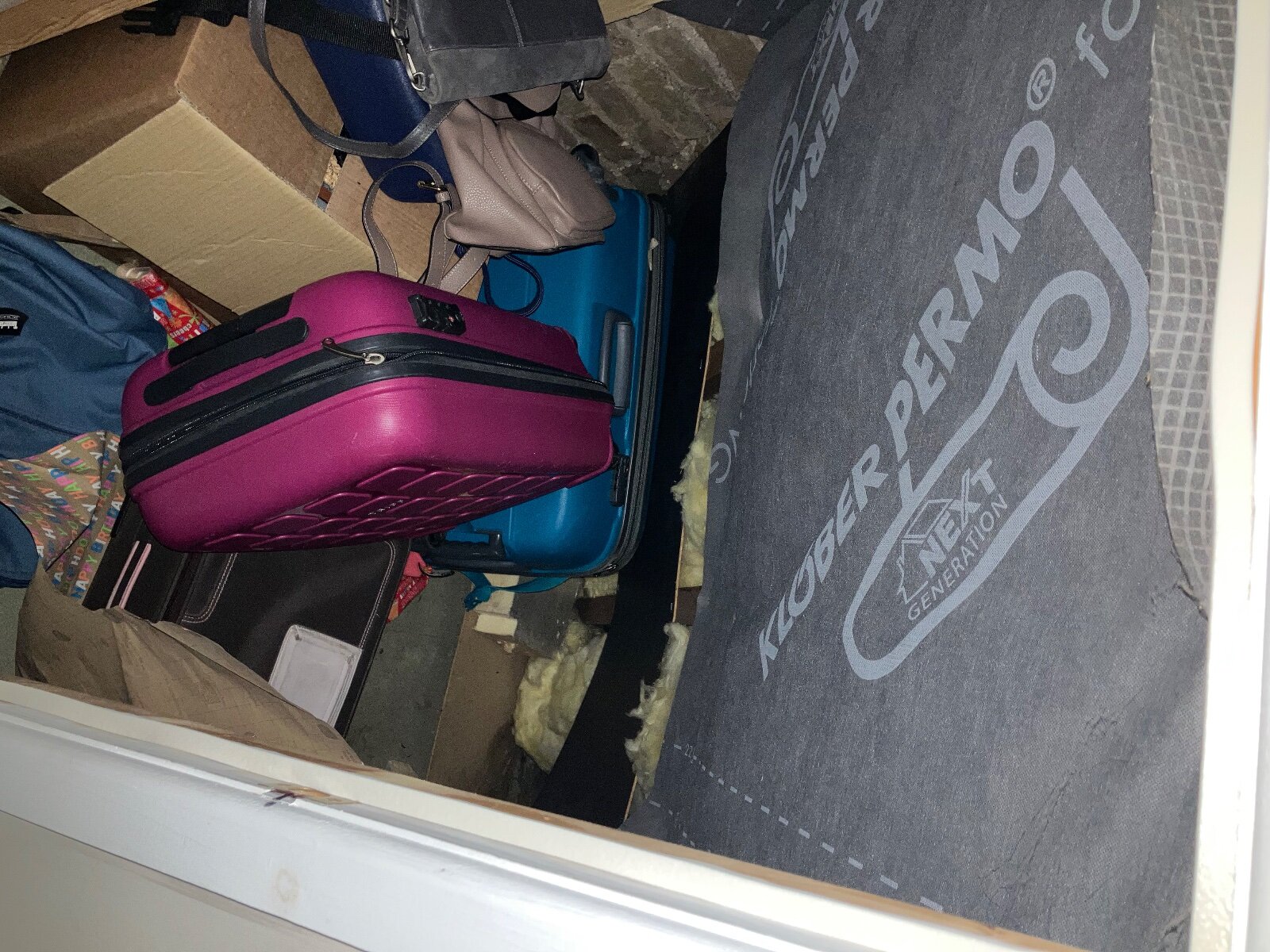

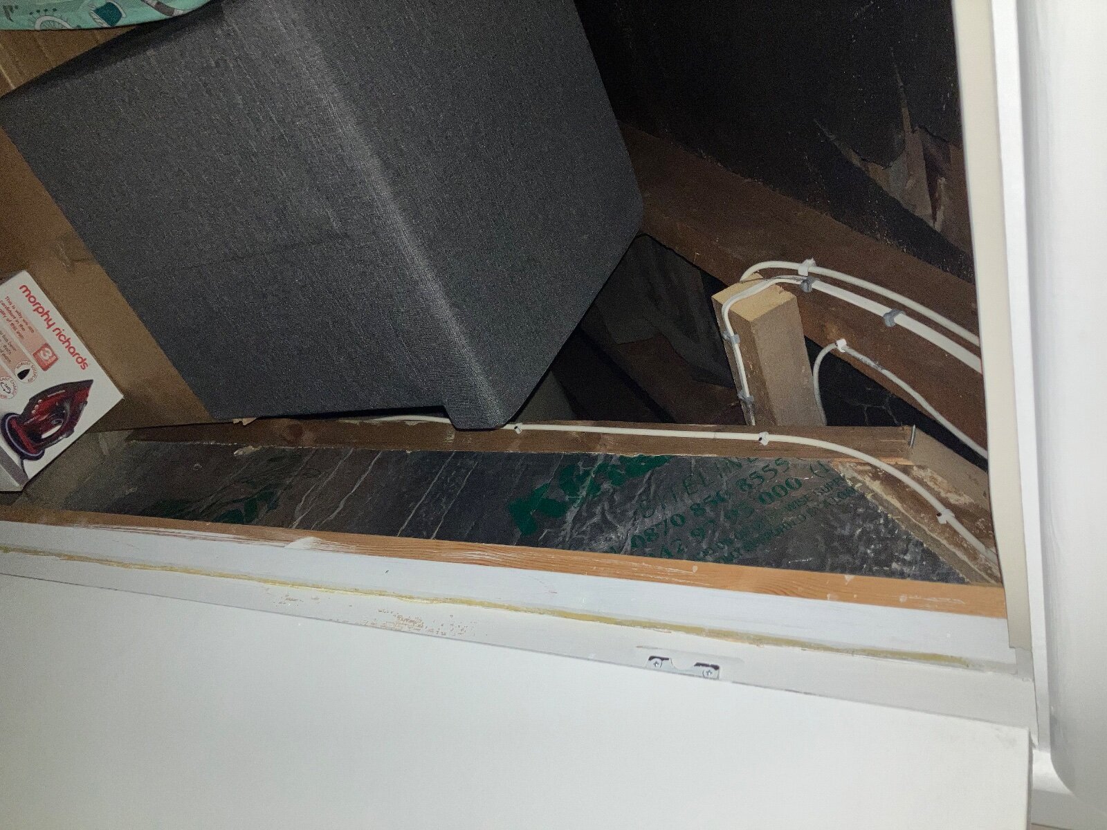

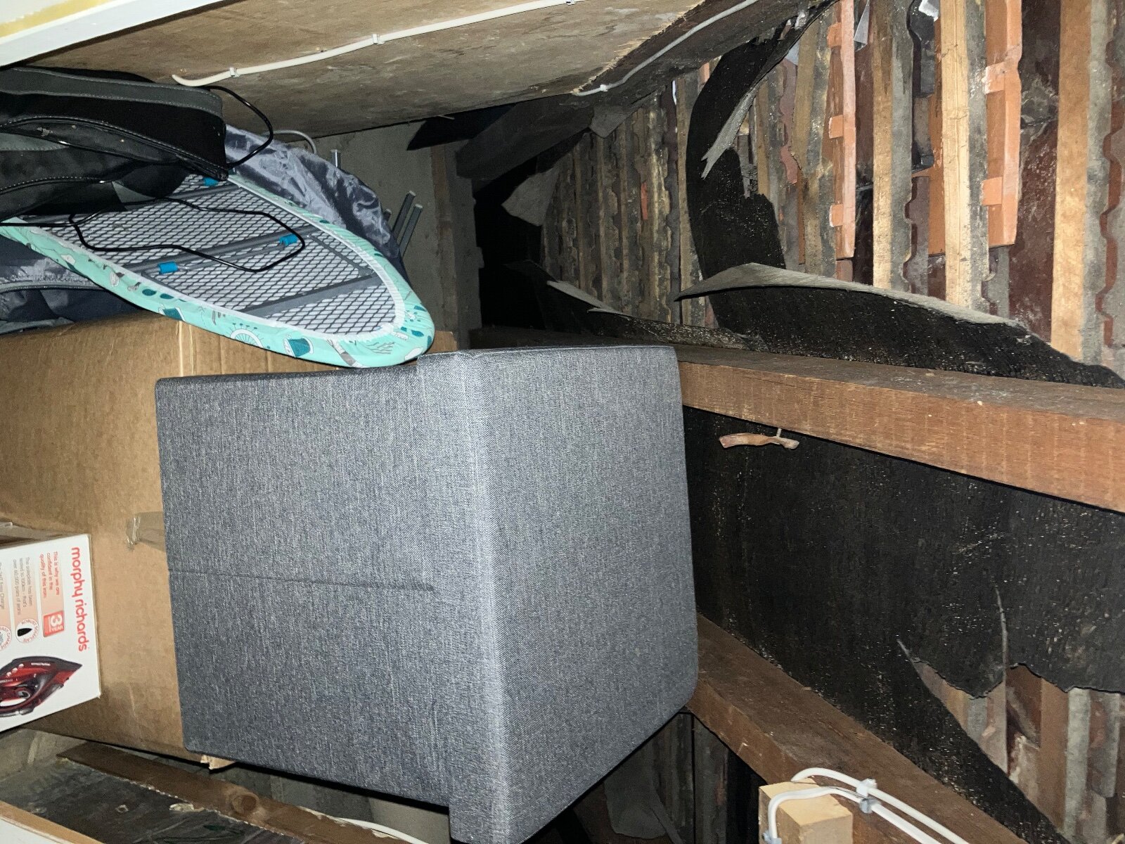

Hi, any recommendations for type of insulation in first floor bedroom eaves cupboards most welcome, thanks.

Eco loft. Non itch for health reasons.
Looks like you have too much stuff in loft.
The weight will cause the ceilings to bow.
Fit some loft floor boards to spread weight across joists.
Screw some timber across on big spans to spread weight across joists.
Put what you can above walls for support under.
Stuff like that gets ruined by the summer heat and cold winters anyway along with the dust fibers that gets in it
