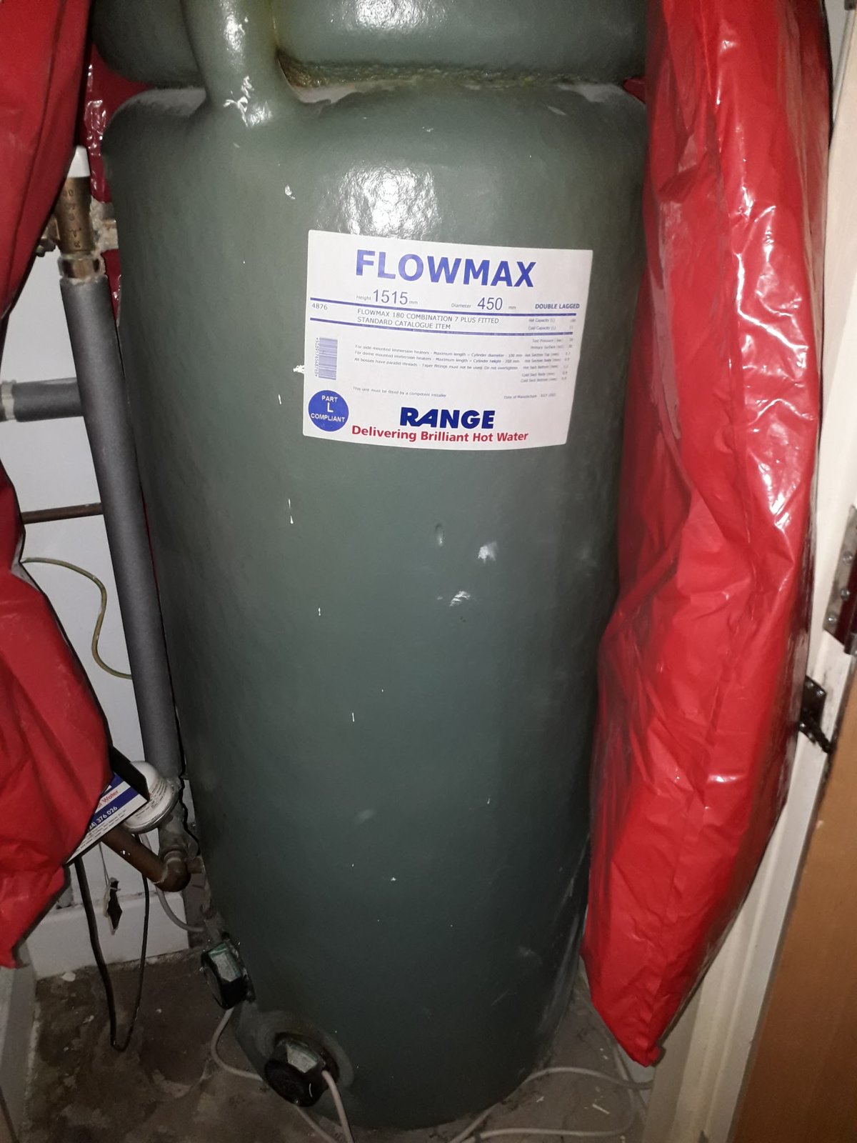

show us a photo of the cylinder please (including the various cables going into it) and whatever controls you have

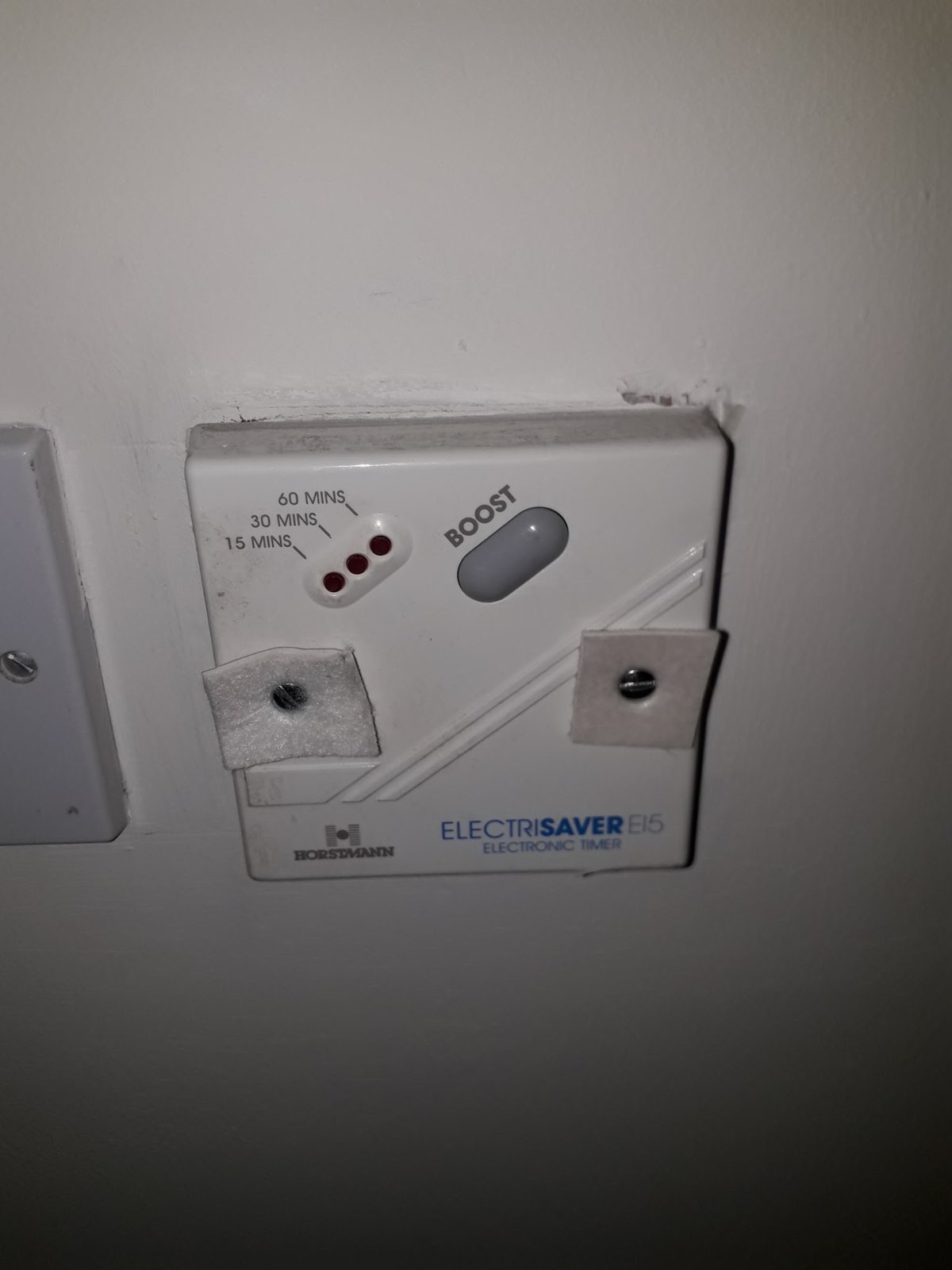

Ok, this is what I have

You have only shown us the boost controller.
This would normally be connected to just one of the immersion heaters and should work at anytime. So that when you press the button, each time you do so, the 'on' time should increase by incrementing one light up the scale each time it is pressed. Do the light operate, and if set to 60 minutes does the hot water heat up?

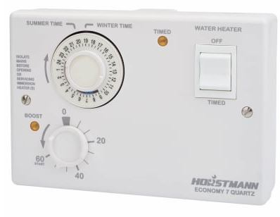

Normally the other element should be connected to a timed electrical supply that is only 'on' at the same time as a cheaper electricity tariff (eg economy 7) is available. There are two common ways of achieving this:
The first way is by having a separate timer for the 'off peak' immersion heater control. That looks something like this:

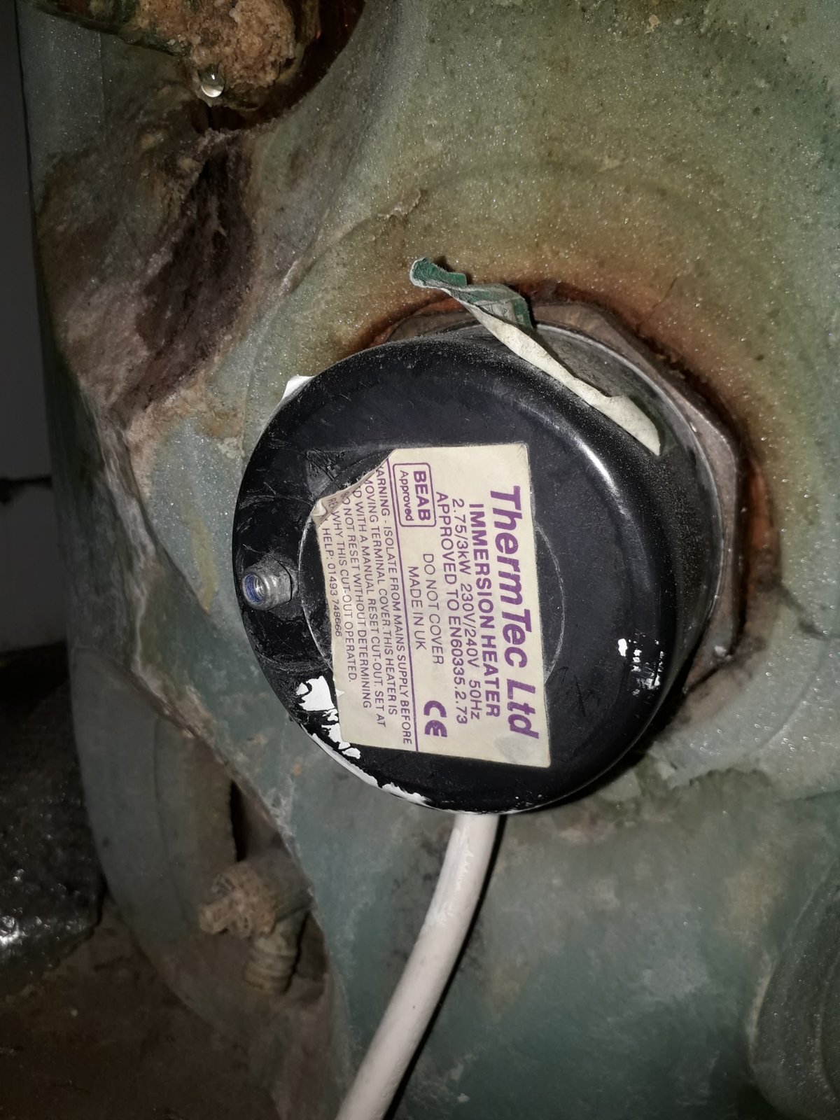

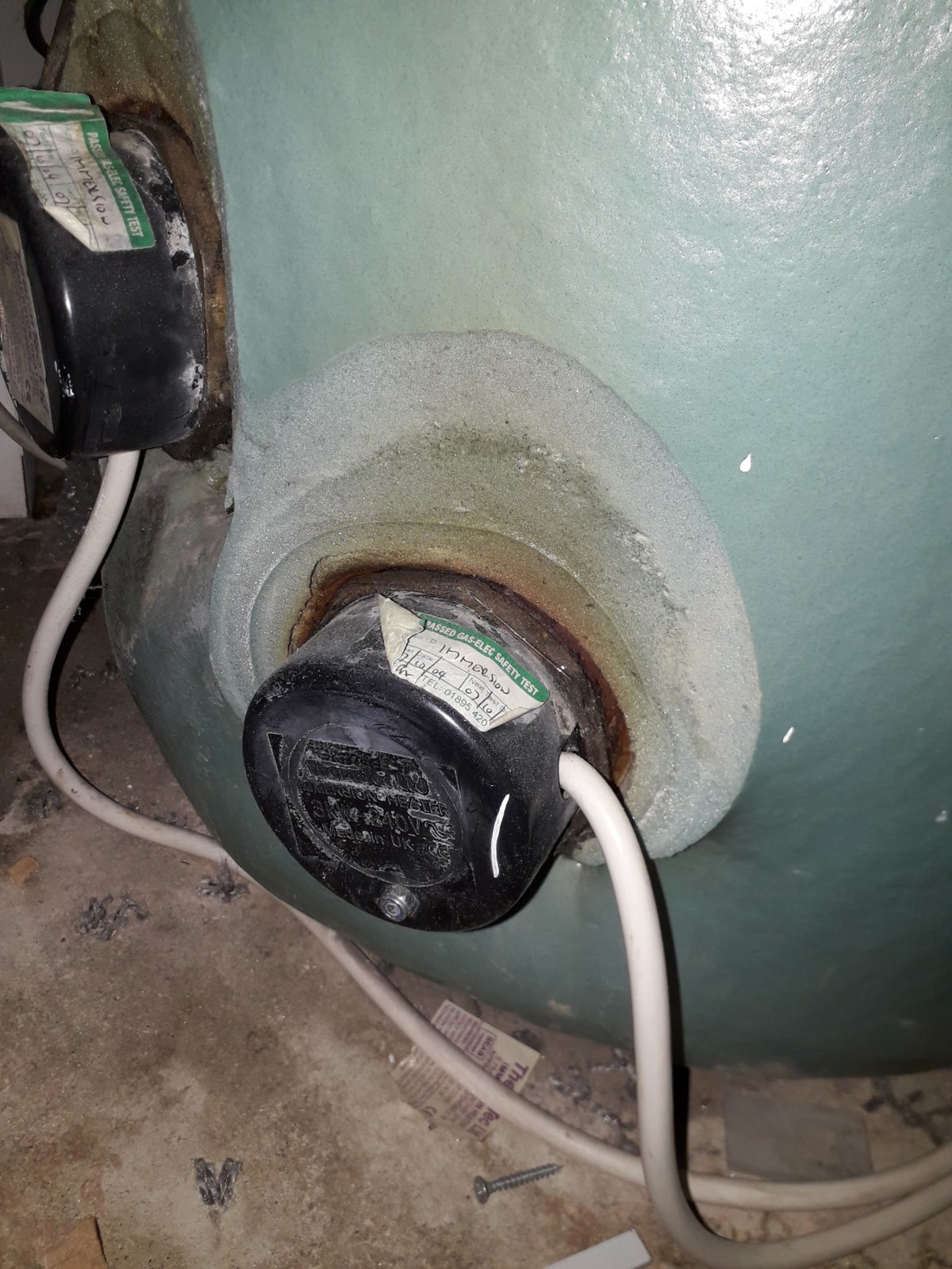

Looking at your immersion heaters they do look quite elderly, and as they are resistance heating elements, they do have quite a short lifespan if used regularly, also their internal thermostats can fail, or if fitted, their overheat trips can operate. Immersion heaters can be tested quite easily by someone electrically competent.
Thats all I can find anywhere. Thats in the kitchen.

Right
so now I know the economy 7 is working overnight as I’ve checked. it’s kicking in and heating water. The water is hot in the top part of the cylinder. Also, if I try the boost it kicks in and works for the specified time.
.........then it comes through the taps red hot for about 5 seconds then lukewarm
long and short, the heating function is working but then something ain’t right from the cylinder to the taps.
