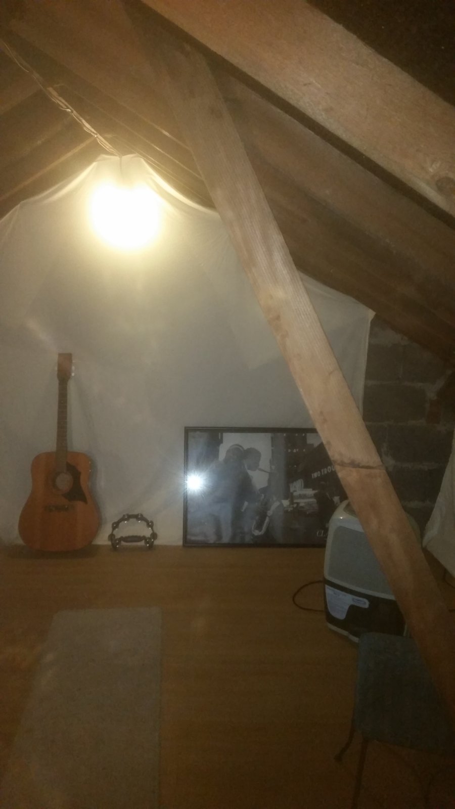

I am making a music room in my loft and need to insulate the roof, the depth from felt to rafter edge is only 75mm, so I will use 25mm Ecotherm to leave the 50mm air gap behind, my question is would Rockwool acoustic slabs be better for noise reduction?

wool is better than PIR but I'm not sure how useful 25mm would be. PIR insulates thermally twice as well. If you want warmth 50-100mm below might be needed.
If it really is felt then make sure your ventilation and vcl detailing is spot on as it can get condensation really easily trapped in there.

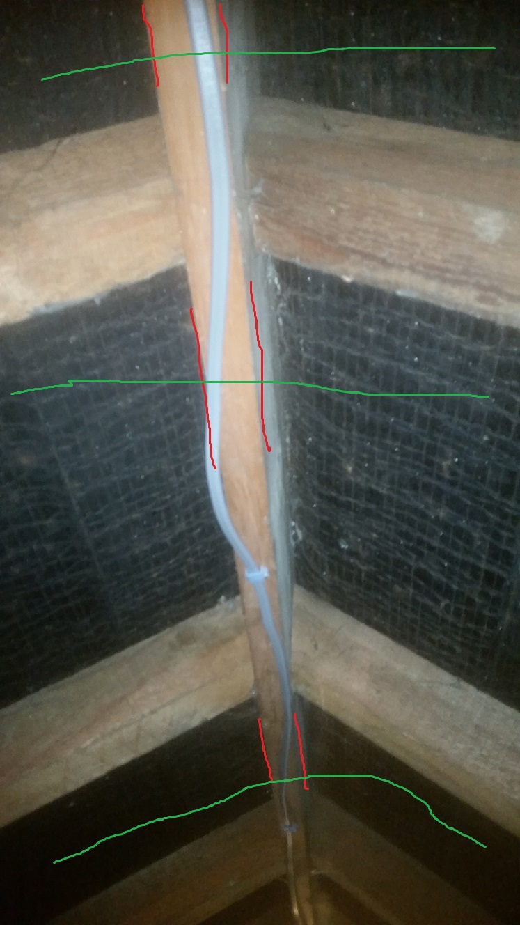

Pic added for info...red = vents (do I need a vent here for every slab?)
Green = airflow

you'd just need plenty of breeze running through, if you've ever camped in a tent you'll know how wet the inside gets and they aren't exactly draught proof. Nowadays people avoid specifying cold roofs like that due to how easily things can get wet.
you would certainly need a path from end to end clear of obstructions that can get a bit of a breeze coming through.
