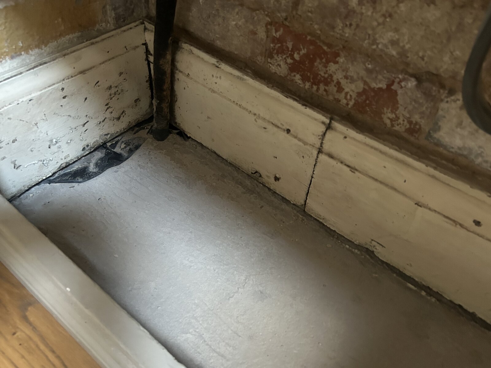

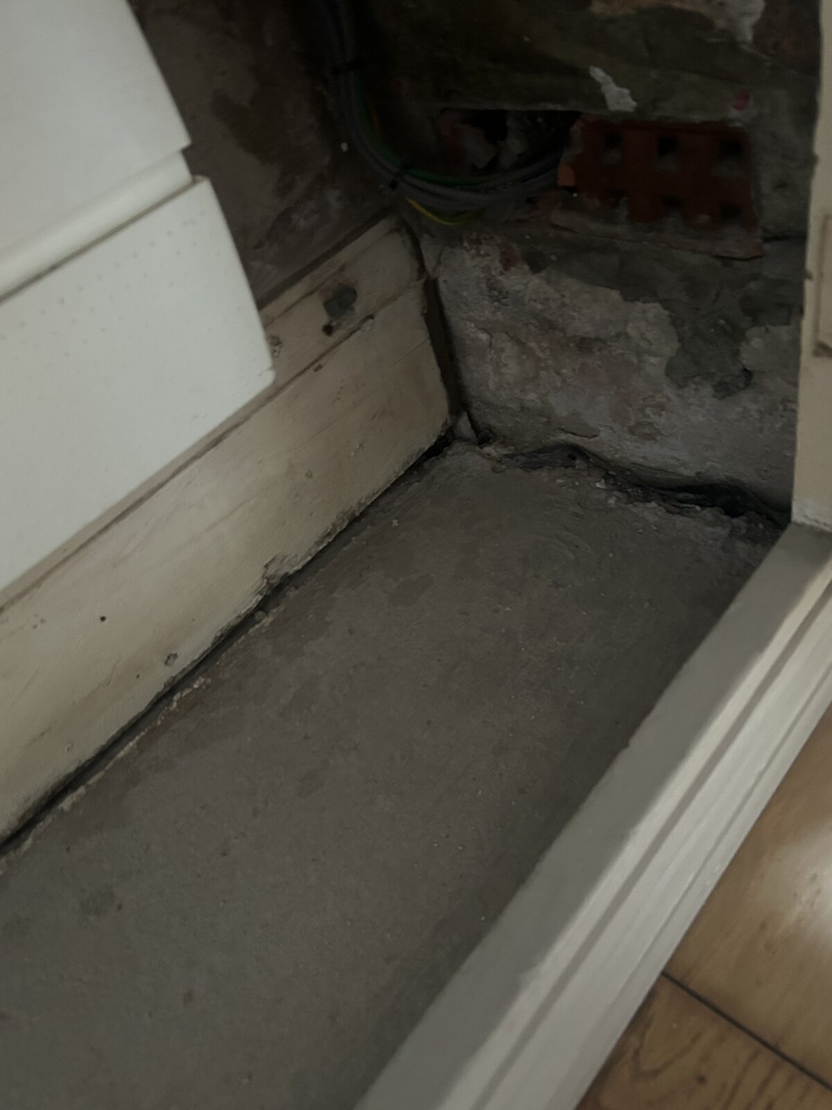

Thanks for the replies.
Just to add that the skirting is bone dry and the plaster was dry also, although blown.
Floor is concrete slab that is dry.
The left side is the chimney breast wall where’s there’s a gap.
Right side shows the air vent now not in use due to an extension.

Can you turn the flash on please
And stand back to show some wider views
If that skirting was in my house, I'd burn it just in case it had been infected with mould spores. Spores can lay dormant for a long time and then break through when a hint of dampness occurs. Replace with any flat smooth timber because it won't be seen in a closed cupboard, but first get that wall sorted out.

It may be dry at present in the fine weather but must be getter damp during wet weather .Pics of chimney and roof might be helpful.
