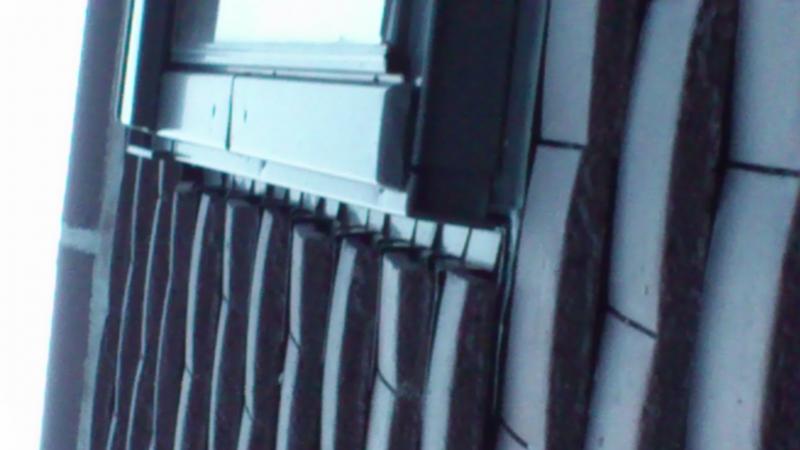

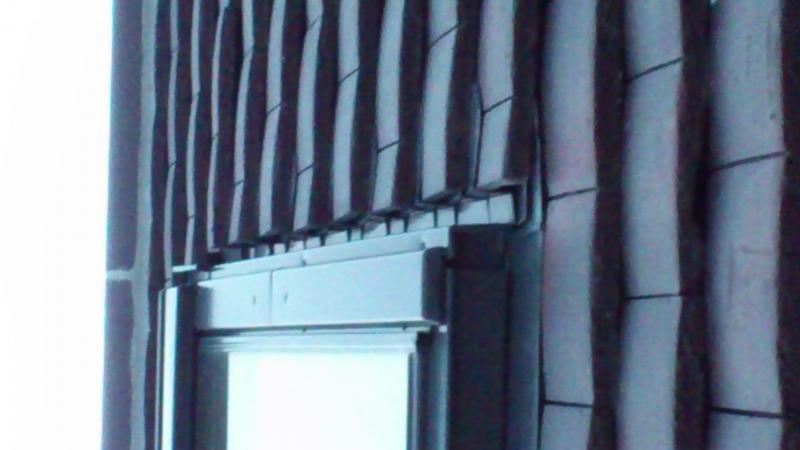

Any way thanks for your response - yep you were right EDP not the right kit, as overlap of tiles too small for soakers to work (plain tiles have a much greater overlap). Phoned Velux back, and they said EDZ definitely the flashing kit Marley state is right for their Ashmore tiles, and they should never have recommended EDP! :confused:
So what we have done is notch out a V with an angle grinder from the back of the tiles so that they can sit closer to the frame, and used the soakers from the EDP set overlapping which means every alternate one sticks out, so I tin snipped them into a decorative curve. We also replaced the corrugated EDZ apron with the flat EDP apron. A bit more jiggery and pokery needed with tin snips by the top flashing piece with the soakers, but because we retained the EDZ side flashings, this was more for aesthetics than weatherproofing.
This means the foam is no longer visible (and so should not disintegrate so fast), and the whole thing looks better, and is more weathertight! Phew wot a job! :)

TBH with careful tile cutting and a little thought it's possible to use the edz and not see any foam at all..
but you can see the adapted soakers??? how about a pic looking up the side channel
Thayts why I tinsnipped every alternate soaker in to 'decorative' curves -take it you don't approve! We think it looks attractive! ;)
The best thing about it is that we know that this 'double insurance' means that we are completetly waterproof.
Will try to get a photo for you posted asap (means getting out there on a ladder) - though you can't see a lot looking up the channel - just looks like a load of overlapping soakers flush with the edge of the tiles
