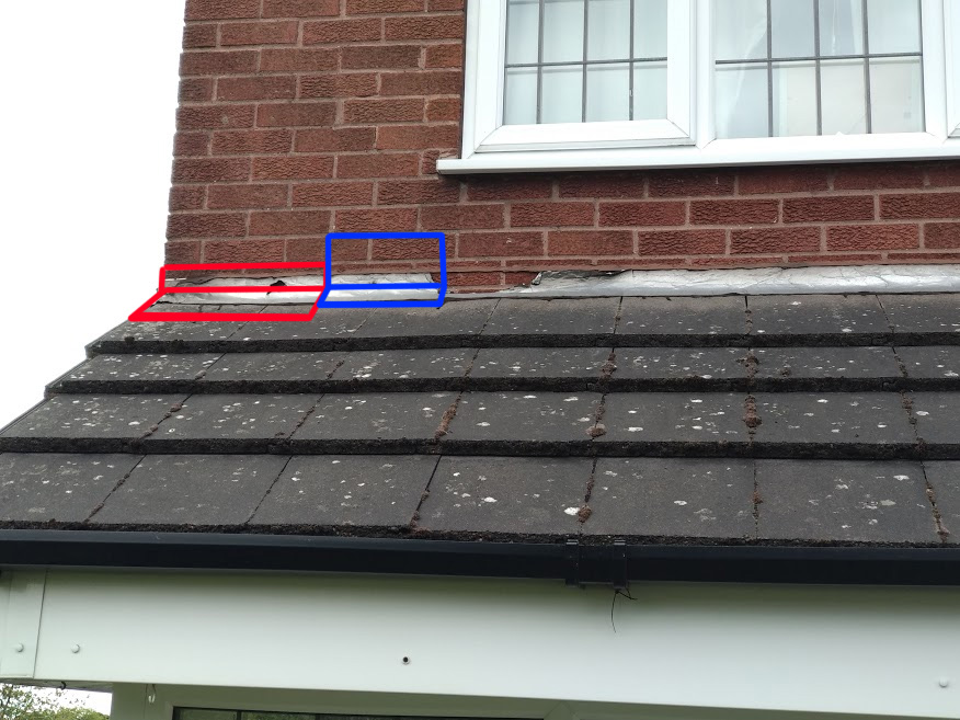

3. The ends. Last time I did anything like this. I made the lead a bit longer than the roof and cut a large v shape into the side which allowed the vertical part to go out at an angle and the slope part to fold round the edge of the tile. With this roof the tiles actually go a few mm past the edge of the wall. Do I just finish the vertical section at the edge of the wall and then overlap the tile or do I lap the lead around the corner of the wall?

In this instance you would maintain the vertical part of the lead right down to the gutter or the end of the tile. You form a tapering free standing up-stand on the lead that keeps the water from going over the short bit of verge..

I'll try and get a photo to explain the ends

I'm just trying to decide the way that will look best.
I've attached a picture below - which gives the two basic options. I have marked them in red and blue - they aren't exactly to scale and the angle of the camera makes the slope look shorter than it is.
The red one would have approx 3.5" of lead vertical, and approx 8" down the slope of the tile.
The blue one would have approx 6" of lead vertical and approx 5.5" down the slope of the tile.
The current nasty flashing tape is about 6" wide, so the flashing is going to look a lot bigger.
I'm edging towards the red looking better. Do you agree?

Sorry - forgot the attachment...
red looks like 75 mm? in which case its fine
Just over 85mm for the upstand if I go with Red.
I'm still undecided. I think 6" of upstand will look like a big thick strip compared to the size of the roof.

I need to make that decision on blue or red!
It's your choice , 75 mm is within realms of good lead work
