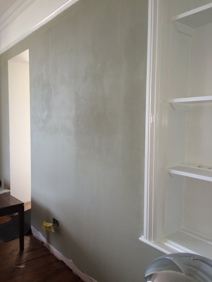

As far as I know they're the orginal brick - 1930s. Here's the whole wall. Could it be that the ventilation below isn't as effective as the open fire place was and so caused condensation? Thanks

that's a very big damp patch. Am I looking at a chimneybreast?
Yes, but it never protruded into the room it was on the outside of the house. The chimney breast itself is about 40 inches so this damp is in the bricks either side too.
right.
Disused chimneys suffer internal condensation unless they are ventilated top and bottom. Rain can also penetrate from the top.
How is this chimney (it probably has two or more flues) ventilated?
I can't say I know , how can I check? As I mentioned it's vented into the floor void and there's a chimney pot up top with a curved terracotta cover, I assume to stop birds. Whether it's blocked above the fireplace I don't know for sure but we used to get grit and stuff coming into the hearth especially after high winds. We've been here three years and there's always been an open fireplace. There's a gas tap nearby so I assume there was a gas fire installed at some point. There was a fireplace in the room next door which is open, so if I had to guess, they were both open.

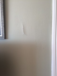

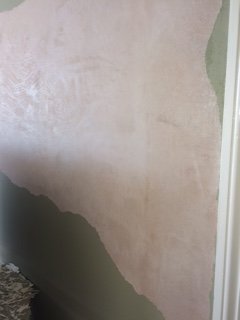

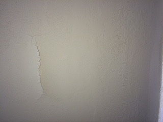

I posted the above last summer about efflorescence appearing on recently plastered walls after a mist coat of Dulux Diamond Matt. I subsequently applied Dulux Alkali Resisting Primer, albeit to the mist coat rather than the bare plaster, then finished the job. Over a period of months the surface in the area to the right began to roughen up and eventually the paint lifted to the point where I could peel large pieces off. I've now taken a scraper to it and it's coming off in one piece in most areas.
There are no water leaks so I can only imagine that there is/has been condensation in the chimney even though it's ventilated into a large void below the floor. There were some crystals where the paint split but otherwise the plaster underneath seems in good condition and doesn't appear to be damp, so do you I might have painted it before it was fully dry or is there still likely to be some underlying problem which will re-occur if I paint it again? Thanks.

My guess is that it was painted before being fully dried out - it certainly seems dry now, though.
The most important part of treating efflorescence is to apply your alkali resistant primer directly to the bare plaster, once the wall is totally dry and all salts have been brushed off. Adding any form of moisture before treatment (filler, emulsion, or even wiping over the bare plaster with a damp rag), can cause the salts to reactivate and, in time, start to break through the new decoration. Now is the ideal time to use the ARP, while the surface is dry and free of salts, but efflorescence is notoriously difficult to stop and even this method is never 100% guaranteed.
