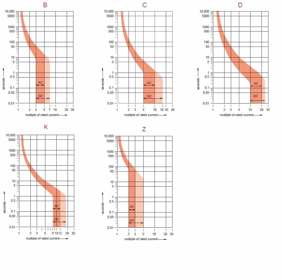

Electric shower cuts out after 5 mins
You should not change the MCB for one with a higher rating if that's your intention.
The person that installed the circuit has judged that a 32amp breaker was suitable to protect the circuit cable.
Your shower appears to be drawing current at a level that the existing cable is carrying at its upper limit within its method of installation.
Do yourself a favour and engage an electrician to install an upgraded circuit

The overcurrent protective device is there to protect the circuit cable from carrying current in excess of what it can safely carry. Putting a shower on that draws less current than the original shower isn't an issue.
So both then. I will change the MCB first as that is the more economical and shorter time change. See if that has any impact. Then swap the cable out
Changing the MCB to a higher rating will ( probably ) prevent the shower from cutting out but will mean the cable will not longer be protected from overload, The overheating of the cable will be increased as the higher rated MCB will not be cutting power
Replace cable first, then the MCB,
To stay within regulations maybe get a new 32A MCB installed, if the tables below are accurate and your cable load is 38A then that MCB theoretically shouldn't trip for between 15 and 25 minutes, all a bit borderline I suppose.,
