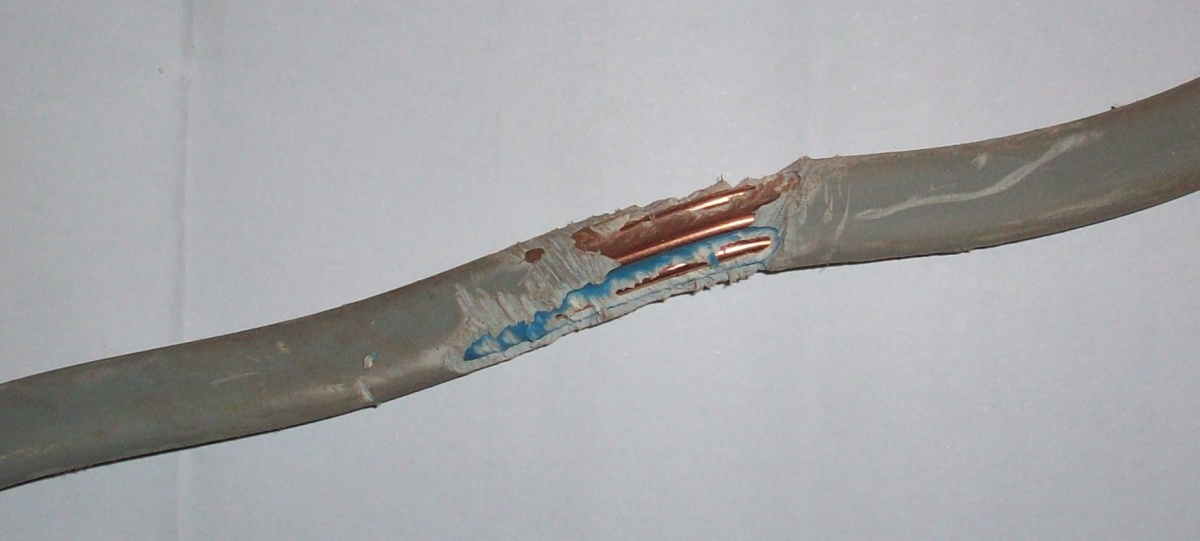

Ah, those critters. This illustrates the point that EFLI made - this picture from my house, which I have posted a good few times before, shows a cable that passed an IR test with flying colours - tests aren't everything!!

piccie didn't post ... try again ...

this was found under a floor. All had been fine until the house woodwork was sprayed for woodworm, saturating the bare conductors. The RCD did not like that!
Strangely the little critters had concentrated on the neutral half of the cable, so there were no fried bodies to be found. I wonder how they knew....
