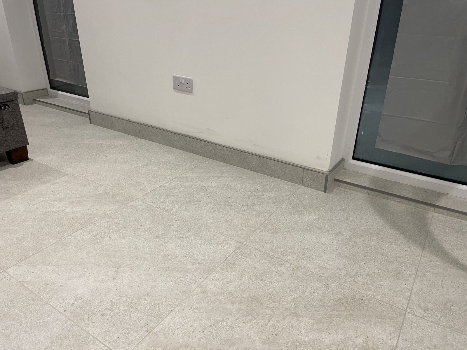

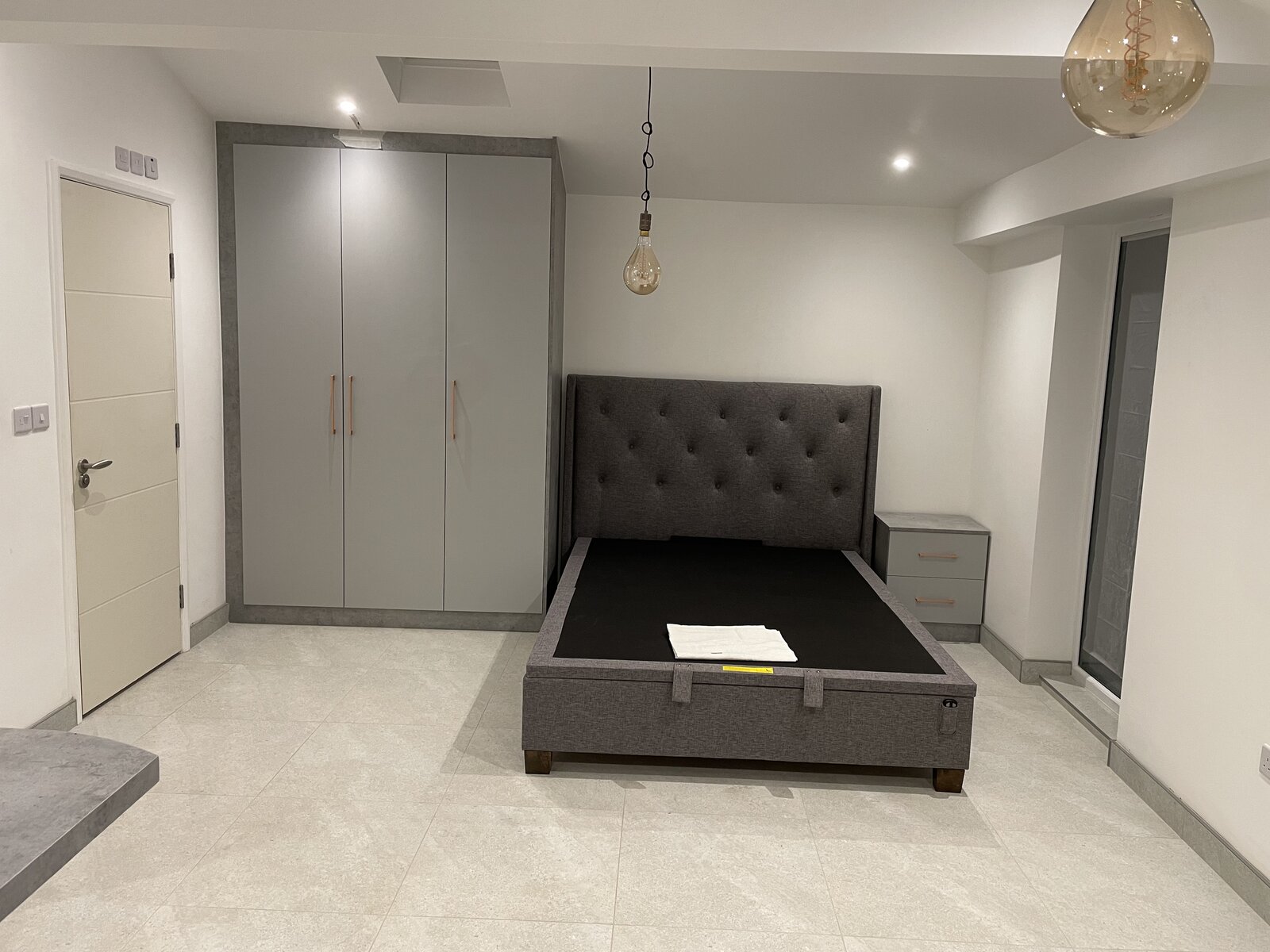

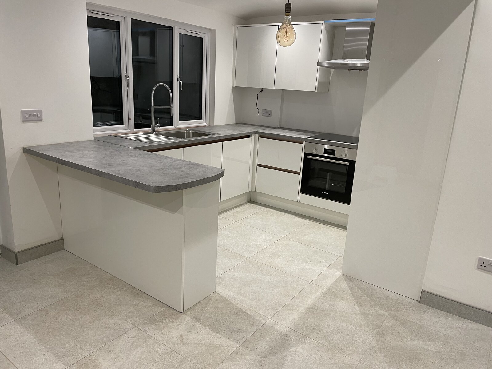

Anyways, finally kicked the builder out of our property, and most things are ok. However, I had to do the electric underfloor heating myself. Laid it directly on the new 50mm screed WITHOUT laying any insulation on top of the screed (I know, I don’t know how this slipped my mind). I thought it would be ok because of the insulation under the screed (builder laid 50mm kingspan type on the bare ground before the 50-60mm screed)
Tiler came and he also thought it would be ok. He put a layer of latex levelling over the heated mats, then laid the tiles with flexible adhesive. Now its come to trying out the heating and it takes HOURS and HOURS to even get just the chill off the tiles, never mind heating up the room. What a disaster! The mats are definitely all working fine as I did the multi meter test before, during and after installation, its all good.
Now I had a chat with the tiler and he has suggested that I start from scratch ON TOP of the existing tiling: lay the insulation, then mats, then latex (optional), then the tiles again with flexible adhesive. Problem is, now the fitted wardrobe and full kitchen has been installed, and the toilet and basin unit too.

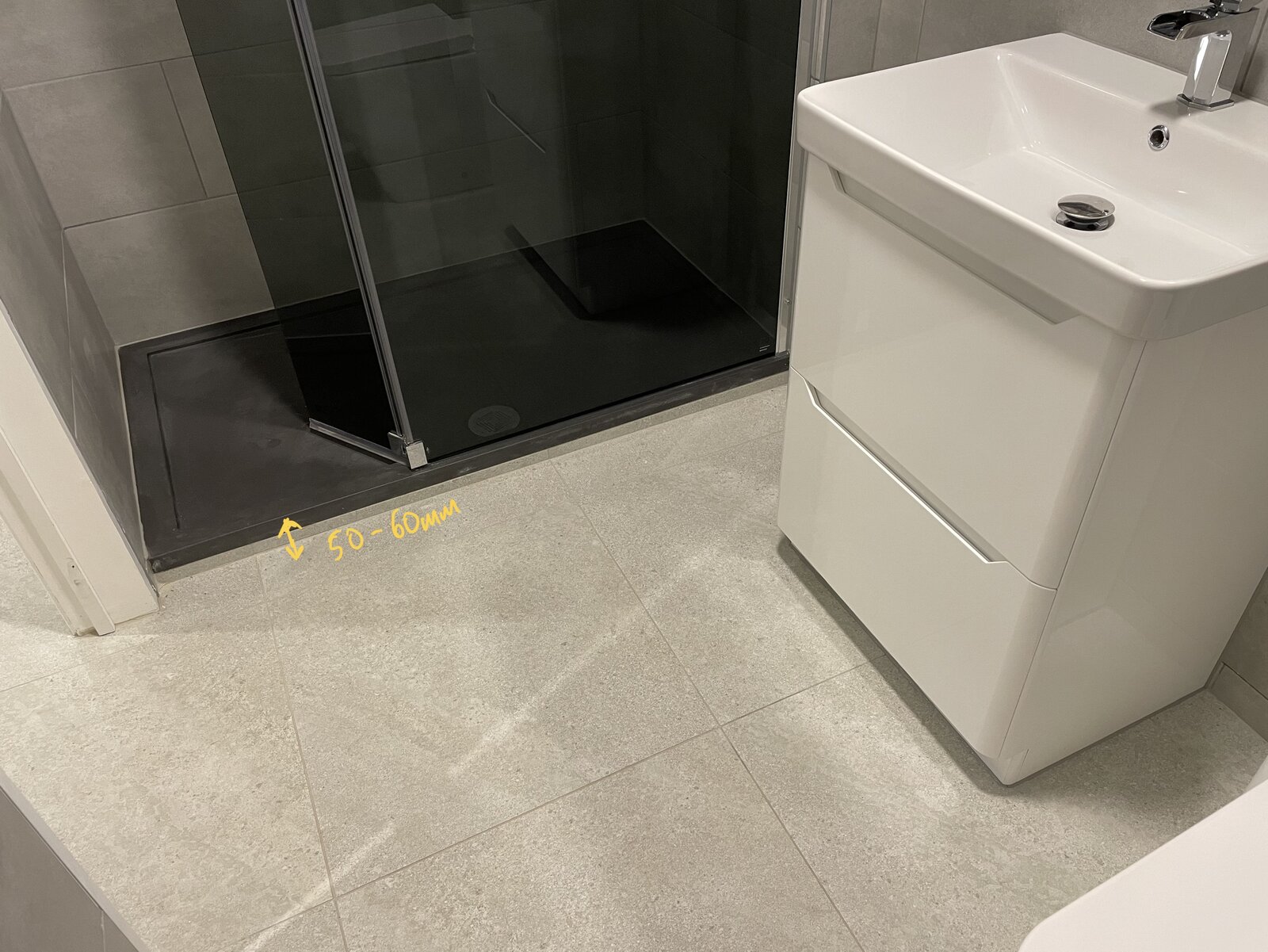

I’ve had a look at the main door sill (see photos) and the shower tray height from the tiles and determined that I have about 40mm to play with. The tiles with adhesive will be around 10-12mm. What would be the best course of action?
As you can see from the photos, I’m mega annoyed as the garage conversion otherwise looks pretty good. But this flooring is a major disaster…
Any advice much appreciated…

"it takes HOURS and HOURS"
Of course. It takes a 1.5kw kettle about a minute to increase the temperature of 1 litre of water by 20 degrees. A 15sqm room would draw about the same power (1.5kw) but that electric mat is bonded to about 600 litres of screed. If that were water it would take 10 hours to heat up by 20 degrees. The screed has a heat holding capacity that is about half what water is, so you're still looking at around five hours to lift the floor temp from eg 10 degrees to 30
It does however, take a long time to cool, and emits most of its heat into the room so basically, you should just leave it on on a thermostat all the time. Screed based UFH systems are NOT supposed to be blasted on and off like radiators. They're also not supposed to run at high temperatures - if you walk on the floor and think "gosh that feels nice and warm" then it's too hot- a screed pad at about 26-28 degrees will warm a well insulated room to 22 degrees but will not feel warm under your feet because your feet are between maybe 26 and 37 degrees depending on what you've been walking on. Even cold feet (26 degrees) walking on a 26 degree floor will not register it as warm
"builder laid 50mm kingspan type"
It's a bit low; kinda surprised your building inspector let him away with that one, 70mm probably more typical but under a UFH floor I'd have put 150mm personally. Bit late to change that now alas; get a builder more capable of thinking things through next time and advising you not to go for the absolute bare minimum bulding regs requires. Take solace however, that you saved a large amount of money on insulation that you can now spend on electric!
That said, if you leave the UFH on constantly then gradually the ground temp under the insulation will warm slightly and less heat will flow across the insulation, into the soil, so more heat will be lost into the room, warming the air
Make sure the rest of your room is well insulated and free from draughts and leave the floor on permanently on a decent thermostat designed for underfloor (one that can detect tiny changes in temperature so it can cycle on and off without letting the room cool more than maybe 0.3 degrees)
Or if you want to run your underfloor like your radiators, blasting it in morning and evening so it feels warm underfoot and having it switch off when you're out, proceed as your tiler said, and lay a new floor on top of the existing. I wouldn't
