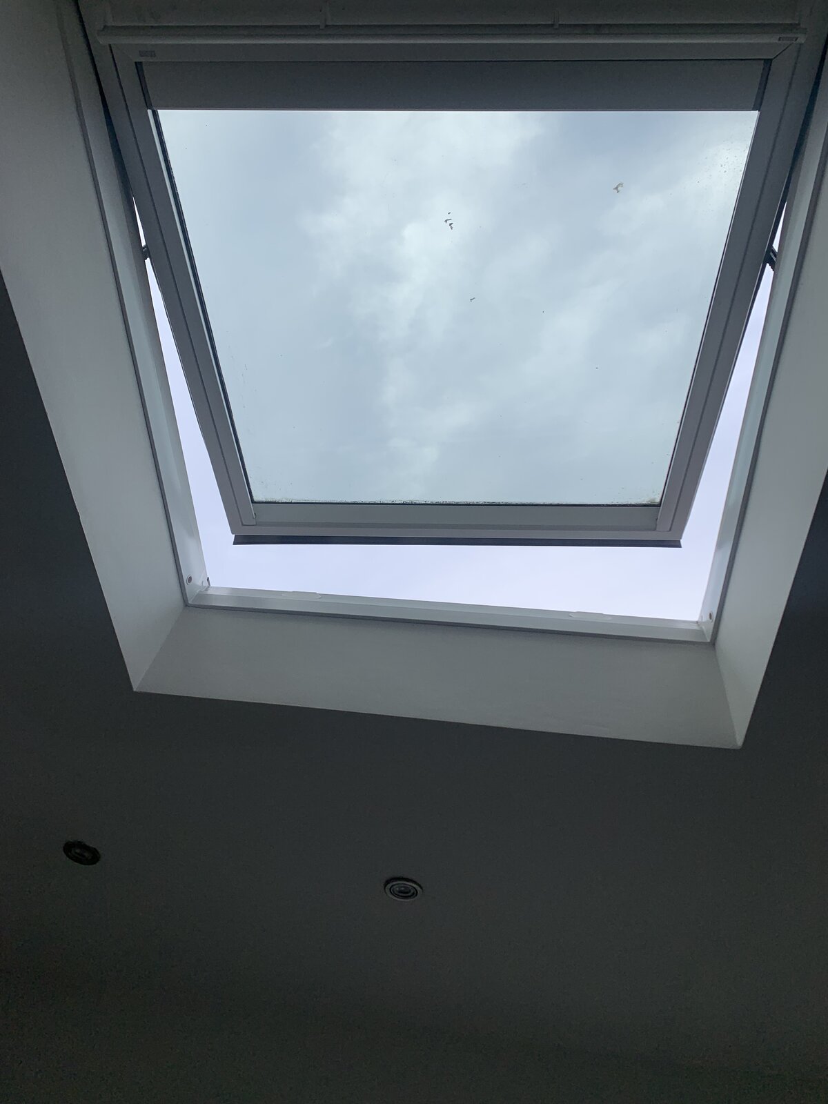

Hello All, We had a Velux gpu sk06 electric velux installed about 4 years ago. This was operating fine until this evening. The window remains open and the remote neither opens or closes. I have tried resetting the widow and when I press the reset on the window it makes a beeping sound after 10 secs to indicate its ready to be paired with the remote so there is power going to the unit. The priority at this stage it to close the window but I am unable to find any instructions on how this can be done manually. The control bar allows the window to be swung to the cleaning position but I can't figure out how to close the window. Given the current weather I'm really hoping someone can assist. Thanks

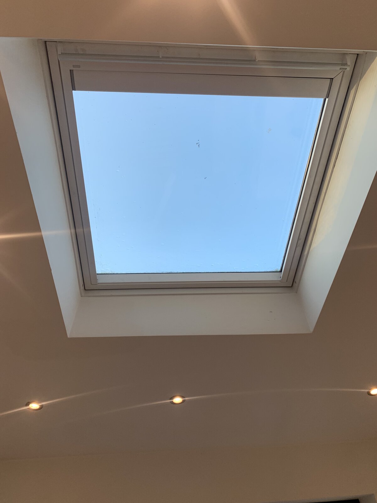

Just an update if anyone is in a similar situation, turns out the gas arm lift on the right had come away from its position and was preventing the windows from closing on that side.
Why that happened is hard to say, but it’s now back in place and the window electrics closed the it shut. I’ve attached before and after pics
