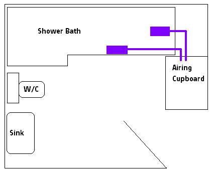

bathroom layout is as below, to me it makes perfect sense to run the flexes from the bath, through wall into the airing cupboard for connection rather than connect them under the bath where the FCUs cannot be accessed once panel in place
i hear you loud and clear re safety/inspection. the circuit used does not power the kitchen/high power devices and is protected by RCD at the consumer unit. i agree I am not in a position to test throughly but I would be confident making good connections. except for the bathroom aspect what is proposed is no different to using a fused 4 gang extention like under the tv only difference is it is hard wired in. an fcu is just a permanent connection without a plug at the end of the day is it not?
i don't want to sound harsh but in the course of my projects I have seen the signed off work performed by so called "competent persons" when my house was built by a major name builder 10 years ago (it is relatively unmodified by the previous owner). e.g. would you build a false wall out of plywood and tile straight onto it within a shower so you could fit a cheaper, smaller tray; would you fasten tiles with silicon/no more nails because you ran out of tile adhesive; would you run pipes through joists (correctly) or have long runs unsupported directly beneath the floor; would you have cabling directly beneath the P trap on a bath, etc? (this is what I have actually found, there could be more!)
so you can understand me garnering unbiased opinion as to what is required and whether I can do it myself first even if ultimately I may have to get someone to do it at least I will be confident to challenge them if I think it is wrong. as it happens now you have clarified re notification i will have to get the installation inspected/tested at the very least
You need to think carefully about this. If you decide that you want it all to be legal then you have to notify LABC in advance, submit your application for Building Regulations approval, and then follow their process for inspection and testing. You will not be able to comply with the law by DIYing and then getting an electrician to inspect and test it, no matter how good a job you do or how clean an I&T report you get.
thanks ban-all-sheds
understood re the notification, i should contact Building Control in advance to understand the process and costs involved. then i can weigh up the costs against a quote from a part p registered electrician.
