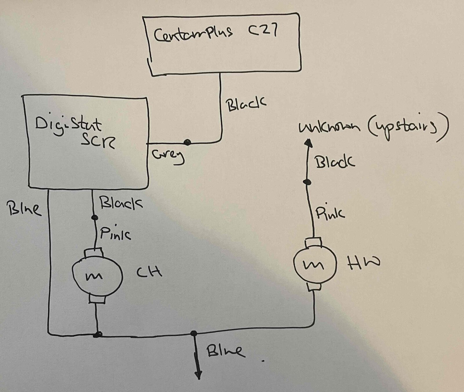

I have a Drayton wireless thermostat - it shows a wireless connection to the Digistat SCR. Has new batteries. Is calling for heat.
The Digistat SCR has a solid green light and the red light is off. Occasionally the red light flashes, I presume when receiving data from the thermostat.
I have a Centaurplus C27. Pressing the CH and HW buttons through the options I hear the relays clicking on and off.
The motor to the HW motorized valve has power on blue and pink (supposedly brown?) wires.
The motor to the CH motorized valve has power on blue but no power on pink.
The CH motorized value pink wire goes to the Digistat SCR.

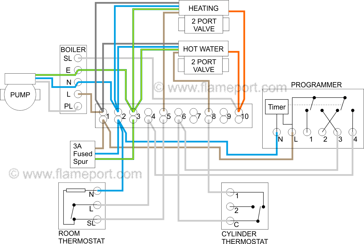

If you're happy testing 240V then if there is no power on the pink to the valve (that will be the live brown) then either the programmer isn't sending out a 240v Live call for heat or the stats receiver isn't passing that on to the valve. When the programmer is calling for CH then check for 240V at the receivers terminal 1. No power there then check the programmer.

Update: When I said there was no voltage on the pink wire to the CH valve I was expecting there to be voltage when the valve is opened. I now see that it is the other way around - I guess if there is a power cut the failsafe state is to open the valve.
So to confirm, I have 242V when value is closed and 0.17V when valve is opened, on the pink wire.
@CountryFan - it is easy to move and smooth action with my fingers. No effort required at all. I retightened all of the choc block terminals when I swapped the actuator, including the ones I didn't have to loosen to do the swap.
With demand calling, From the programmer to the room stat to the brown of the motorised valve should be 230/240vac between live and earth (so you’re testing correctly). This voltage should remain the same until demand has stopped.
OK I understand, my setup is reversed, but here I am just swapping like for like that has worked for years? So I am confused over this. I can see when I look at the actuator that the position of the slot changes, so it should move the valve when connected.

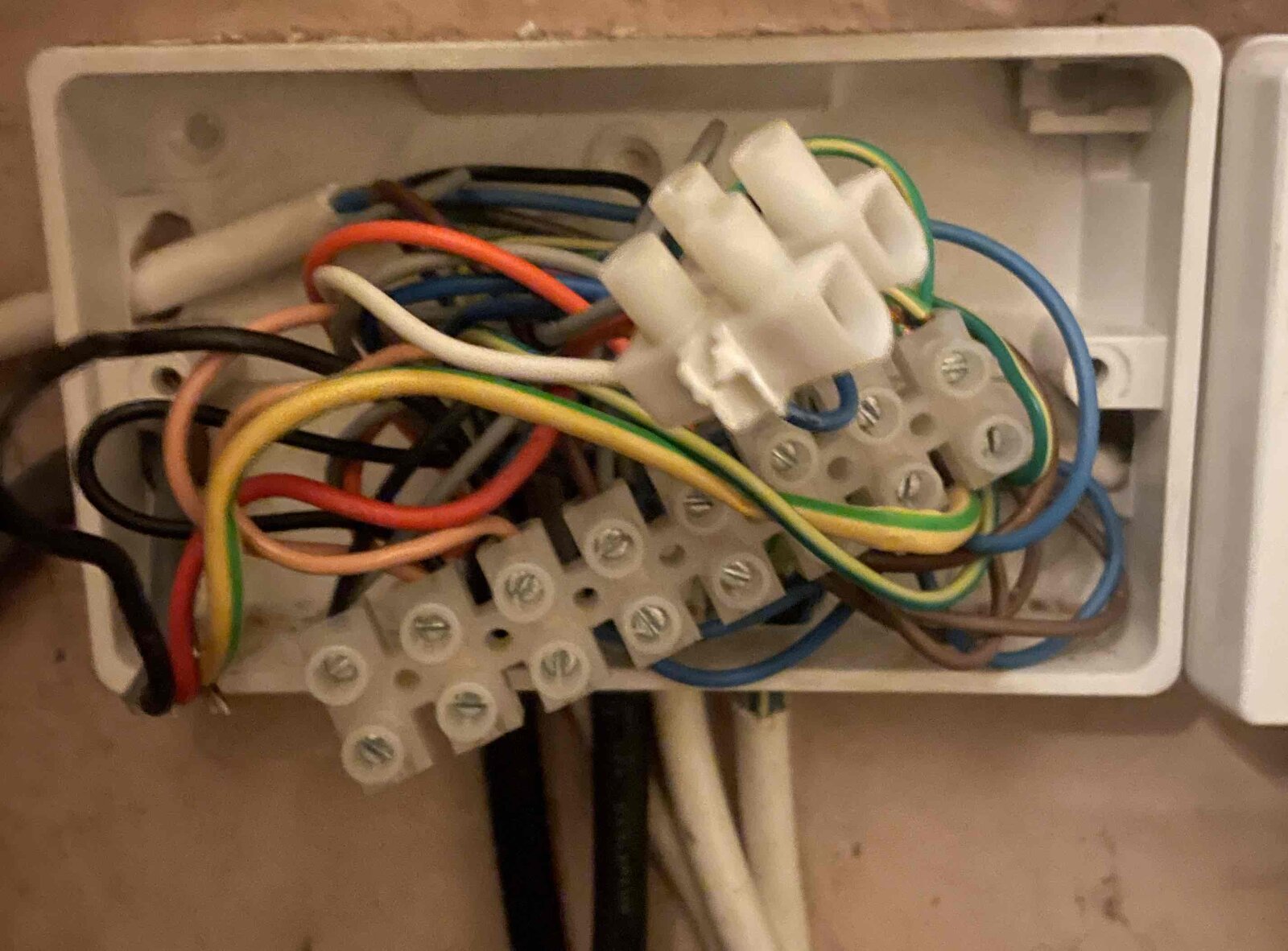

I haven't gotten as far as swapping the actuators yet, however I have just noticed that regardless of whether the valves are on or off, there is 242V AC on the neutral wrt earth. Oops. If I turn off power to the boiler/digitstat SCR/Centaurplus C27 then it is zero volts, so it isn't a fault in the house but in this system.
So with the CH valve open (microswitch pressed) there is 0V on live, 242V on neutral, the motor is energized because it is warm to the touch, I presume from the voltage differential.
240v @ the neutral for the CH valve? Well, obviously there shouldn't be 240v on the neutral and that wouldn't usually be internal to the head, unless there's a short in there of course.
Cant really tell from the photo but I'd be checking back at the wiring centre to start with but be careful, check and confirm the wiring colours line up properly with the system powered down, as there is a real danger of critical damage if the wiring's wrong or crossed.
