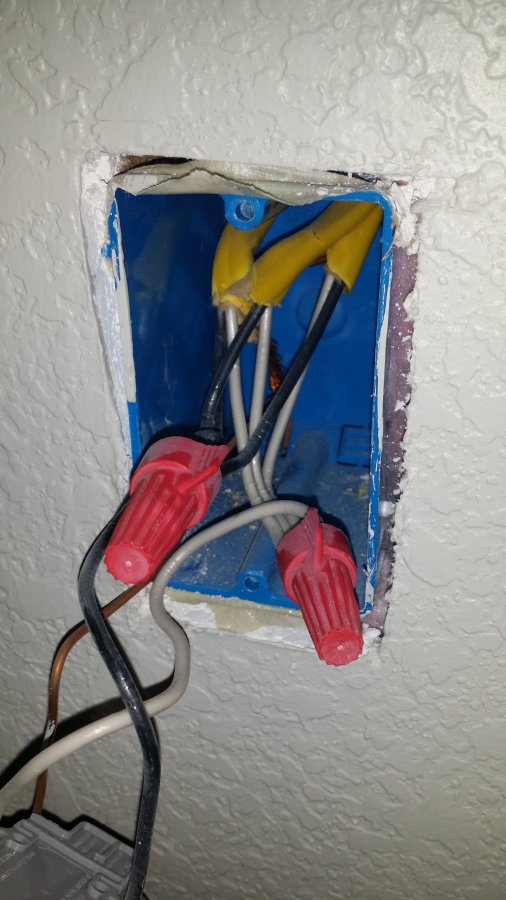

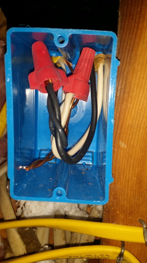

My Electrician made a mistake and I need assistance verifying the damage.
Environment:
A. Kitchen and Garage Remodel.
B. Range being changed from electric to gas.
C. Circuit Breaker 7/8 220vac Oven.
D. Circuit Breaker 31 120vac GFCI many outlets. (master bath, outdoor sockets,..)
E. Circuit Breaker 33/34 220vac to Pool Equip SubPanel.
Objectives and Request:
1. Electric Oven 220vac Circuit (breaker 7/8) no longer needed.
2. Two Garage GFCI 120vac Sockets (on breaker 31) were tripping too often with power tools(table saw etc), also since it is shared with 3 Master Bath sockets, and 2 exterior porch sockets. Request to have 2 garage sockets get own circuit.
Wiring:
3. Picture 1 - new attic Junction Box with original white 10 gauge 220vac coming in, yellow 12 gauge 220vac going out. (mistake 1, should be 10-2)
4. Picture 2 - Existing Garage Socket Junction Box - 3 wires coming in, 4 twisted together. (mistake 2, did not disconnect 31 wires)
5. Picture 3 - Garage Socket Junction Box - 3 wires coming in, 4 twisted together. (mistake 2, did not disconnect 31 wires)
Events and Problems:
a. Circuit Breaker 7/8 off. Everything fine.
b. Action: Circuit Breaker 7/8 turned on.
c. Result 1: Circuit 31 flips off.
d. Result 2: Pool Pump and hot tub not working. (in a subpanel off 33/34)
e. Examine 1: Subpanel breaker for Hot Tub had flipped off. Turned on, all well.
f. Examine 2: Pool Pump dead, verified 220vac (also verified each pole separate for 120 good)
g. With 31/32 off, 7/8 on, I have 120vac in Master Bath sockets and Garage Sockets.
h. With 31/32 on, 7/8 off I have 120vac in Master Bath sockets and Garage Sockets.
Solution: Disconnect existing 31 wire coming into one of the garage sockets, and somehow verify only getting on pole/leg?
Question #1: How to get only 1 pole/leg for that socket? (I would first un-nut all wires at garage sockets, kill 31. 7/8 on. ID 7/8 coming to sockets. Then?)
Question #2: How come I only get 120vac at sockets with 7/8 on, 31 off?
Big Big Key Question #3: Did electrician blow my pool pump? If so, how? He claims impossible.

As I understand it, what was supposed to have happened was that two of the existing garage receptacles on a shared GFCI circuit with many others were to have been moved onto a new circuit, which was to be fed in part using a now-spare cable which was formerly feeding an electric oven.
It's not clear from the original description, but presumably the oven circuit was a straight 2-wire 240V 30A circuit as it was wired with 10-2 cable. There would be nothing wrong with using this cable for a new 120V 15 or 20A circuit (extended with 14-2 or 12-2 minimum respectively) to regular 120V receptacles, so long as the original 30A double-pole breaker were replaced with the appropriate single-pole 15 or 20A type, and the white wire of the 10-2 moved over to the neutral bus.
Whatever existing circuit was running to the two outlets concerned would need to be disconnected from them. Depending upon the physical arrangement of cables, that might mean simply disconnecting at some other point, or leaving the circuit running through the existing boxes but isolated from the receptacles and the new wiring.
It sounds as though this "electrician" has run in new wiring but somehow tied everything together with the existing circuit. And it so happens that the original circuit to those receptacles and the new one are on opposite poles of the supply, which in some ways was a good thing, otherwise you might never have realized that he had two breakers paralleled via the cross-connection and would have been left with insufficient overcurrent protection on the wiring.
As for the pool pump, the issue would be whether or not he disturbed any of the wiring on the feeder to the pool sub-panel. If he did not, then the cross-connection between the other circuits wouldn't have had any effect. If he'd lifted the neutral from the pool panel sub-feeder and connected it to a hot line by mistake, then most certainly it could burn out things, since some 120V branch circuits on the sub-panel would then be receiving 240V. Or indeed if he'd just lifted it from the neutral and applied power to the sub-feeder it could cause excess voltage on one side of the panel, depending upon the loads connected at the time.
There's absolutely no reason why he should have done anything with the sub-feeder wirng to carry out the other task, but given the mess he's obviously made of the job, who knows what he might have done?
