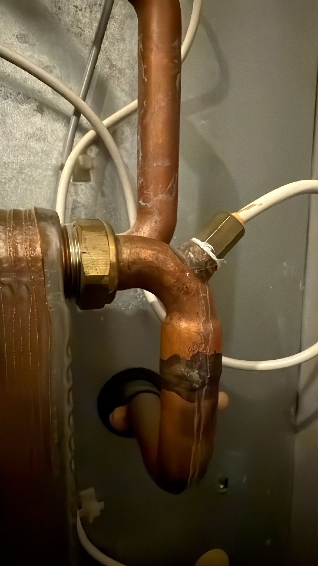

A friend had a pinhole leak on a heating pipe it was a very fine line shooting out about 1 foot and in a really awkward spot right on a T junction.
I tried to do a temp repair with some quite old self amalgamating tape but the leak kept finding its way out of the wrapping, I dont know if it was because it was old tape or not working well under the constant stream of water.
I have done a quick google and there are a lot of options available that say they can fix, like 2 part putty, self amalgamating tape, butyl rubber tape but which one or two should I get in readiness for a future leak to fix until a proper plumber can come do a repair.

Self amalgamating tape wont do it. It's meant to keep water out of a joint, something like rain and it doesn't do that particularly well, neither will any of the other gunky things at mains pressure unless they go off almost immediately. You need to use something like Tricky Dicky's suggestion.

Thanks - I now have a photo. if you look carefully you can see a very fine line from X marks the spot
They say the plumber is going to try and find the part but it looks custom made to me with the sensor soldered on. The system is 20-26 years old.
It might be possible to drain the part down, clean the area till bright, flux it, warm it (carefully!) and apply solder. I did a rad with a very small leak that way about 50 years ago and it's still OK.
