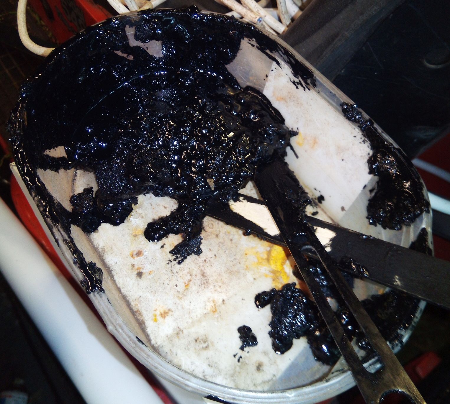

I have a theory on this...
A lightly-loaded diesel engine, never sees much airflow through its inlet tract - turbo, induction hoses, intercooler, inlet manifold. Oil mist enters this tract - usually from the crankcase breather, but in later life, some also gets past the turbo oil seals. It condenses on the colder walls of the inlet tract. During periods of maximum power operation, the high air flow rate through the inlet tract "scours" the oil film off the walls of the pipes (there are many of them in the intercooler, remember) and drags it into the cylinders where it is burned.
However, if the car is never operated at maximum power, this oil just keeps building up. On top of that, you have Mottie's point about the EGR valve, which periodically opens to admit exhaust gas. This can partially burn the oily deposits into sooty gunge, downstream of the EGR valve - which just further clogs everything up.
If that theory is right, (and that's the cause), nothing that you put in your fuel tank will help. You will need to either operate it at maximum power (difficult without losing your licence! Do you have a heavy trailer you can tow up a long hill a few times?) or you'll need to clean out the whole inlet tract. By "operate at maximum power", I mean about 4000 RPM for several minutes with the accelerator pedal on the floor. You can't just do it in neutral, because there won't be as much air flowing through the tubes. The turbo has to be at maximum boost pressure. (Several shorter periods are acceptable). Long up-hill stretches are your best bet. If it's working, it should smoke like a destroyer being pursued by a battleship the first few times, then gradually less.
My sister gave me her old Freelander that she was going to scrap because it failed an MOT on massive smoke. She hates revving it - she thinks it "hurts" them. Here is the result:
And that was the SECOND ice cream tub of gunge that I scraped out of her inlet manifold! (I didn't take a photo of the first one).
Emissions went down from abut 3.5 to 0.98 after that.
Diesels driven hard, rarely seem to suffer from this.
However, if the problem is one (or more) injectors, then the fuel additives will help. Everyone has their favourite potions. Forte and Stanadyne are popular with some taxi drivers I know. I like BG244 (mainly for the smell)!
Regarding oil changes, all the oil rarely comes out of an engine during an oil change, so topping up with the theoretical "new engine" factory figure, is likely to result in a small over-fill - which certainly won't help, so double-check it on the dipstick.
