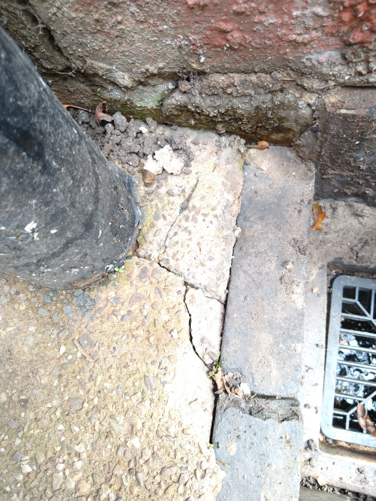

    Hi,
    I was hoping to install an engineered wooden floor but the instructions state the floorboards should have have a moisture reading of no more than 14%. Most of the downstairs is fine but our hallway floor reads 18%
    Am I stuffed? can anything be done?

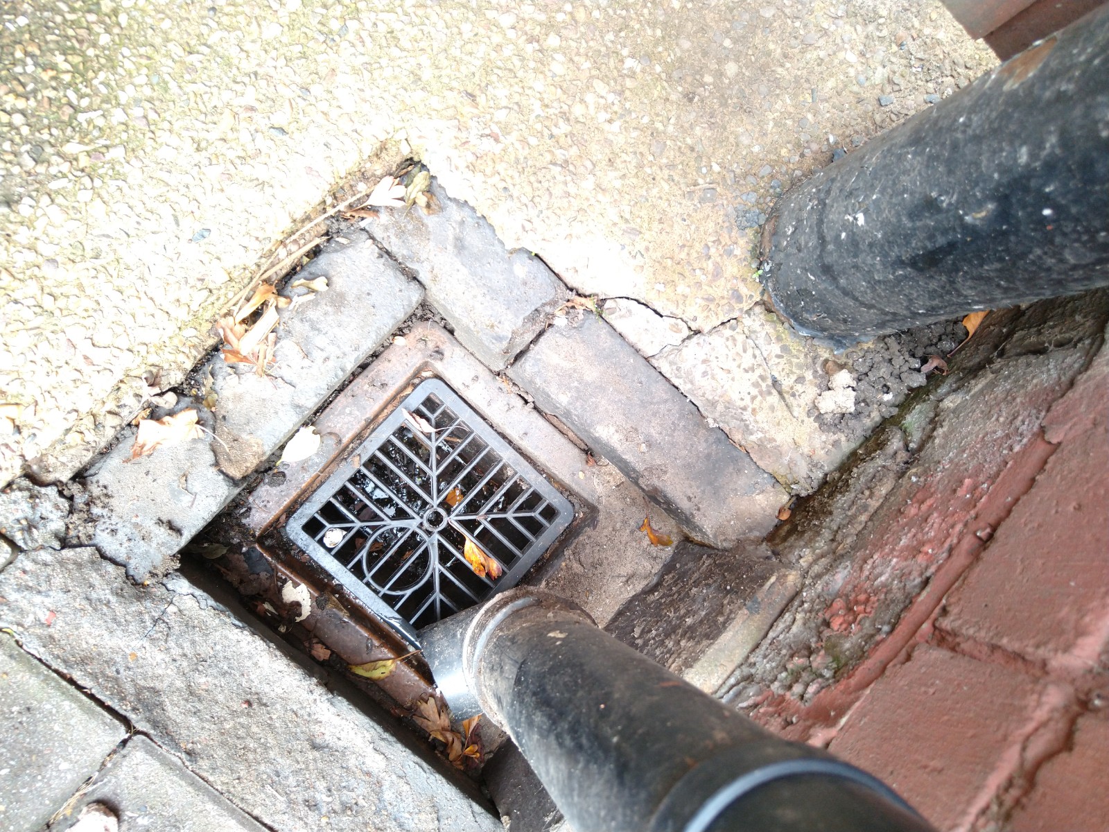

    On further inspection the dirt under the joists does feel a little moist next to the drain. I guess this would point a drain issue.
    Kinda wished I hadn't looked now hehe

    please photograph this drain, including the ground, paving or concrete around it, and especially any signs of repair, patching, cracking or sinking.

    Drain and soil pipe
