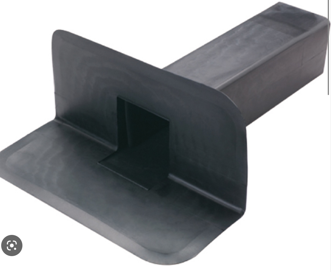

Any details on how they run the drains through parapet walls to downpipes? Ive been told it's lead flashing but there isn't any and the roofer comes today to lay epdm roof. I found a pic of some lead flashing i guess this has got to go in first?
Or they install this after over the top or this sits underneath also?
