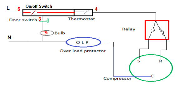

Essentially Dead Beko Fridge?
Obviously (the interior light), suggest the problem is something towards the mains input side of the fridge - failing mains cable, fuse, 13 amp plug/socket. ...
That's what one would think, but it's very hard to see how that could be intermittent in the fashion I'm experiencing.
Beyond that - I would be tapping into various points on the circuit, taking them out to a terminal strip for easy access, then a neon indicator or two would soon track down where it is failing.
Yes, that's what I'm going to have to do but, as I said, it's easier said than done - due to a problem of physical access and most of the connections being via insulated push-on connectors. However, as we've both said, if/when I can manage to do that, it should be child's play to at least determine what is happening electrically.

"and, in any event, find it hard to see how 'getting the connections to the thermostat wrong' could, in itself, affect the light."
I agree now that you have told us that turning the stat up/down did not turn the compressor on/off ( at least that is what I think you were saying ) but if you meant it did not turn it back on then having the light connected to the o/p would stop it illuminating if the stat did not close. Perhaps you need to swap the old one back to eliminate at least one of the faults.
Gut feeling is still the neutral breaking down somewhere.

Maybe I was not clear enough ...
Essentially, changing the setting of the stat changes nothing (but there may possibly be a development - see below!). If the compressor is in its off state (and light not working), then no amount of playing with the stat setting will cause the compressor (and light) to come back on. Similarly, if the compressor IS running (and light working when door is opened) turning the stat setting 'down' (set for higher temp) does not make the compressor stop (** but see below) - that didn't surprise me since I would not have expected that to happen even with the stat at its lowest ('warmest') setting, given the temps that the fridge is currently running at. If I turn the stat to its "off" position ("0" - which it goes to 'with a click'), the compressor stops, but the light continues working, but turning the stat back up (to colder temp) does not cause the compressor to immediately re-start (that usually happens a few minutes later).
** this may just be a coincidence, but the last time I tried turning the stat 'down' (to warmer temp) when the compressor was running (and light working), the compressor DID stop when I turned it down to the lowest (warmest) setting, but the light remained ON - confusing me even more.

An update, for anyone interested ...
'Touching wood', I think I now, at last, have a properly functioning fridge again. It seems that Murphy's Law was working quite well (never assume trhat unused replacement component are 'OK'!). To summarise the important bottom lines ...
The original thermostat was certainly malfunctioning and I suspect that was the (only) original problem (i.e. my replacing the start 'relay' and 'overload protector' was probably unnecessary). I'm not going to throw it out yet, since it's quite possible that it will respond to 'adjustment', as below.
However, the replacement thermostat (brand new, albeit 6 years ago, and unused) was drastically out of calibration - with it on its coldest setting, it was opening at 10°-11°. It is adjustable (very sensitive) and when I played around with that (a large adjustment was needed - a number of turns of the screw, not just a 'tweak') I eventually got it to roughly the temperature range I wanted (having, ironically, initially got the fridge 'far too cold'!).
It turns out that the 'interior light issue was a red herring, caused by an error on my part. Although I initially connected the replacement stat in exactly the same way as the original (and have photographic evidence to prove that!), at some point during my playing I somehow managed to get two of the connections (labelled "6" and "4" in diagram below) swapped around. Although this did not effect the thermostatic temperature control, as can be seen, it did ('correctly') result in the light being disabled when the (mis-calibrated) stat turned the compressor off. Below is a slightly modified version of the diagram I posted earlier in the thread, illustrating the situation as it exists in my fridge.
So, if it carries on working, I'm seemingly at long last back to having a working fridge without having suffered any cost (other than the loss of a lot of 'leisure time' :) ) beyond the investment in spares that I made 6 years ago (and, as above, I think only one of them was actually needed).
