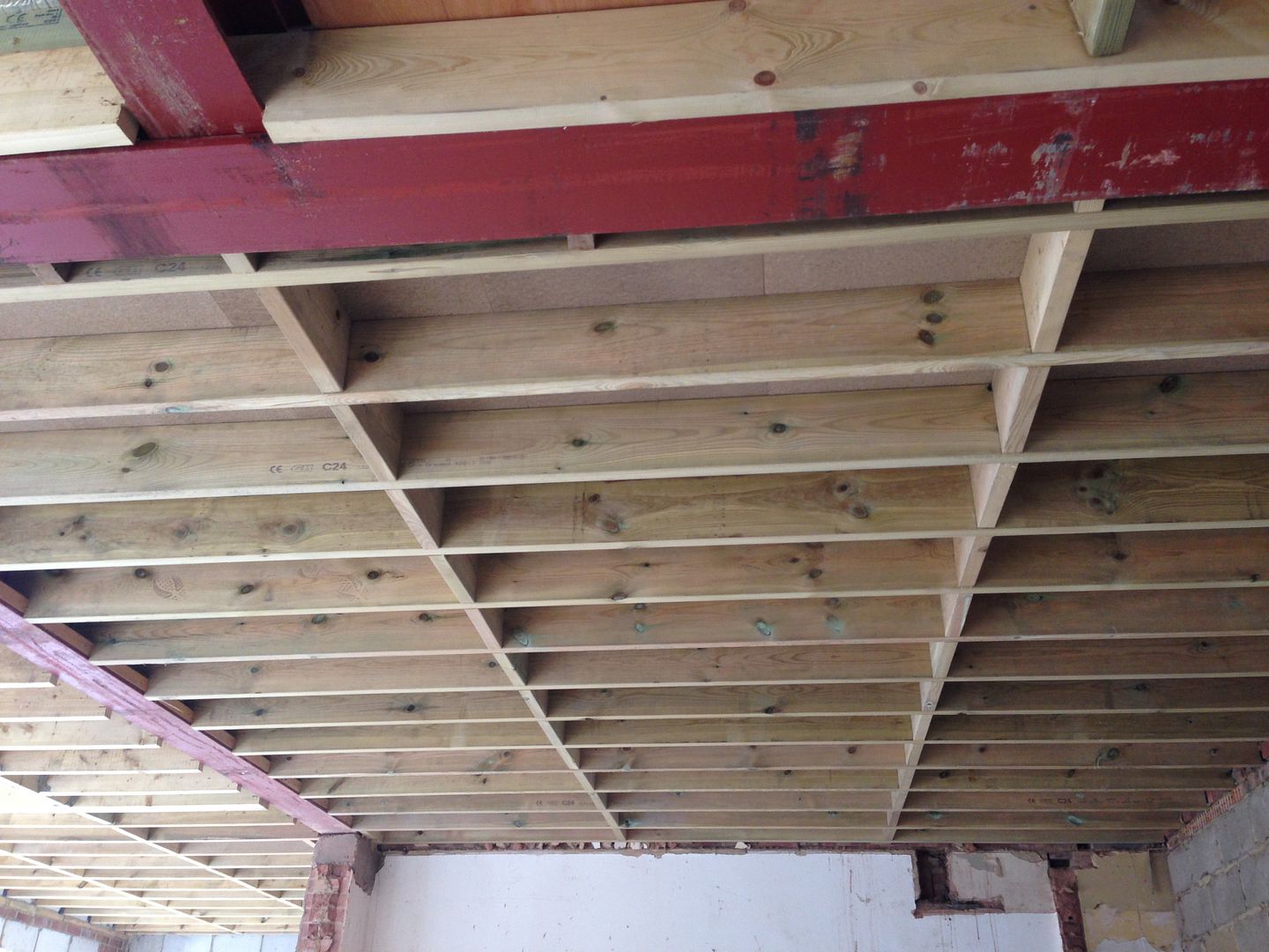

And underneath the boards, before any sound insulation slabs and ground floor ceiling goes in, this is what it currently looks like.
The beam to the left is where the bedroom above's bay window is and the top beam is between two rooms. Are the noggins sufficient?
