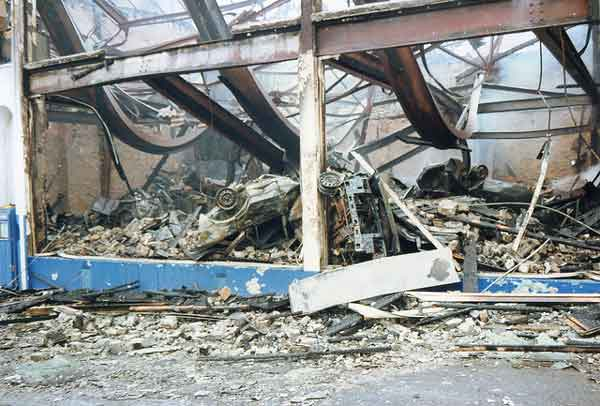

This is what can happen if you don't adequately protect your beams from fire! :eek:
This was a massive blaze at a car showroom. Walking past the aftermath of this with cars literally melted around drooped beams was truly a memorable sight to behold!
Thanks RandomGrinch, however fireboard isn't going to stop that from happening, my understanding is it gives resistance to the fire but eventually will penetrate.
