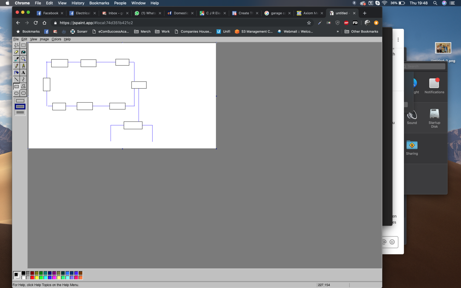

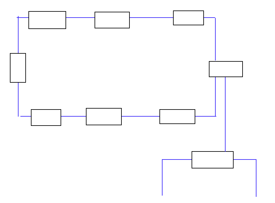

Looks like when they did the kitchen, the original socket backed out to the spur. Since then, they've moved the socket to the side of where the spur goes through the wall so won't be able to pull the old cable out or use the existing hole.
Guess i'll just have to drill straight through the back of the socket
Separate the wires in your the kitchen s/o, and test for continuity, the pair with continuity are the kitchen ring circuit, and the one without continuity is the feed to the garage.
Ah that'd make sense. Best dig out my multimeter!
