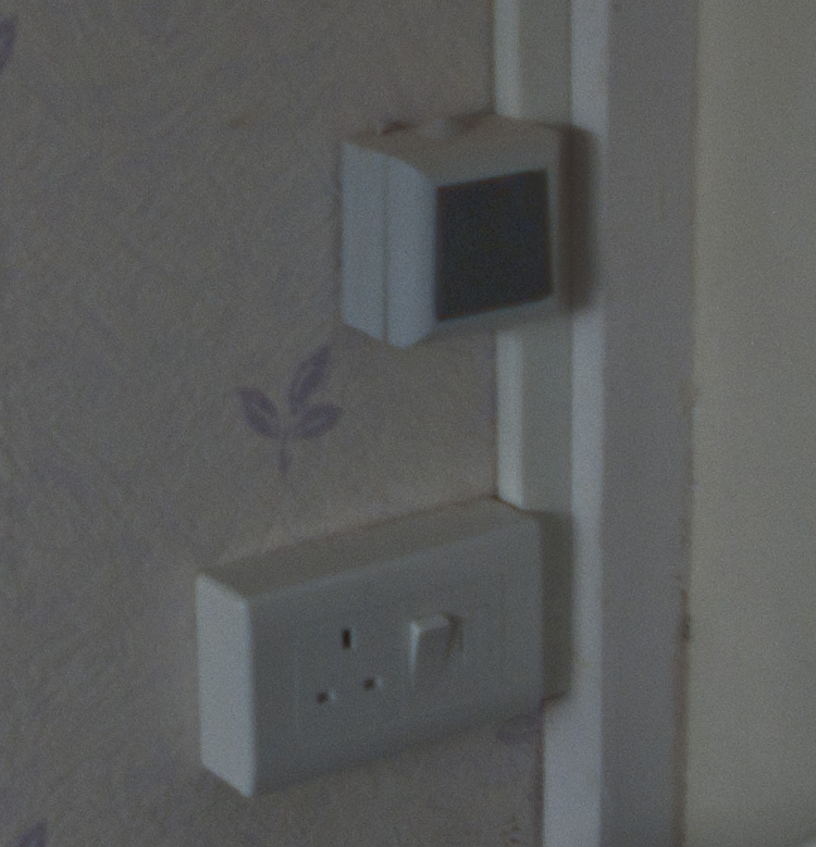

I had same problem with mothers house, I used a fuse IMGP7387.jpg swapped double socket for socket fuse and switch.
