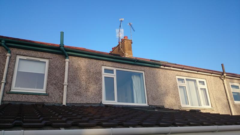

Can you post a photo of the roof?

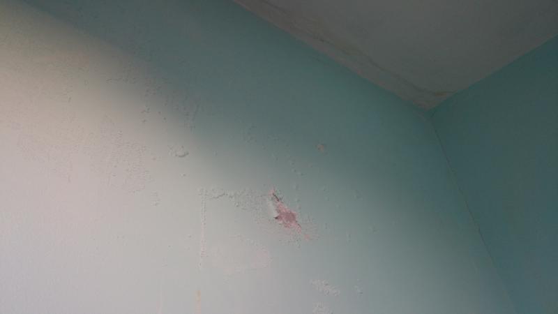

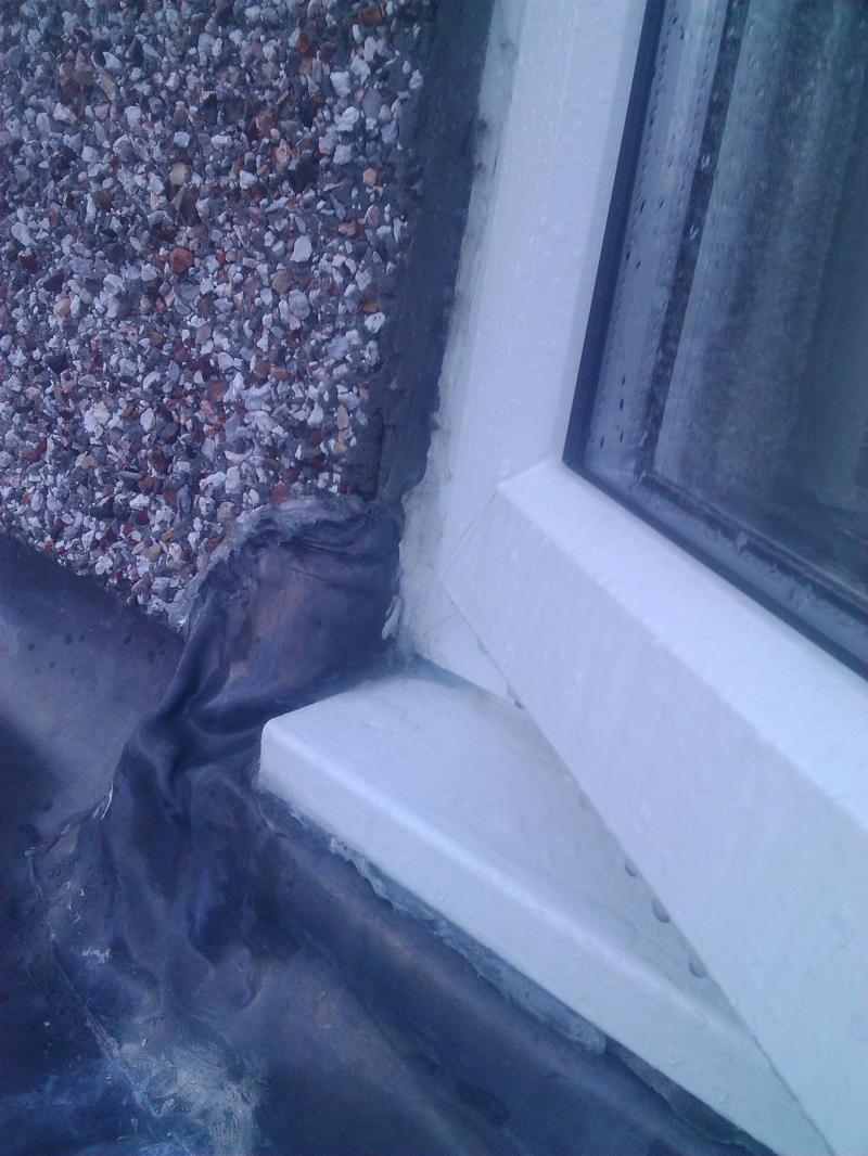

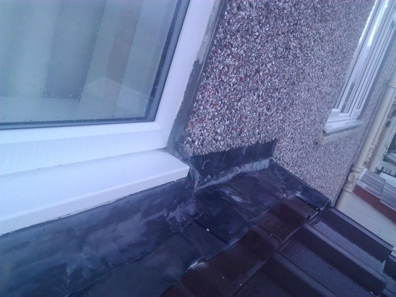

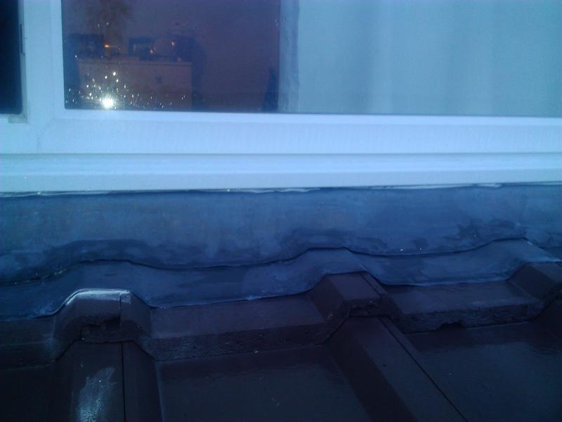

HI thanks for the responses, now that it's better weather I've managed to take some pictures. As you can see the flashing under the window is just siliconed at the sides. The thing you can see under the Upvc cill is some material the builders stuffed in there after calling them out to do something about the water pouring in. The inside picture to show the water damage with paint peeling over a metre down from the roof line.

Hopefully this will help you understand the arrangement. As mentioned previously the only fixing holding the window at the bottom is a single 4 inch screw that goes through the frame, then into the flashing, they only added this after I commented on it moving. And the lower layer of lead just lies flat on the tiles, no turning up under the upper layer.

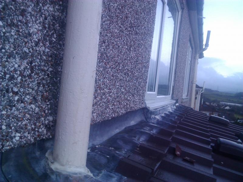

PS you also see the lots of sealant slopped round the soil pipe,
Amateurish at best.
We would have renewed that section of SVP in plastic as well, prior to building the roof. We would have then slid a pitched multi-slate over the SVP and done it properly.
Seeing as you are in a high risk wind area, that flashing abutment is pants. We would have considered a less deep window or a recessed box flattie so that the area under the sill could have been done properly.
Overall, in a location that commanded a lot of attention to detail, you have ended up with a flashing abutment that has been afforded very little.
