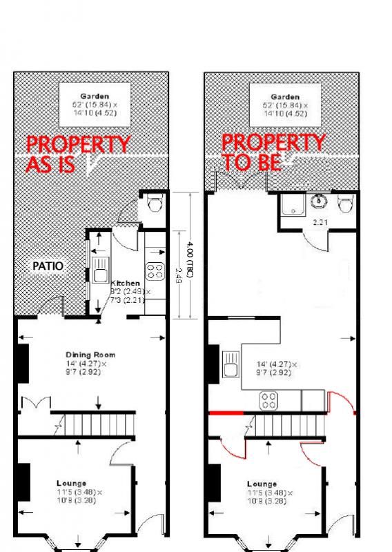

Our plan is to build an extension to our new house - a late Victorian terraced in the New Malden/Kingston area - but we haven't yet involved any contractor because we cannot make up our minds as to the best course of action...
Our overall budget is relatively limited (£30-40K) and there are other alterations that we'd like to see happening first. I've attached a basic plan to give you an idea of what we'd like to achieve.
I've split the work into phases to minimise risks and disruption - and to manage our budget...

--> QUESTION: do I need BR approval for the new plumbing and to convert the existing dining room suspended floor into a concrete floor (which we would like)?
Phase 2 (possibly to be combined with phase 3)
Convert old kitchen into dining area and extend cloakroom as indicated in attached plan.
--> QUESTION: do I need an RSJ even if I only replace the existing windows with French doors if we don't proceed with phase 3?

Sorry I can't give a suitable answer on the floor question but I would suspect that BR is required to ensure that you comply with DPM and insulation, etc. If you have plans drawn already for permission why not mention it as part of the overall application?
I have no idea on costs either.
The only contribution I would make is to consider making phase 3 into phase 2. I assume that a) the kitchen is a single storey and b) you have an upstairs bathroom so the shower urgency is not an issue. Therefore complete the new perimeter walls, floor, roof, openings as phase 2. It's then weather-proof and secure. With care it's easy to close off the building area from the rest of the house by removing the wall between new kitchen and new dining area after the new work is weather-proof and secure. You don't need to insert any new temporary RSJ/french windows into the existing walls. You can then complete the internal at your leisure.
That new kitchen is going to lack natural daylight though.
What is up with the suspended floor? It it's ok then why the hassle?
It may be uninsulated under the floorboards so adding insulation between the joists may be wise, plus adding some additional supports if there is any 'bounce' . Also maintain airbricks and possibly add ventilation pipes in any new solid floor is going at the back. All very cheap jobs compared to pouring a new insulated concrete floor. If it ain't broke.........

We're now thinking of combining phase 2 and 3, partly because we've found an example of costs breakdown (http://www.extensions.mitehart.com/html/extension_cost_guide.html), adapted it to our plans and found that the difference in costs is not huge whether we do the two phases together or not.
