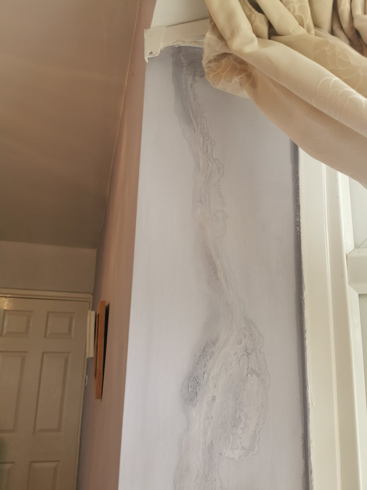

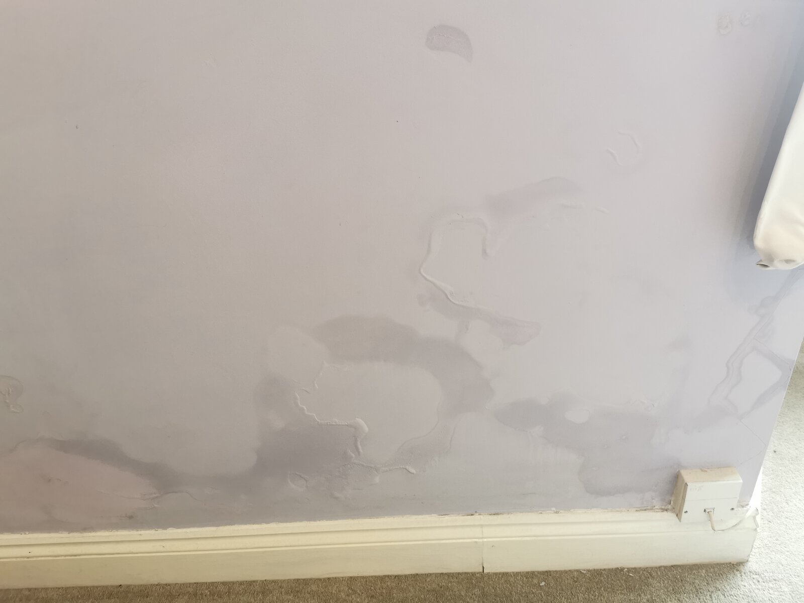

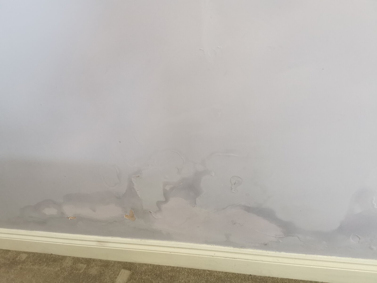

Exterior inside wall treated for rising damp. Scammed? 12 months until decorate?

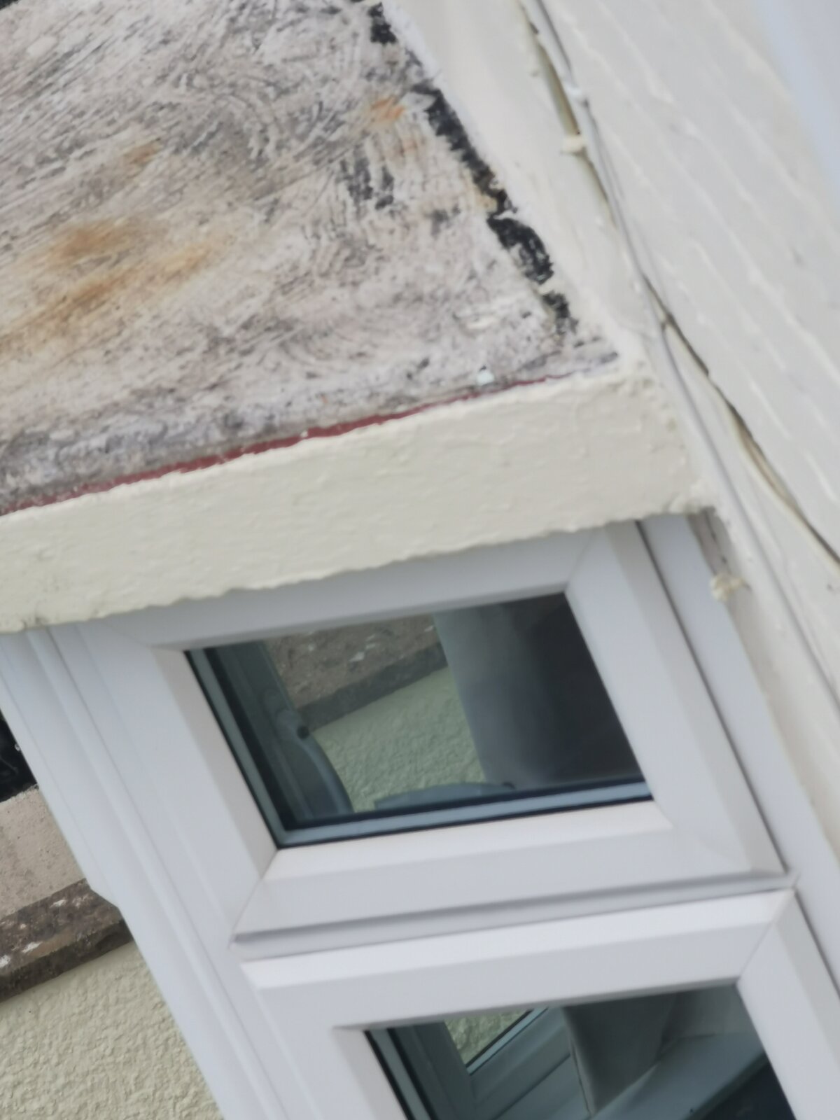

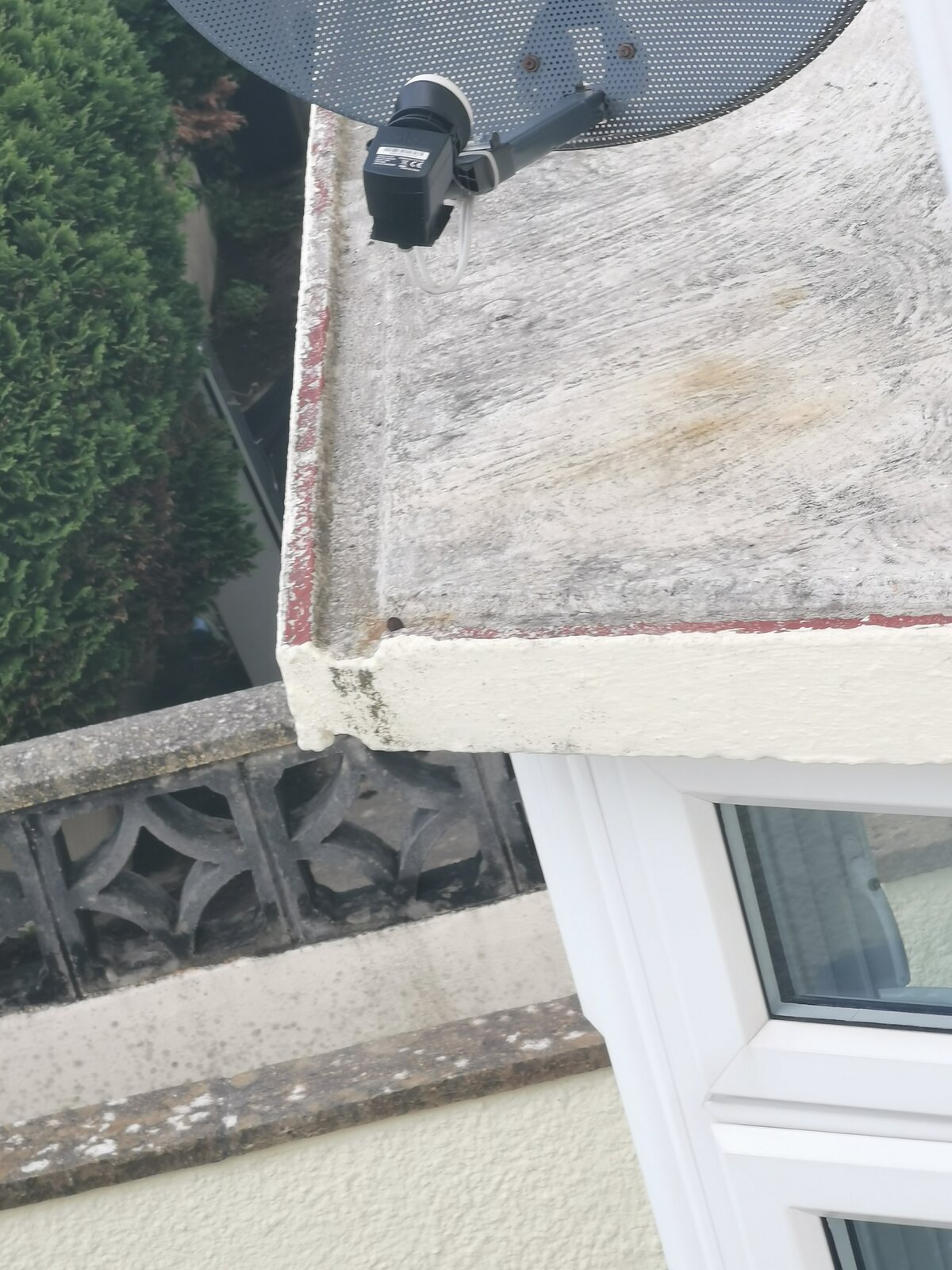

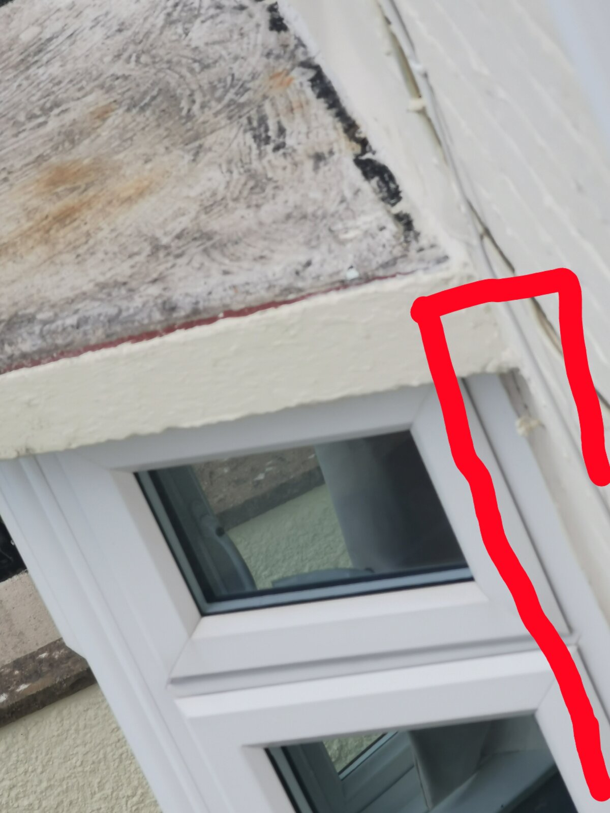

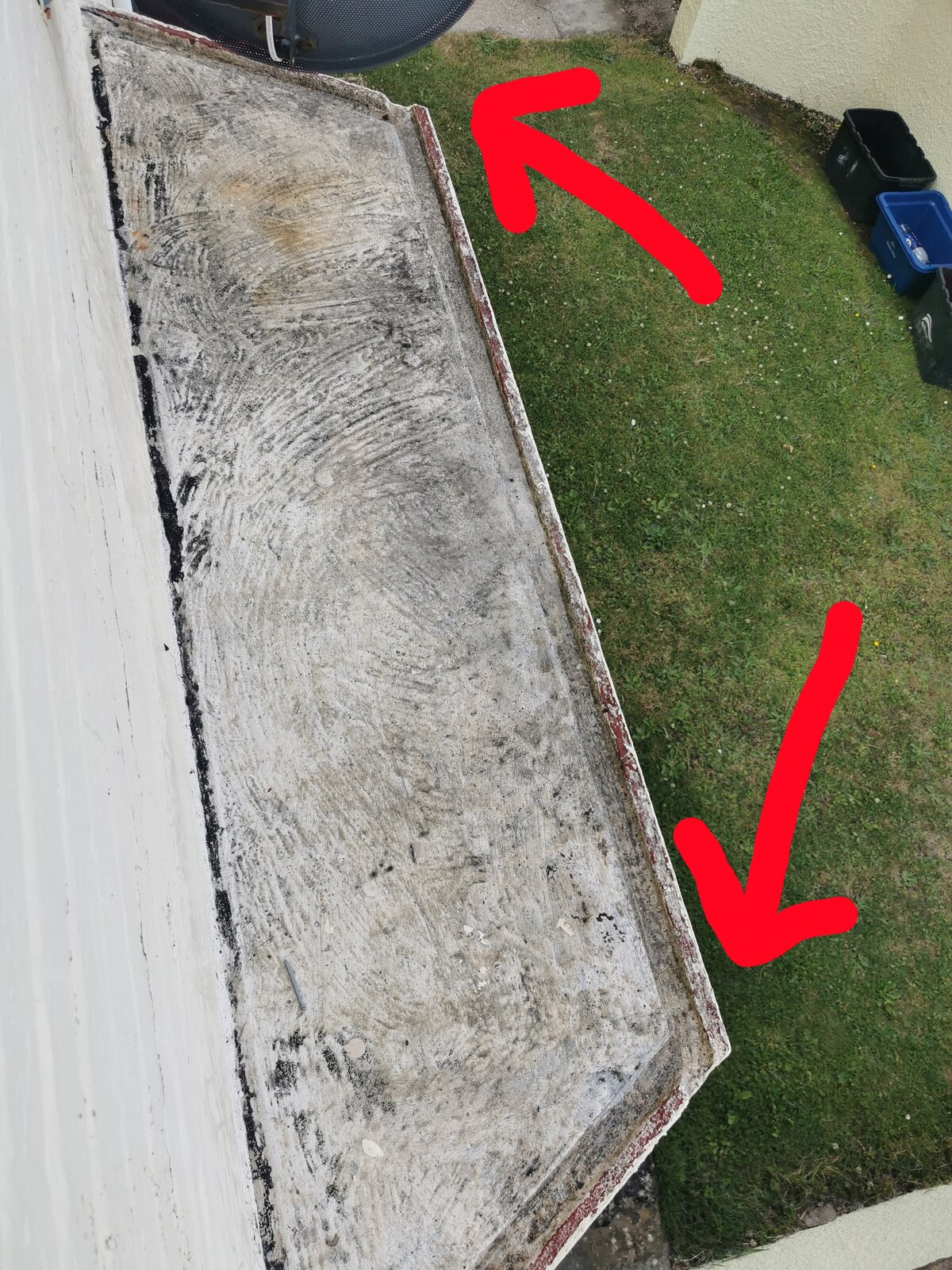

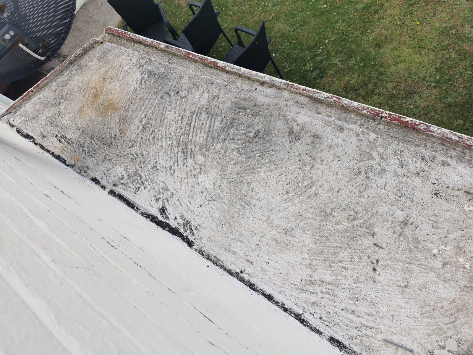

Also, 2 pics of the top of the bay window as requested.

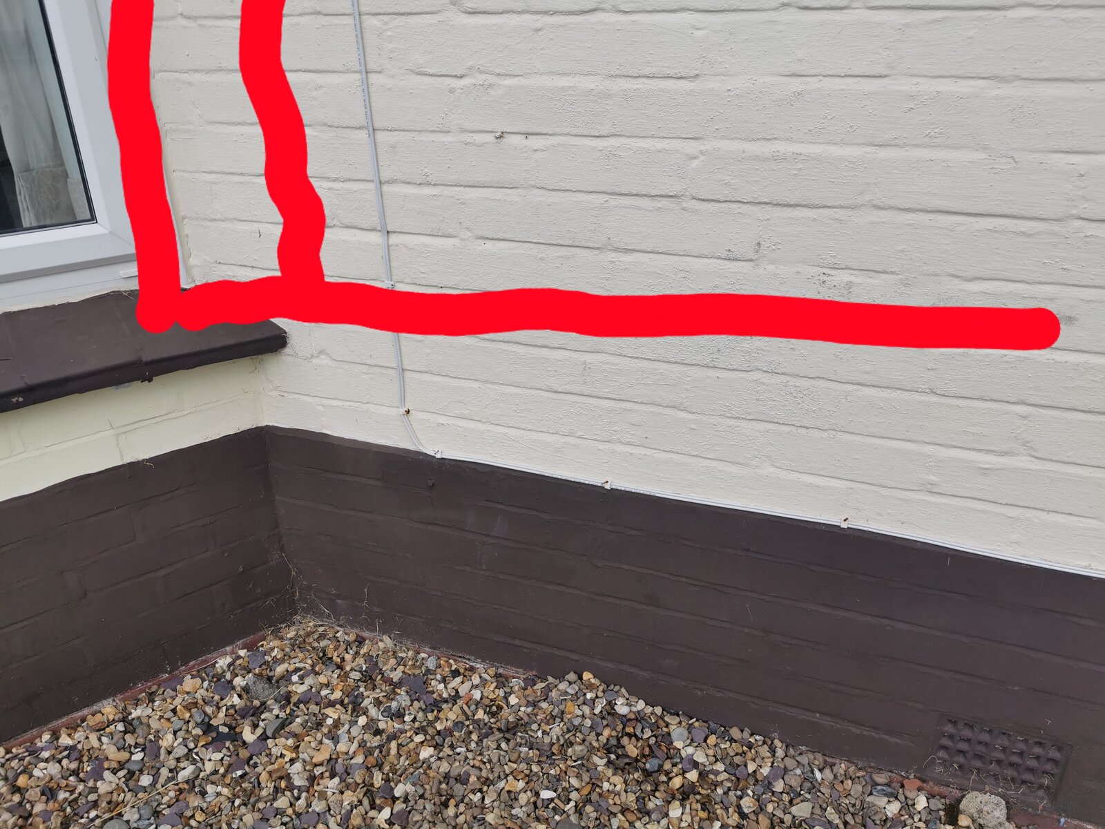

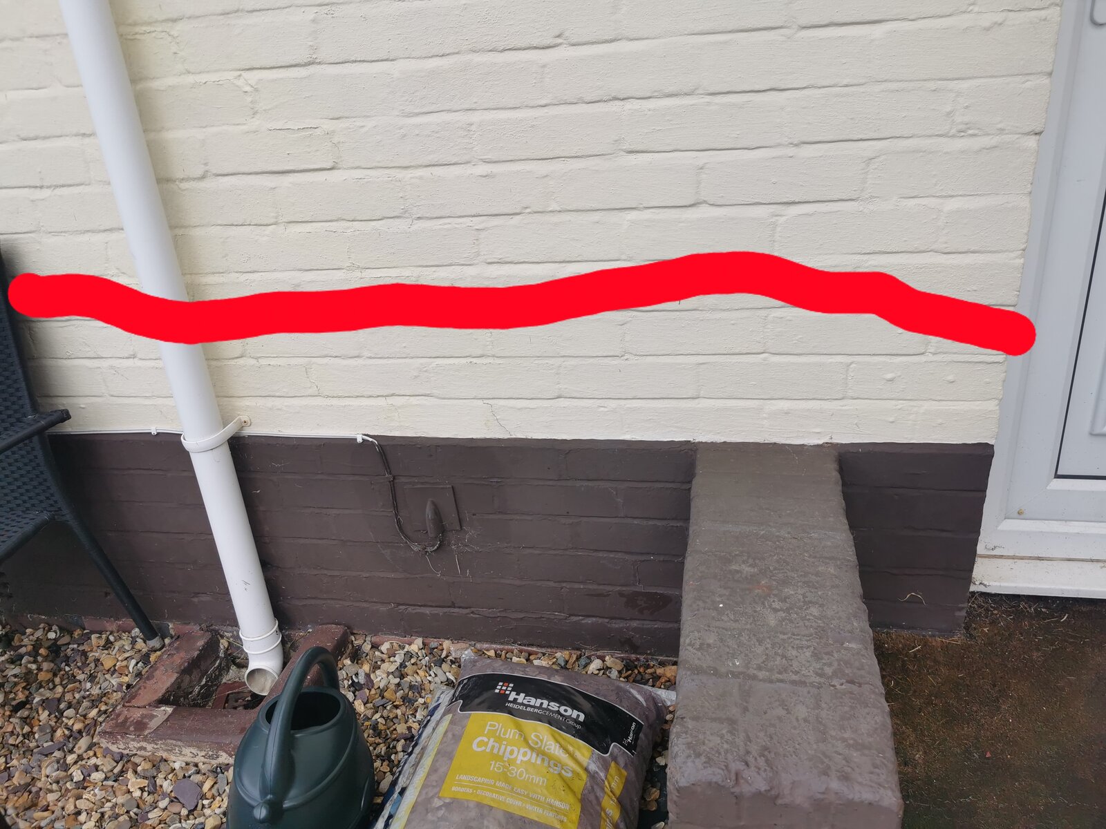

Do the damp patches coincide with the patio and porch roof?
Mark the outside pics to show where the damp is.
Pour water on those roofs to see where it runs.

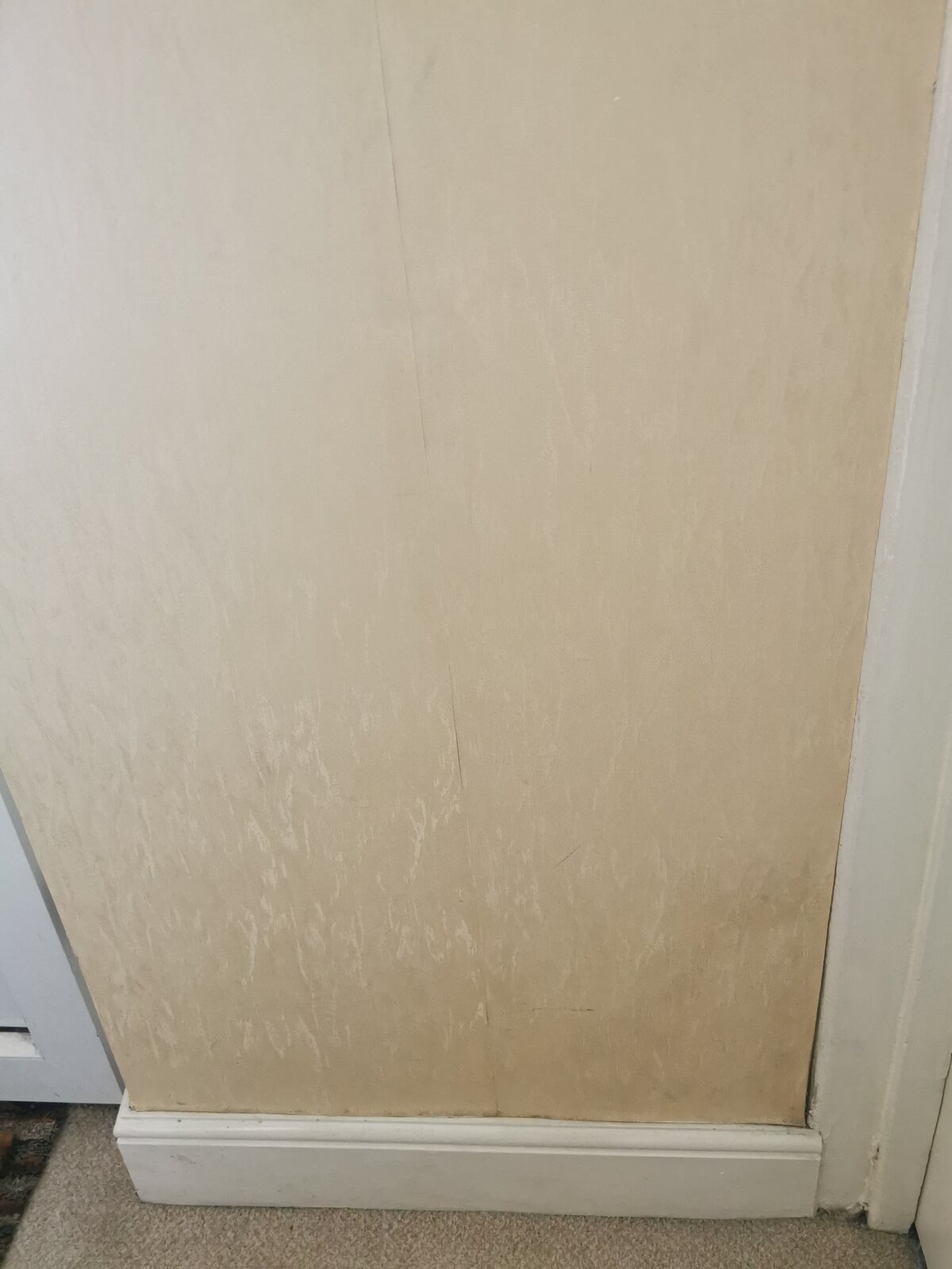

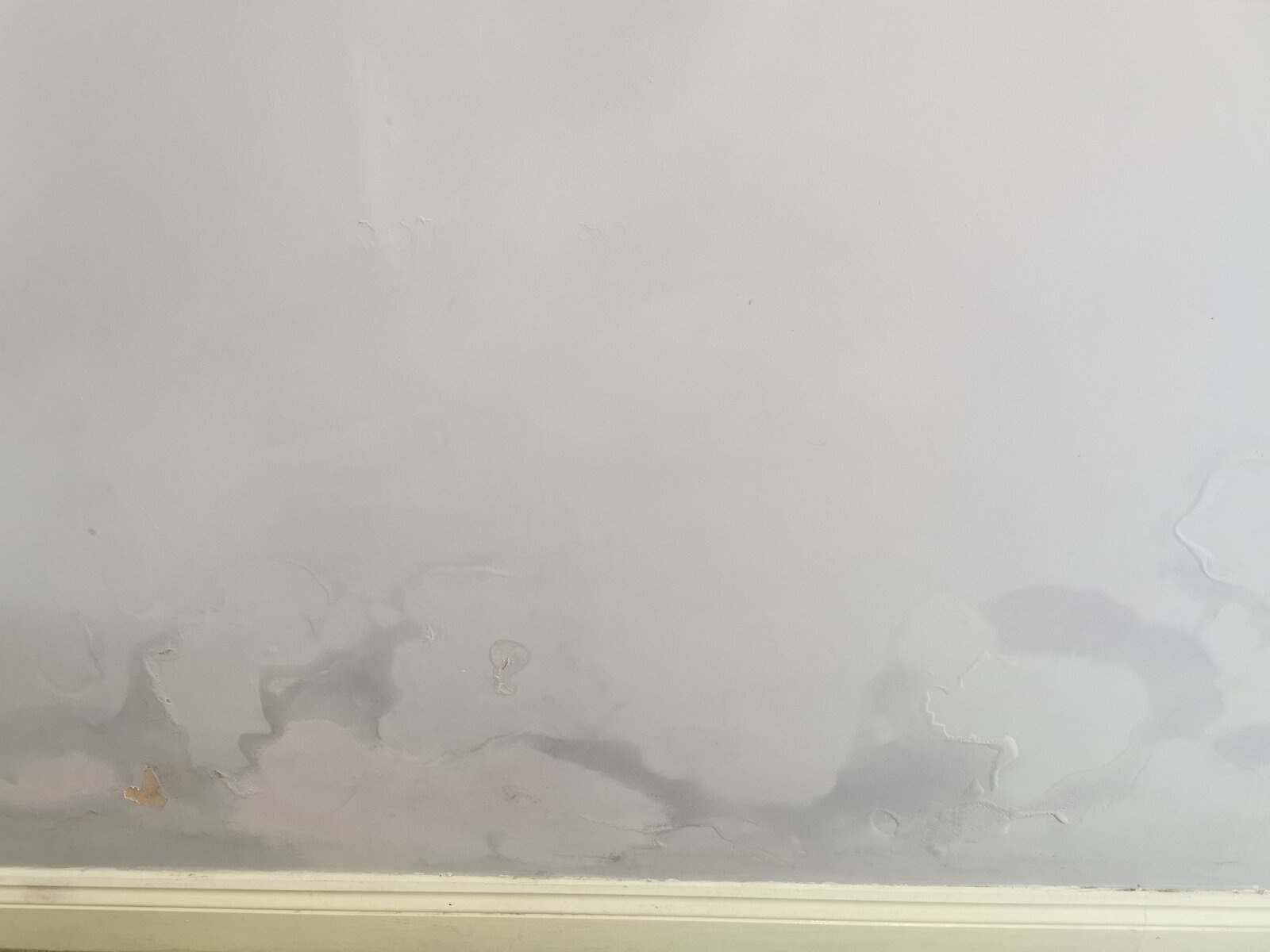

This is where the damp on the walls is. Below this line. And seems to be coming from the ground up.

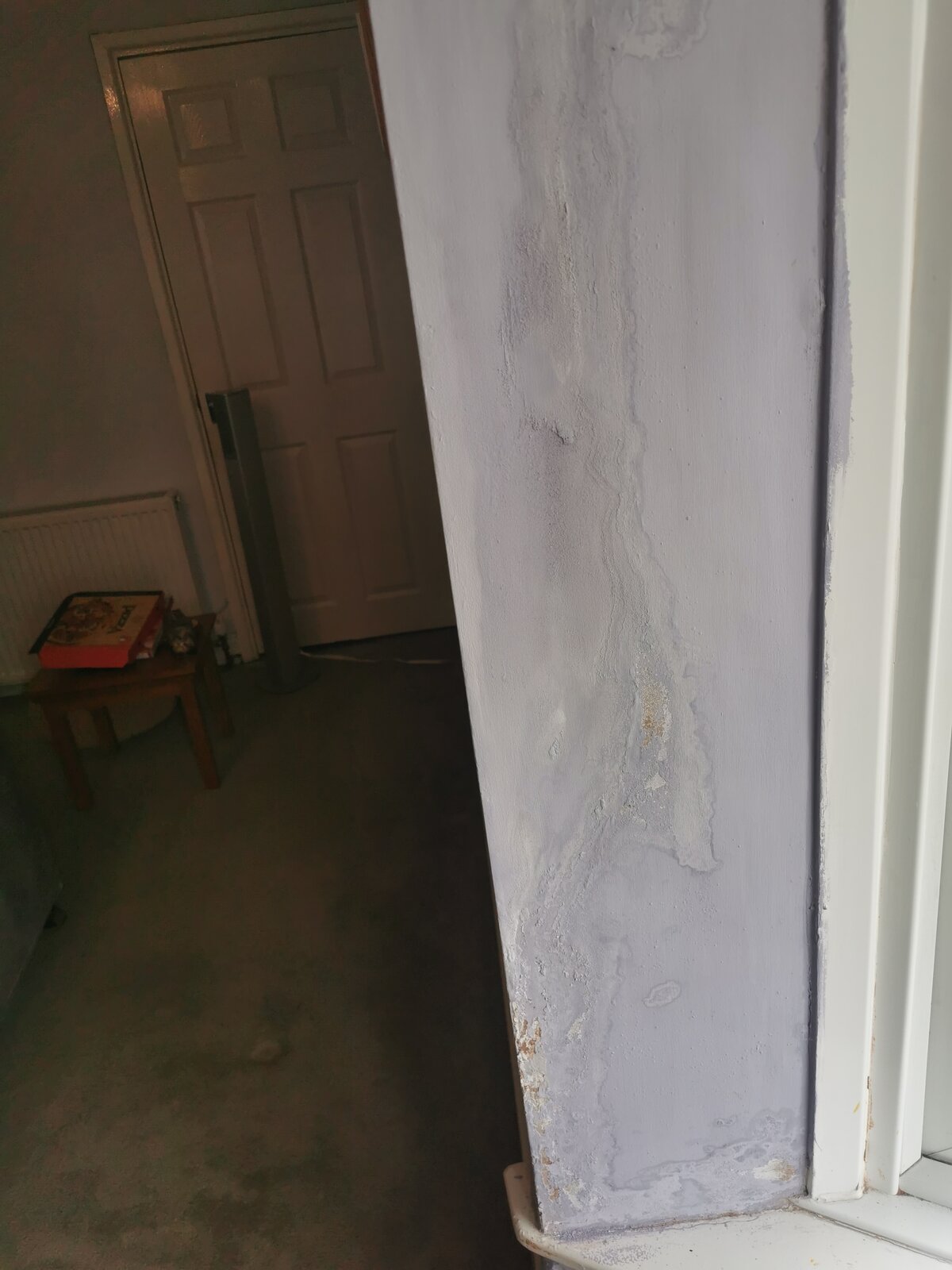

The corner bay window damp is the vertical rectangle here, and this part of the bay window.
I poured water from the bedroom window on to the bay ceiling, and it poured off the front two corners (as expected?).
The corner bay window damp is the vertical rectangle here, and this part of the bay window.View attachment 348195View attachment 348196View attachment 348197View attachment 348198
that is what I was thinking of. I don't believe that is "rising damp"
I believe it is rain penetration arising from the bay roof where it joins the wall. With a ladder, you should be able to see if there is a wet crack, and if lead flashing is turned up against the wall from the roof. Tar products and mortar fillets will have failed by now and may have been hidden by paint.
scrape away the mortar at the level just above and just below the airbrick. The original DPC is pretty sure to be in one of those places. It is not unusual for numbskulls to raise the level of ground or paving against walls so it bridges the DPC. If you have a large drill you can drill into the mortar just above the DPC and see if rainwater runs out.
Black paint at the foot of walls is usually done to hide (it does not cure) damp. By blocking evaporation, it forces damp inwards and upwards in the wall.
Presumably your house has cavity walls? If so they will be 11 to 13 inches thick. Are you able to lift a floorboard against one of those damp patches? Can you detect airflow through the airbricks?
Like John said , thru window frame then tracks across .Moisture falls thru wall when it reaches the ground it finds the easiest way out .
So, you both think that the whole issue of damp in the window bay (from window sill to the ceiling), and the damp all along the internal front wall to the front door could be from the window bay?
I was thinking it could be two separate issues.
