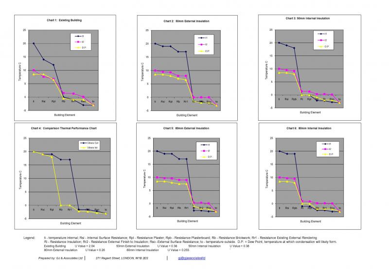

I'm hoping this works, if it does you will find attached the heat loss charts that I promised some time back - been a hectic period at work - I hope some find it of interest.

Well, while I'm here I may as well comment that heat loss is calculated in seconds (W/s) to obtain the heat loss for one hour it is necessary to multiply by 3600s/hr. MountainWalker - I would comment that your idea of heat loss is not correct, and there is a lot more to working out heat losses, and if your up for a bit of learning a good book to start with is 'environmental science - isbn 0582416205.
In the temperature range we are talking about C's are as good as K's (or maybe even better as there is less confusion).
Where the dew point line on the previously attached charts cuts into the room temperature lines this will indicate where condensation is most likely to occur through the building elements.
Otherwise happy interpretations on the charts!
