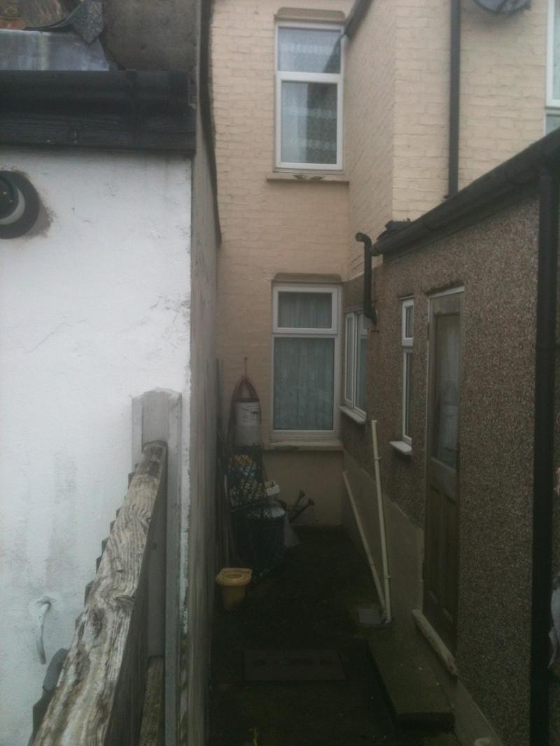

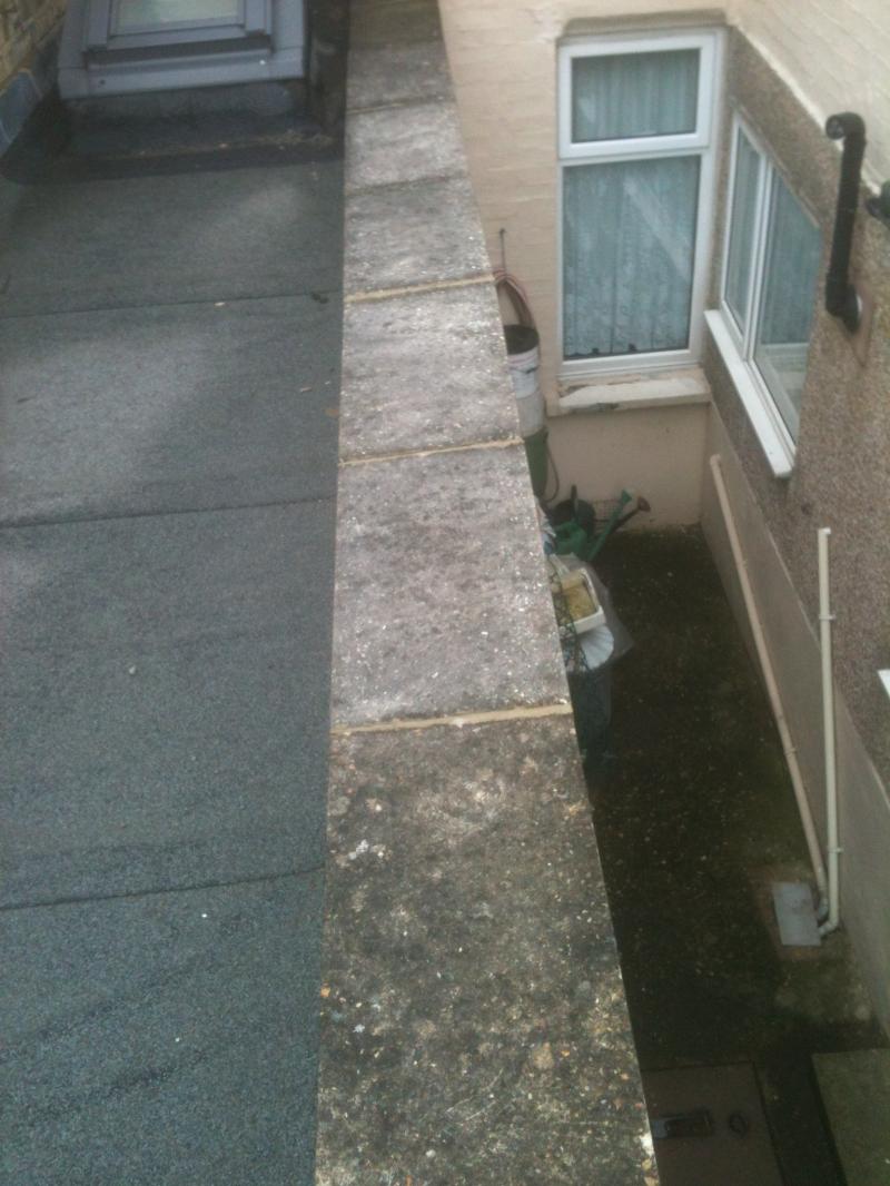

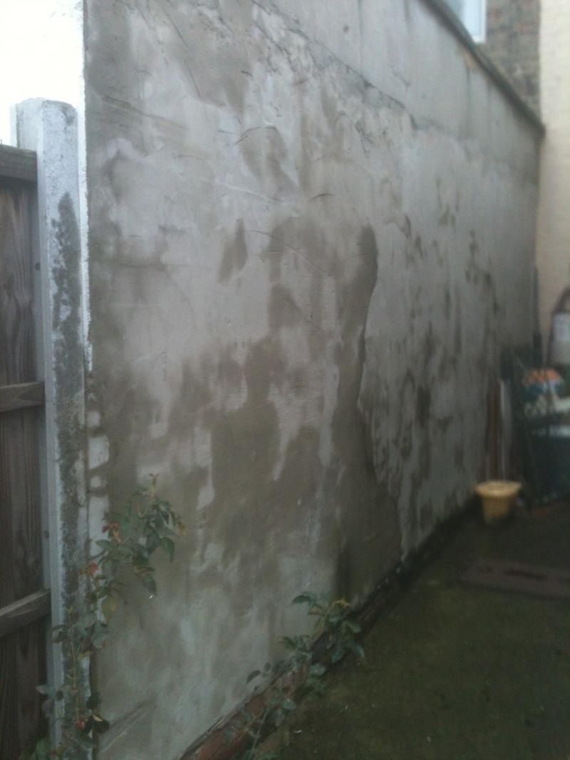

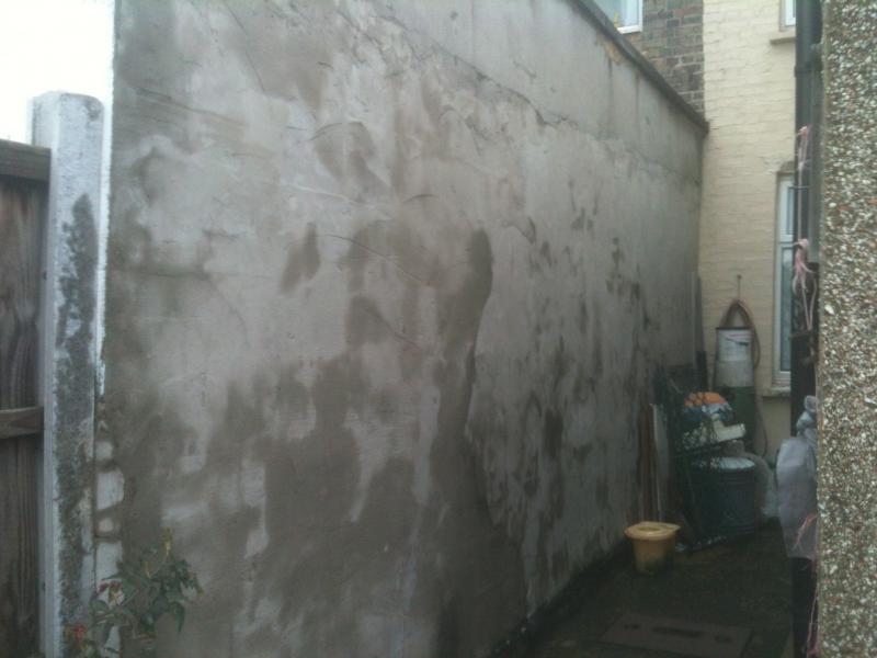

Many thanks for your replies ree. I have attached images below (the yellow house is my neighbour's property).
The coping stones have been repointed and the capillary channels on both sides have been restored. However, because the wall slopes inwards, rainwater drips from the coping stones onto the face of the wall. As you can see the damp areas are mainly at the foot of the wall.

The render has to come off back to exposed masonry. There are indications of three large render patches. The application and the render mix'es are not to even a reasonable level.
The coping stones appear to be minor contributors to the general dampness.
Plus, when the masonry is revealed the leaning will be exposed, and why its leaning possibly explained.
The concrete fence post has a damaged rendered corner just behind it -if the render corner bead is rusted, it too might have to come off.
Perhaps all the extension render could do with replacing?
On the same corner, the detailing of lead flashing (its going behind the fascia) and cap sheet and fascia is wrong - should there be a gutter on the fascia?
Why was a parapet built on a non-adjoining flat roof in the first place?
Why not post pics of all the extension elevations, the flat roof, and inside the extension where the wall leans?
