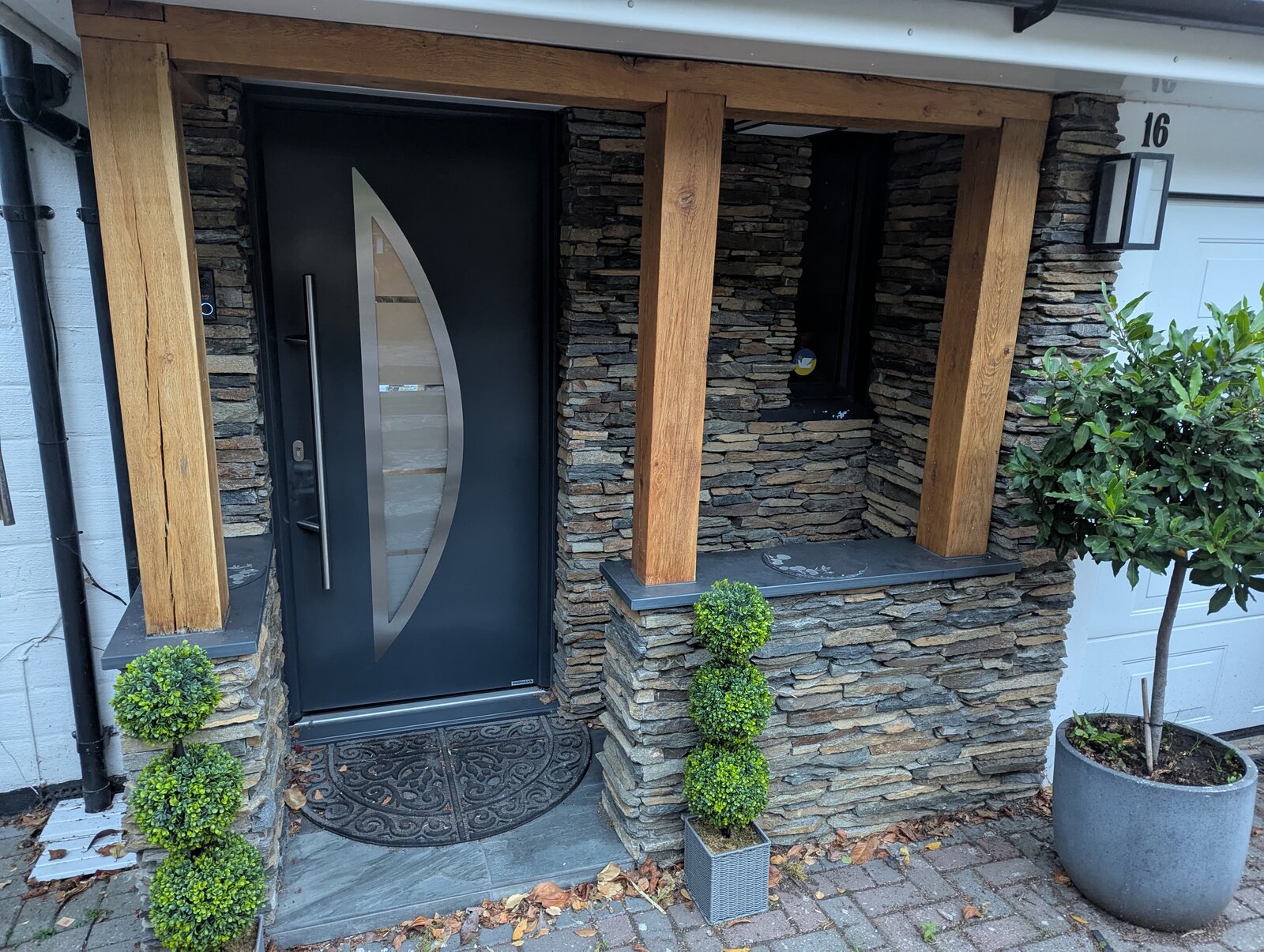

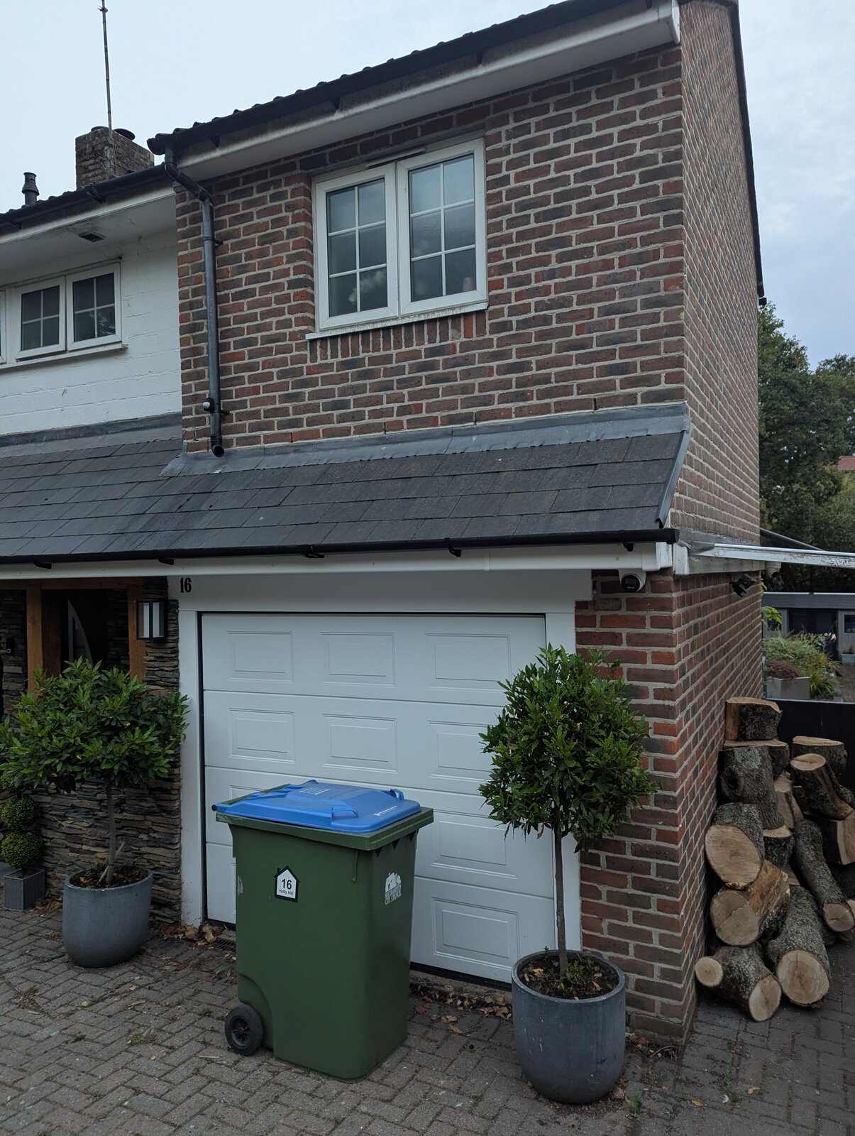

As mentioned, my plan was to CWI the gable ends and over the garage and then clad the brick with the slate that I'd used in my porch. Can I assume I'd definitely need planning for this?
My concern is that if the CWI does cause issues, there would be no way to rectify as id covered it with slate....
